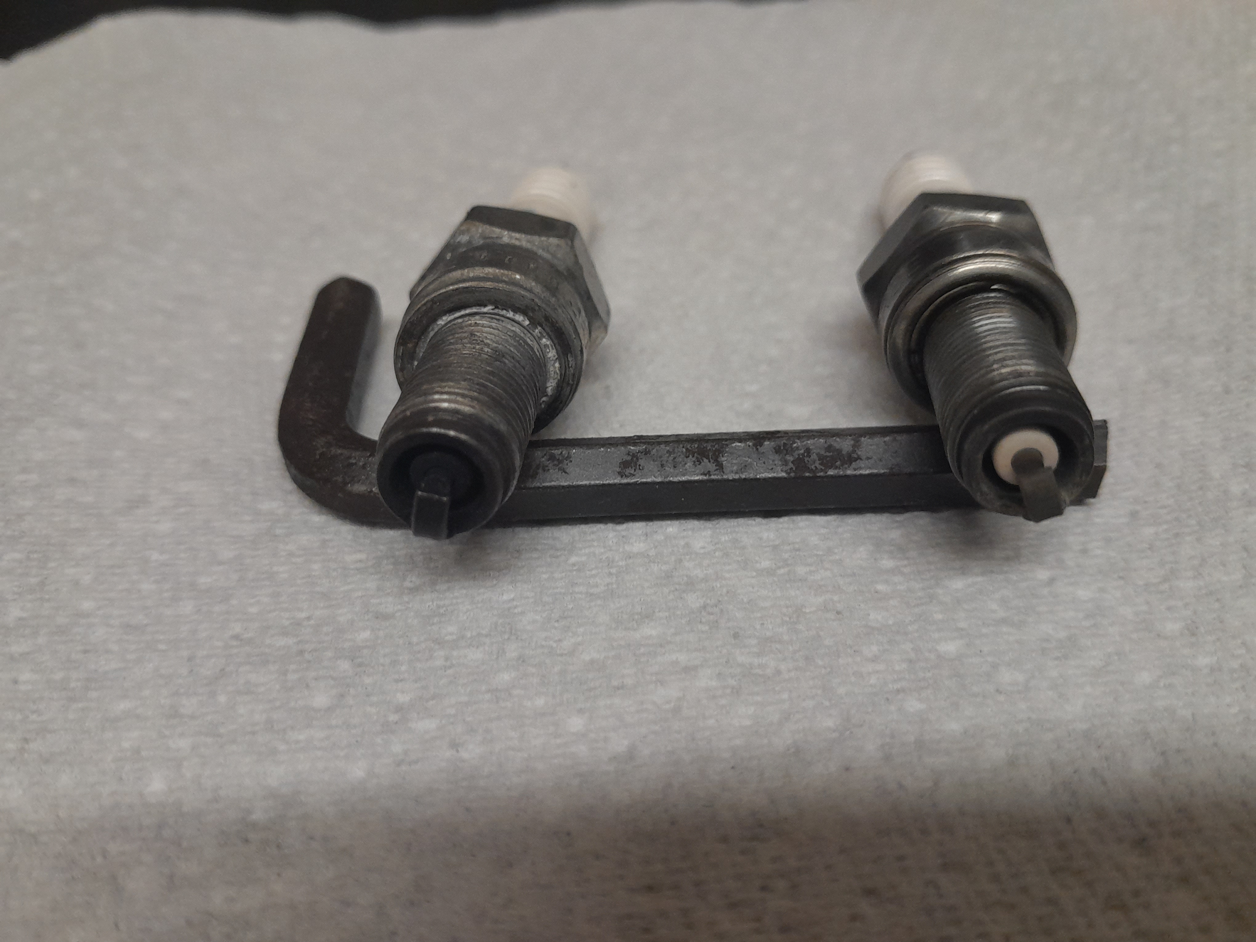

OK.... Ran up to Settle today, skimmed along at the 'Ahem', higher end of the speedometer scale, no dramas to report, harder work than loping along on a thou V twin, mind, but comes alive on the backroads. I show the two plugs below. One removed after yet another cold start fail. The other has just done 140 miles, pretty near flat out, then left ticking over for five minutes or more while security gates etc. were opened and the secured. I'll leave you to guess which bank of carbs produced which result.
BTW! These are EXACTLY THE SAME JETS. Just moved from one bank to the other.
I am, however, minded to try the 105 main jets that came with the BS32's, just to see......

So your original carbs run super-rich and your 550 ones slightly lean? It looks like you could go up a bit on the jets.
Re: Progress update....or not.....
My thoughts too on the jets. Have you looked at your plugs when trying to start? Just want to know if my original carb bank is somehow damaged or this is what they all do. Judging by the reluctance to start that seems endemic, I'm guessing that your plugs will look the same as the mugshot on the left.

TBH John, I don't take the plugs out unless I have to, as it's a total pain in the arse to get to the middle ones. Next time it is playing up, I will take the outer ones out and check. This will probably happen soon as I am back on the E5 as I have run out of Ethanol-free.

When you say you have difficulty starting, could you explain the symptoms and the process for actually getting it going.

Full story on my '400 starting issues' thread. Or are you having a joke at my expense?
Symptoms - After standing for a while the f**ker refuses to start, eventually flattening the battery. Surefire 'cure' - drain carbs (and fuel tank if fuel old), fill with fresh fuel.
Prevention - ethanol-free fuel (or carb swap!)
