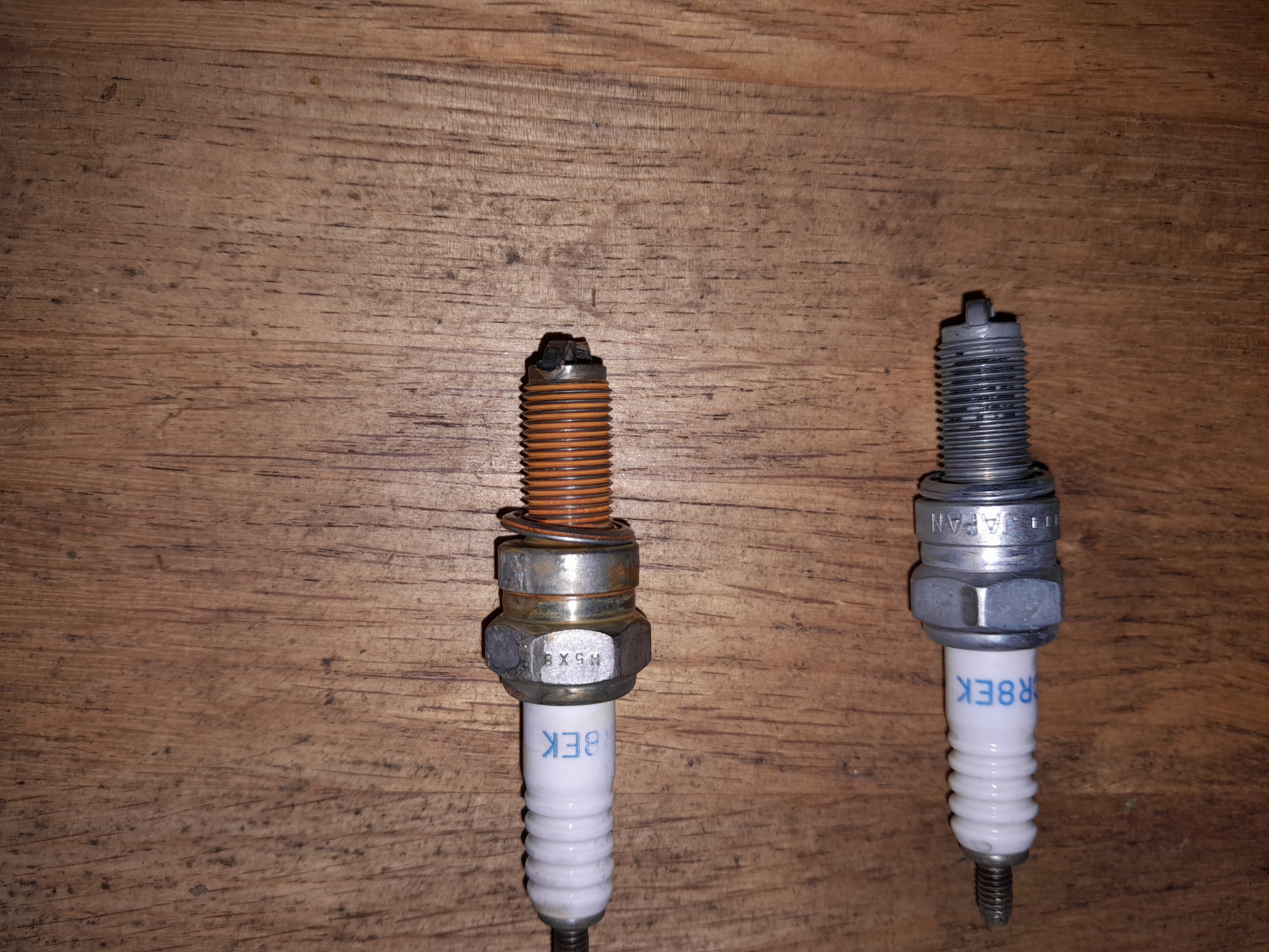

Now, a serious heads up. I have a bag of spark plugs, mostly from Bandits, GSX1400's I've worked on. But to eliminate any problems, I bought a new set through Ebay. Thought no more about fitting them. Running her up, I could hear a miss / hesitation at tickover. It revved, but not sweatly, if you know what I mean. Given that I had a bit of a struggle getting it going again, I presumed a fouled plug.
Replacing the colder exhaust pipe cylinder plug with one from my bag, back to normal service. Taking a closer look at the plug, the NGK logo and type numbers / letters were a faded blue, unlike the gen NGK's where the logo is a bright blue. Those plugs are now in my gallery of shame.... Watch out for counterfiets, these bikes need all the ignition help they can get!

I often wondered how people could ebay NGK plugs including post for about 50p more than I could buy them at trade! Fake explains it.johnD wrote: ↑Sat Mar 04, 2023 1:45 pmNow, a serious heads up. I have a bag of spark plugs, mostly from Bandits, GSX1400's I've worked on. But to eliminate any problems, I bought a new set through Ebay. Thought no more about fitting them. Running her up, I could hear a miss / hesitation at tickover. It revved, but not sweatly, if you know what I mean. Given that I had a bit of a struggle getting it going again, I presumed a fouled plug.

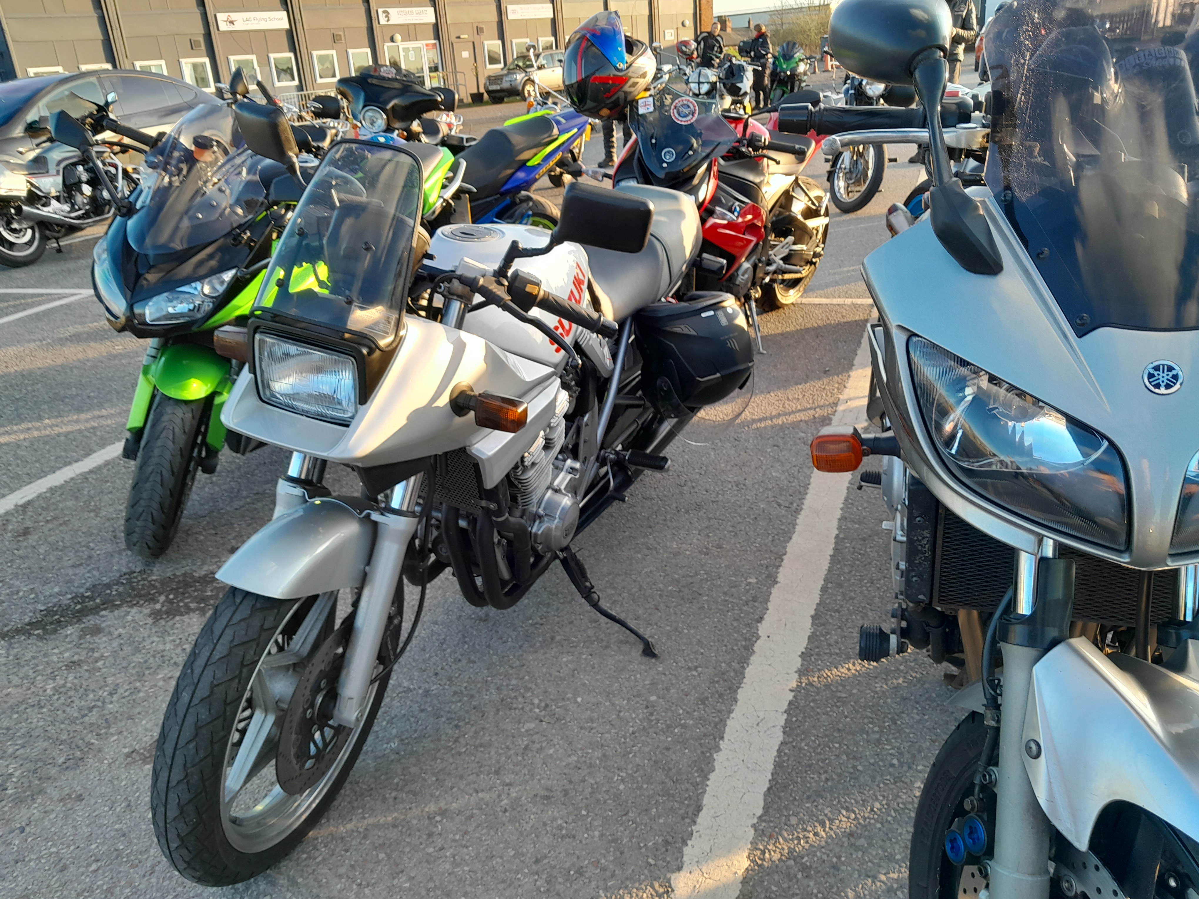

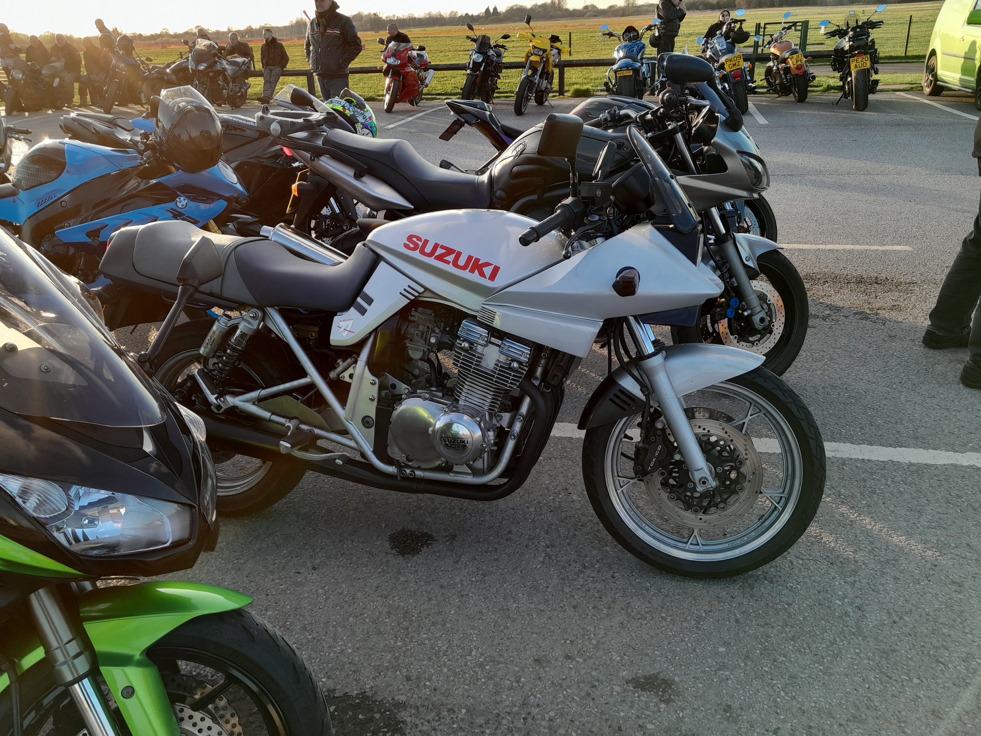

Veterans garage Barton airstrip I see. You know what this was a conversion I thought about, but never got round to and proves the fickle nature of the originals probably .

Yes fossie, meant to give them a mention, good little night out, Mondays from 6 00pm for anyone in the north lancs area.

I only live down the road from Barton airport and every Monday evening after the clock spring forward the Cadishead by pass sounds like the Mulsanne straight!
I ride past ( normally) about 2030 on my way home .
