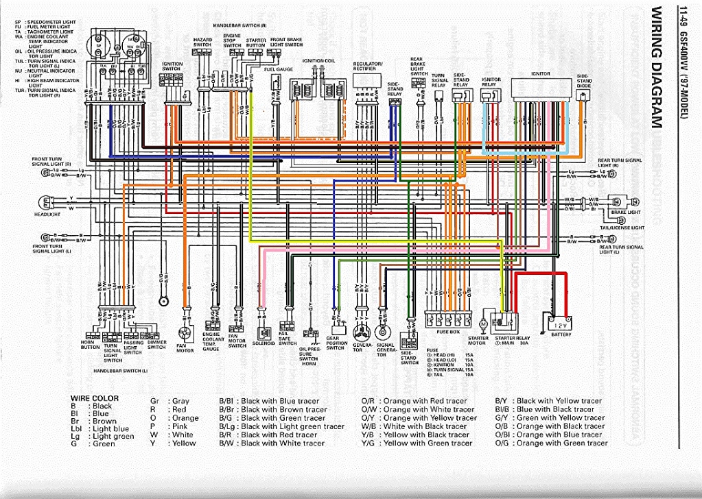

Tinykat has a wiring problem. I have tried to open the forum workshop manual, but the damn computer says there is a problem. Can anyone with some tech knowledge help me get a wiring diagram?

Here is the source TIF files I used:
10-07.tif
(124.89 KiB) Downloaded 291 times
10-08.tif
(63.43 KiB) Downloaded 252 times
10-09.tif
(35.43 KiB) Downloaded 243 times
Here is a GSF400 Bandit wiring diagram as well as similar and can help in working out what bits are what on the Japanese 250 one!
Hope that helps - I have just got a X7 so might be contacting you for advice at some point (and even parts!)
