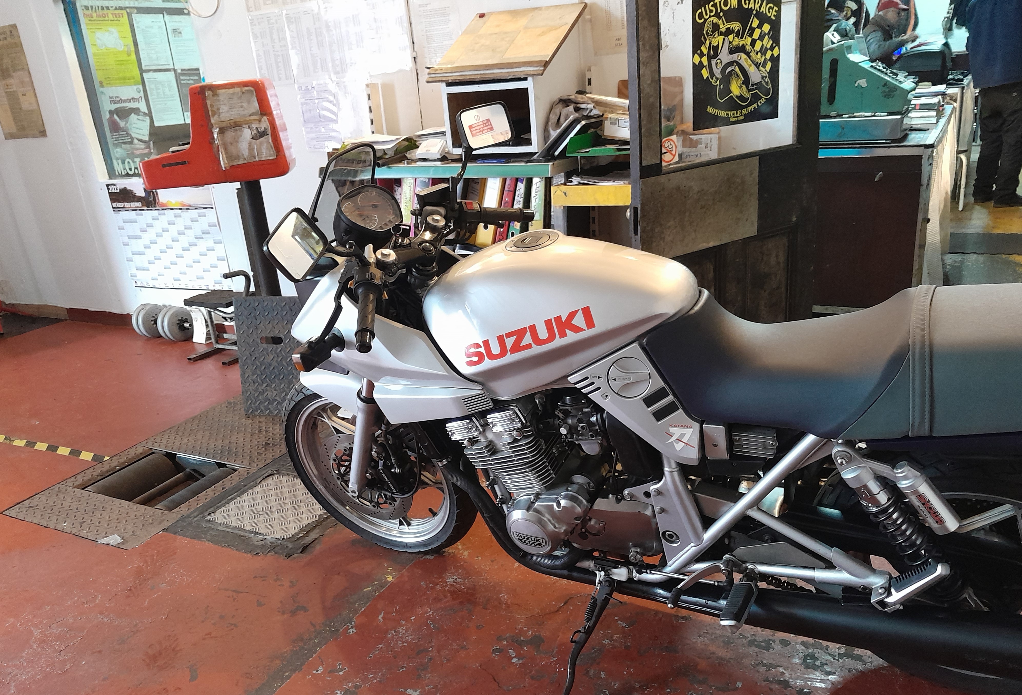

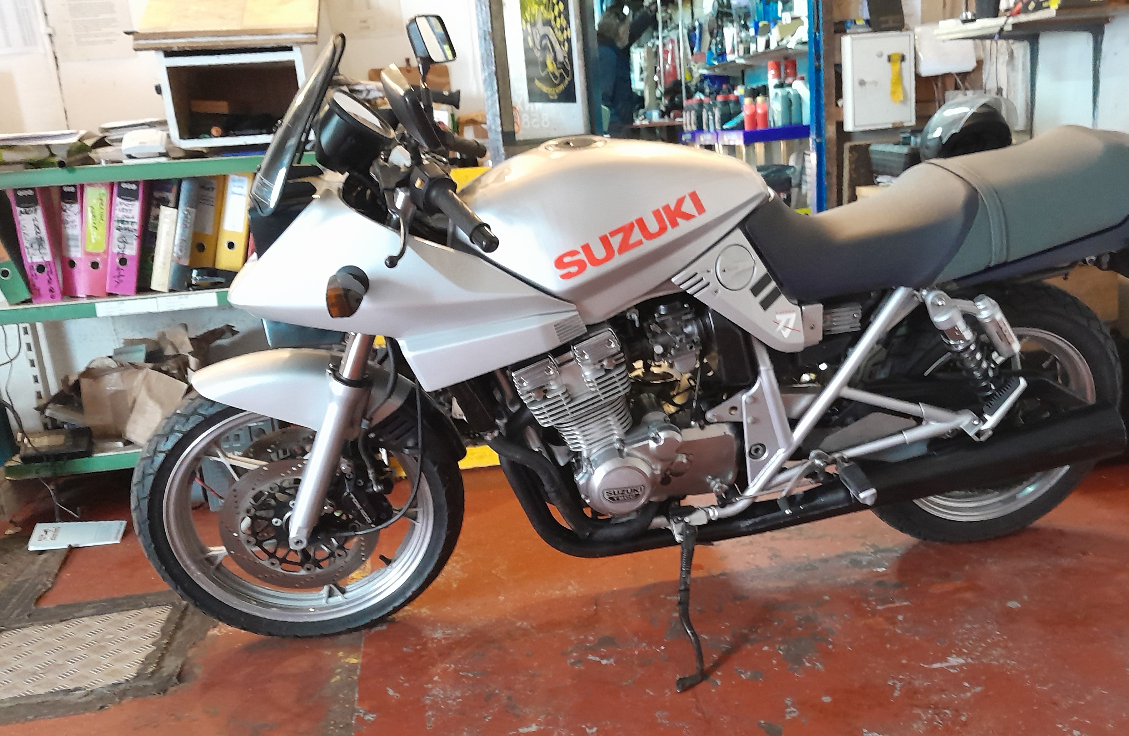

Well, today dawned drizzly and dank, just the job for its first run out since 2010.
Up to the MOT place, runs very smoothly, all seems to be well. Arrived to much 'ooohing' and 'ahhing' from the mechanics, even taciturn Rob was heard to admit it's a nice looking bike. (Bikers Wharehouse, Farnworth. Old school, keep them supported while we still have places like this).
First impressions are that this is a very interesting alternative the overweight,overpriced, tech laden modern midweights. Good brakes, handles well, loving actually having a steering lock compared to the Falco.
But, there's always a but. Big flat spot at circa 5000 RPM, time for some intensive carb tuning now she's fully legal.
One thing I have noted is that, even after a good run, the exhaust drians are still dripping water. NOT coolant, just the murky condensate from combustion. I have noted this when running it up in the garage, but after ten miles the exhaust system should be hot enough to boil this off. With a mild steel, unobtainium silencer system, this does not bode well for longevity. It was very humid today so that will not have helped... But......
Anyway, most hurdles hurdled, all electrics are now present and correct, bit of tuning, (famous last words) and we should be ready for summer...
Cheers.
