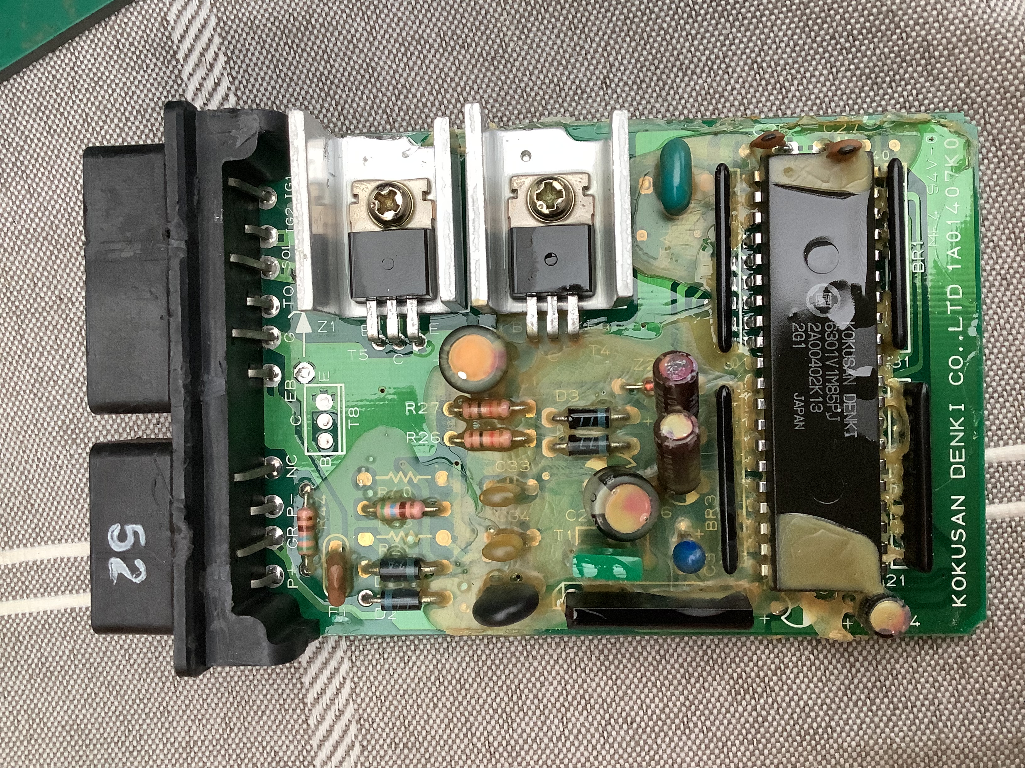

Hi, this picture is one I have put in my 400 and it runs with it, not been able to give full test as bike is still having other jobs done and not on the road yet.
Other picture of old unit, had to break case to get in.
Tony

Handy to know you had to break the case - I was coming to that conclusion myself with SmallKats one, but struggling not to. Keep the old one, it should just be a case of replacing the 5 electrolytic capacitors - just need the values off the side (voltage and microfarad ( µF ) rating). They dry out with age hence why it probably goes wrong. Should be fairly easy once you get into it! As the caps are cheapish I might buy a few sets so (if it does work) can replace others if they send this way.
Possibly the transisitors can be replaced as well - I saw another post saying something like this should do...
https://uk.farnell.com/multicomp/tip150 ... dp/1440104
