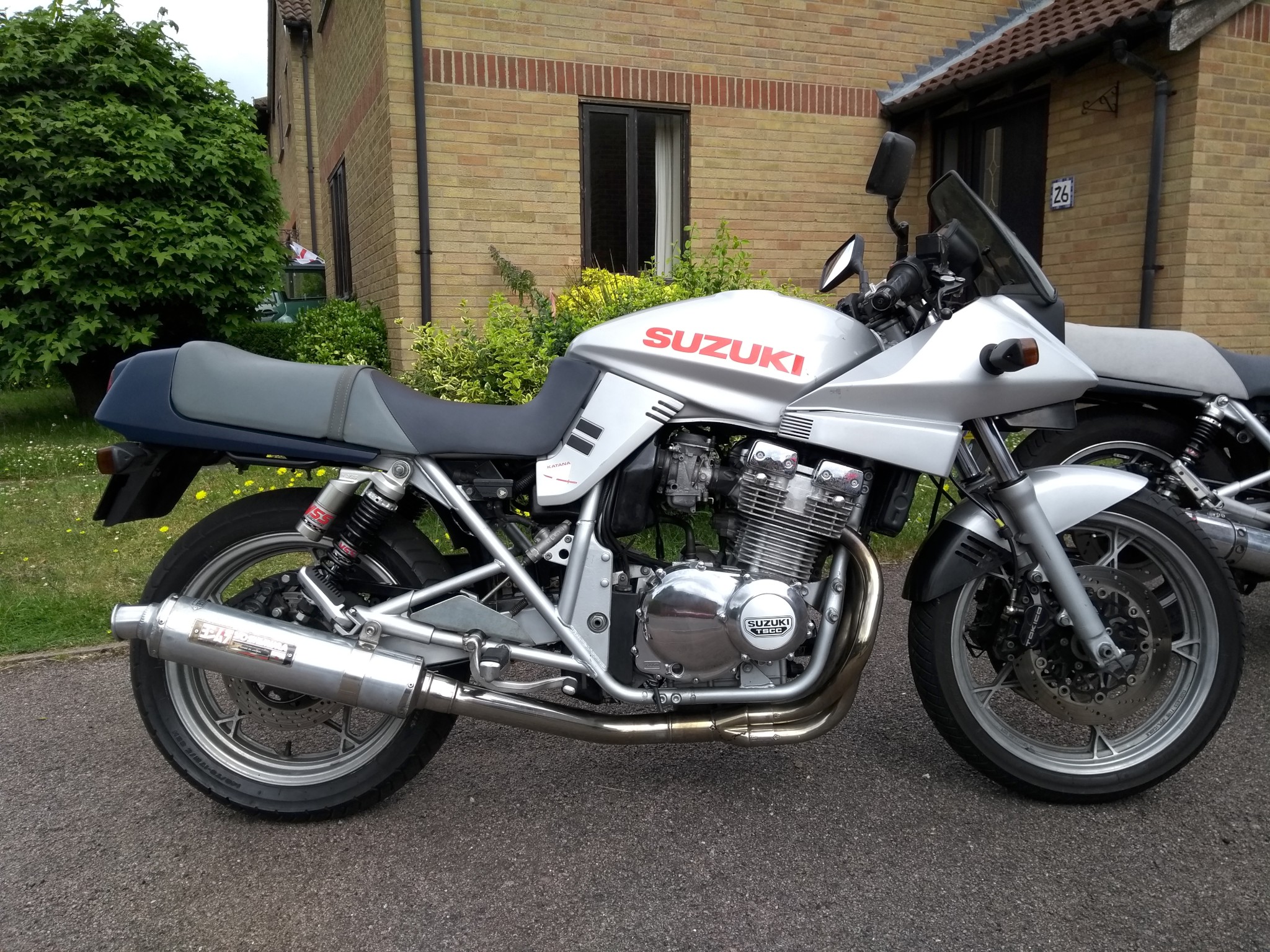

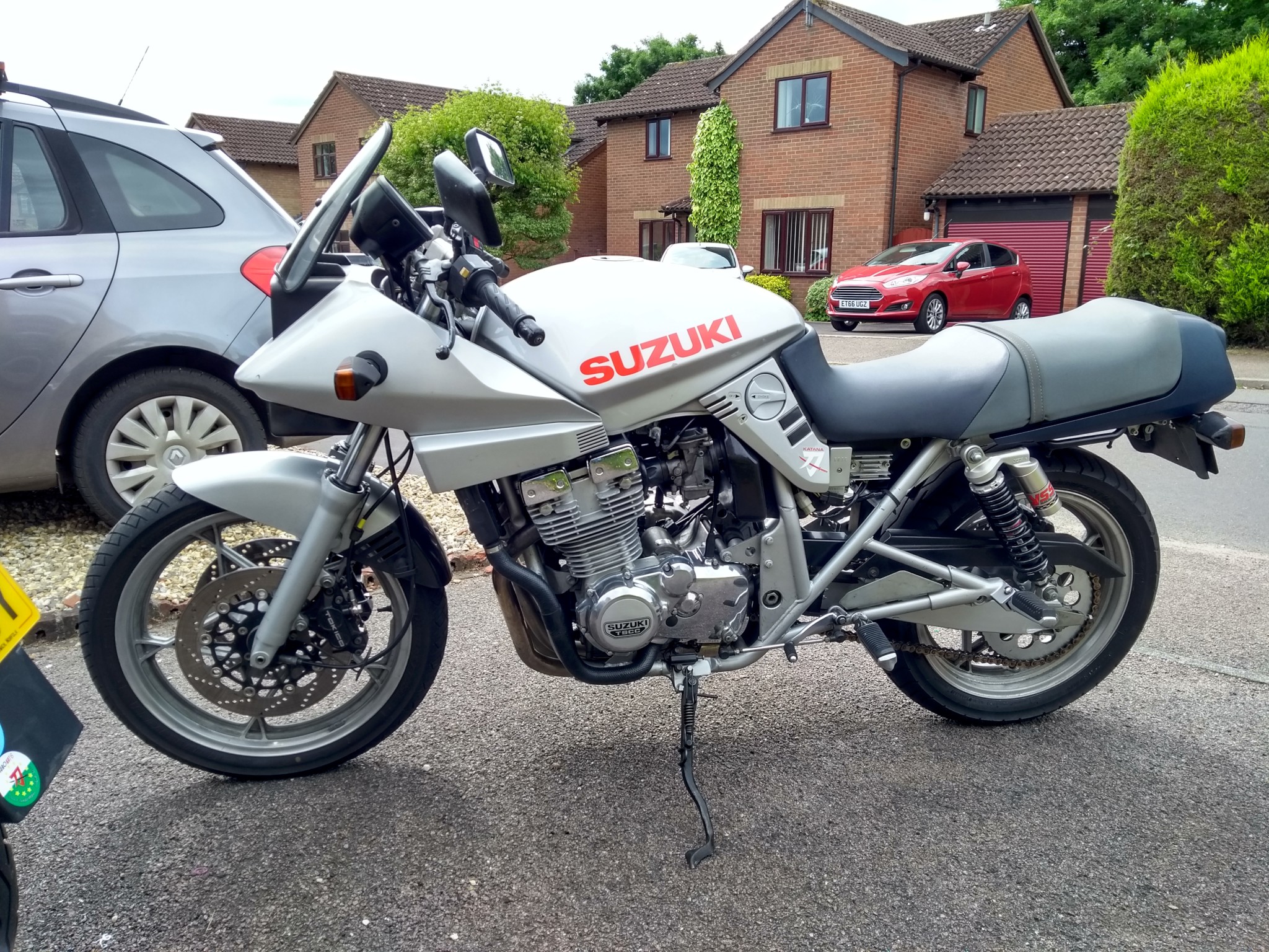

Have you been looking at the piggyback YSS when you say they don't look the part? See images of them on my bike below. The YSS are Preload, Compression and rebound adjustable plus also have a small amount of height adjustment if required (360-370mm). and I think look pretty damn good! I think YSS was setup from ex-employees of White Power. They aren't cheap (but not Ohlins expensive) and mine cost £480 about 3 years ago (the bike only cost me £700!)
