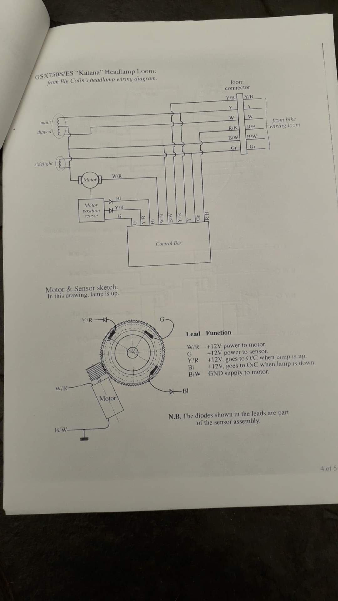

A few years ago I got an electrical type chappy to take the control unit apart to suss out how it works.
The following is his précis .

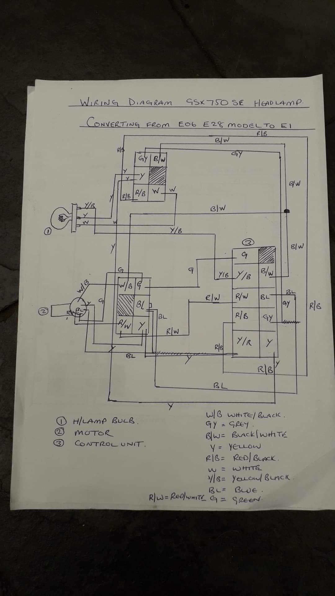

Also included in a wiring diagram of the loom to control unit and how to convert the uncommon market version into the usual market version.
Pop up headlamp explained .
