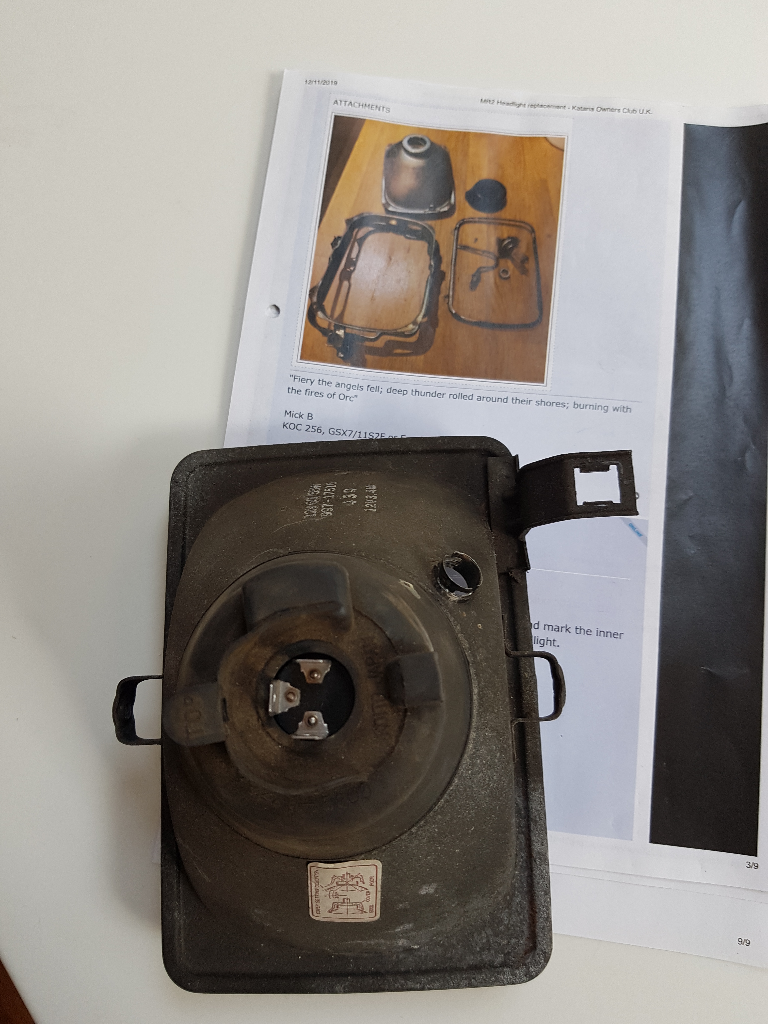

I was hoping to do the MR2 headlight replacement, as outlined in this thread by Blix viewtopic.php?f=45&t=8149 but my current headlight is nothing like the one pictured in the thread. Does the swap only work on fixed-headlight Kats, and not on pop-ups? Cheers!

Yes. As far as I am aware the MR2 headlight conversion works on the SZ & SD Kats.
The SE has a different headlamp unit. Think it is slightly smaller. Not yet seen anything that will fit.

Damn - in which case, does anyone with an SZ or SD want to buy the Crystal MR2 headlight, used in the upgrade thread? I have two that I don't need!

I would have done but just got one off Blix last week. Stick it in the For Sale section - it's a useful part to have even if you don't want to do the mod quite yet.
