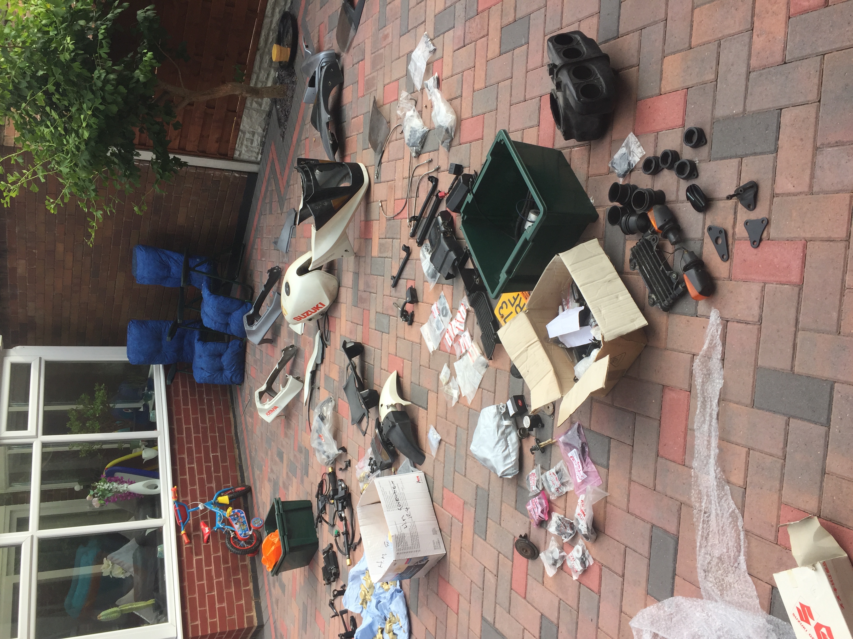

Owned for 2 years and the rebuild now begins.

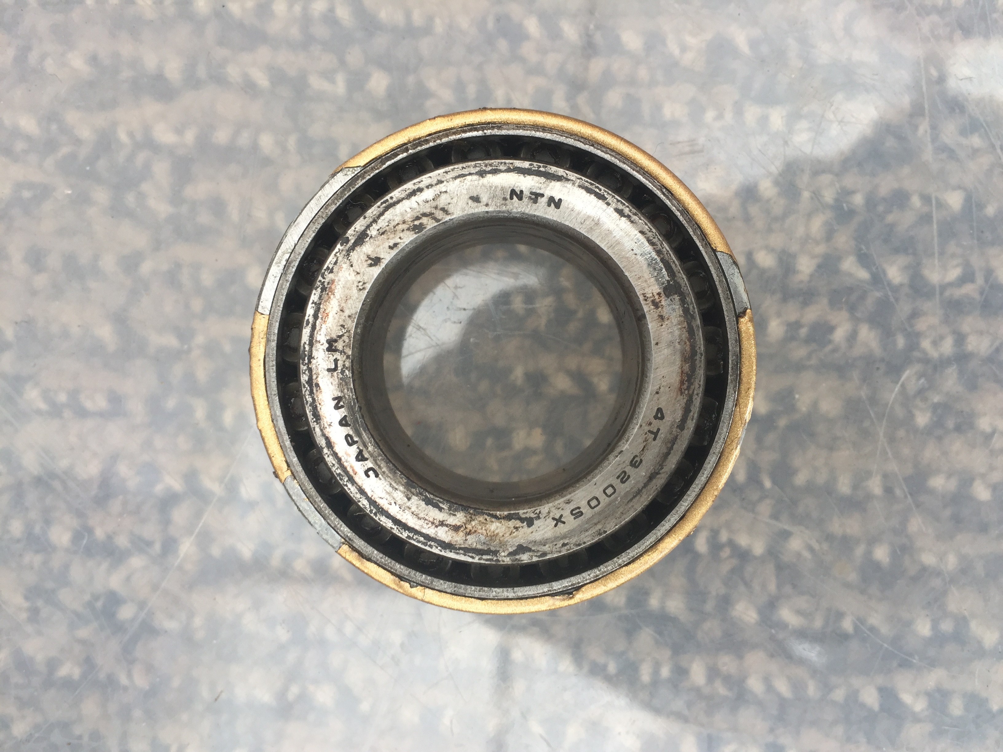

Re: Bits n pieces are a forming
Posted: Sun Sep 23, 2018 6:33 pm
by Berti44
New stem taper roller bearings fitted.

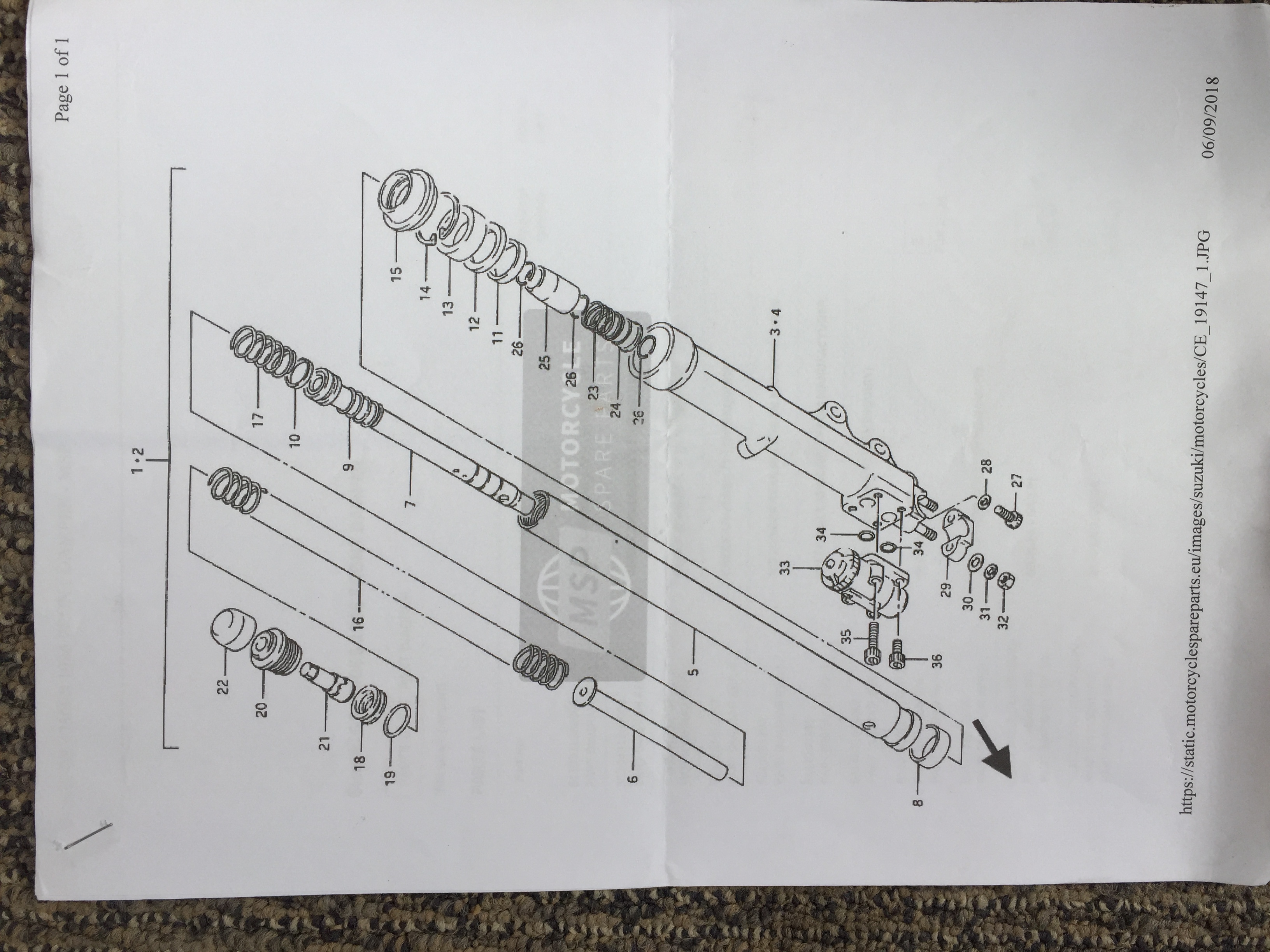

Posted: Sun Sep 23, 2018 6:39 pm
by Berti44

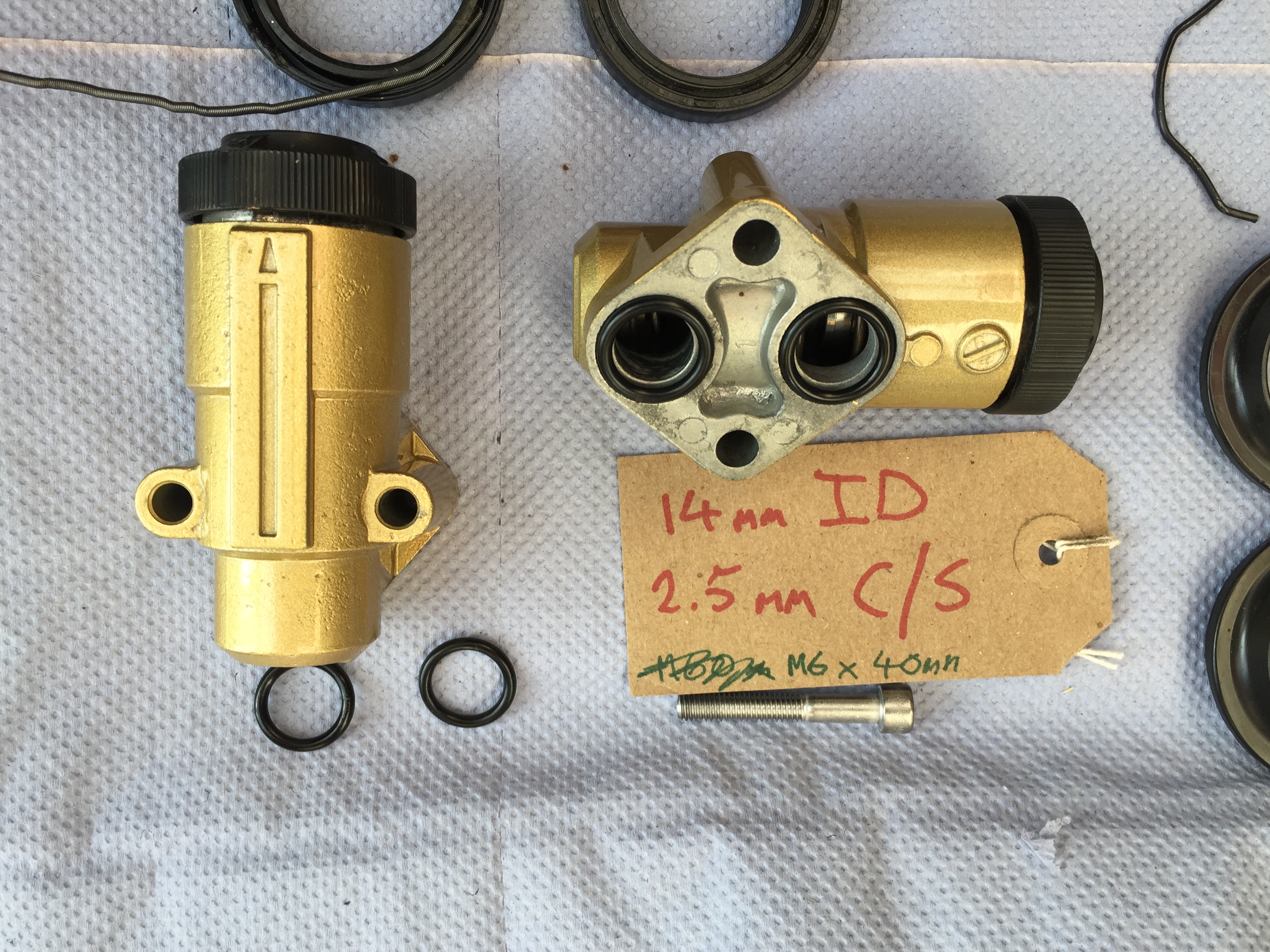

Now to rebuild forks. I’ll

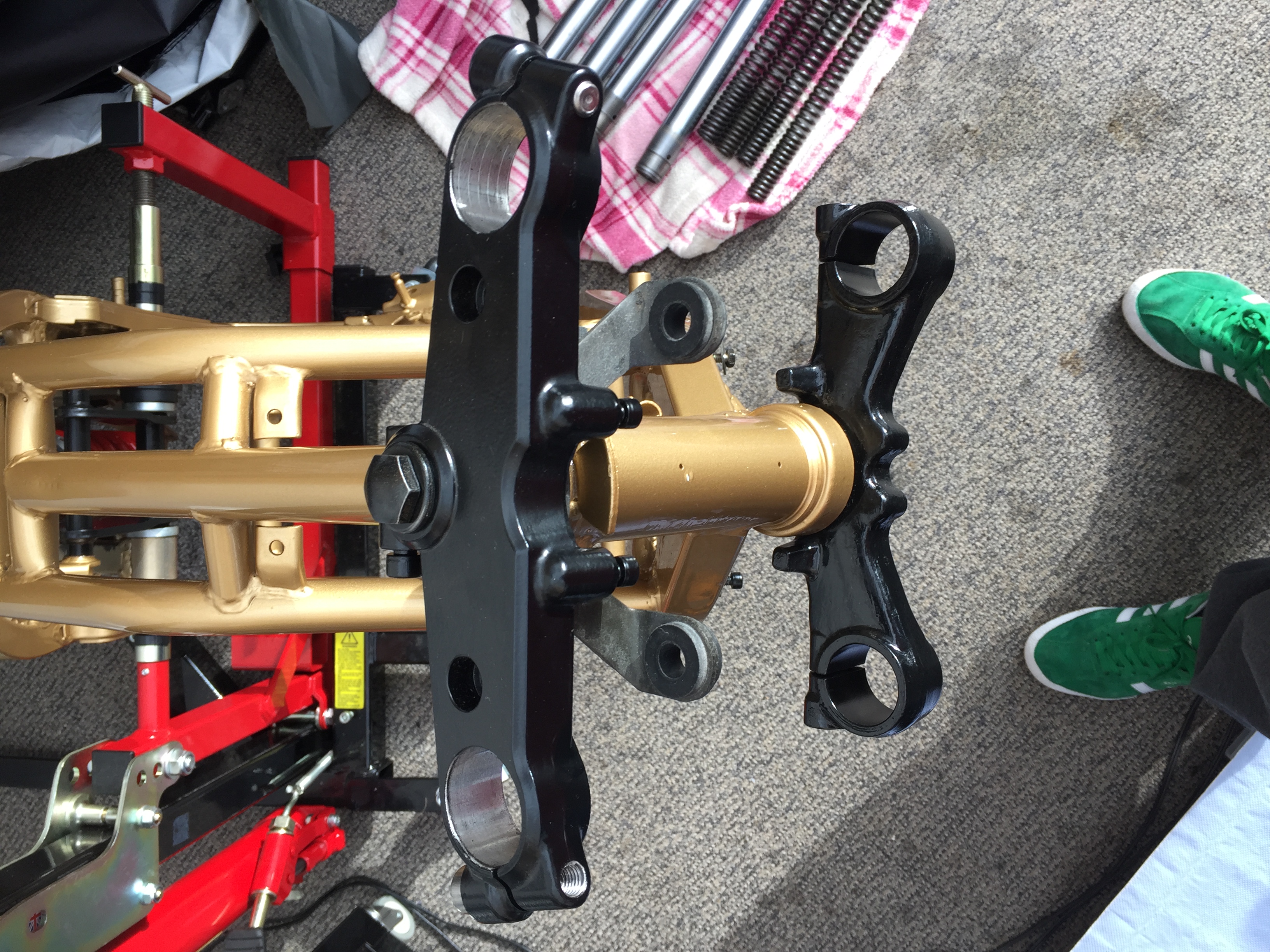

Posted: Fri Sep 28, 2018 3:42 pm
by Kryten
Nice one.
Don't forget to fit the airbox before the engine....
Posted: Fri May 15, 2020 4:02 pm
by Berti44
Thanks Kryten for the tip about the airbox invaluable

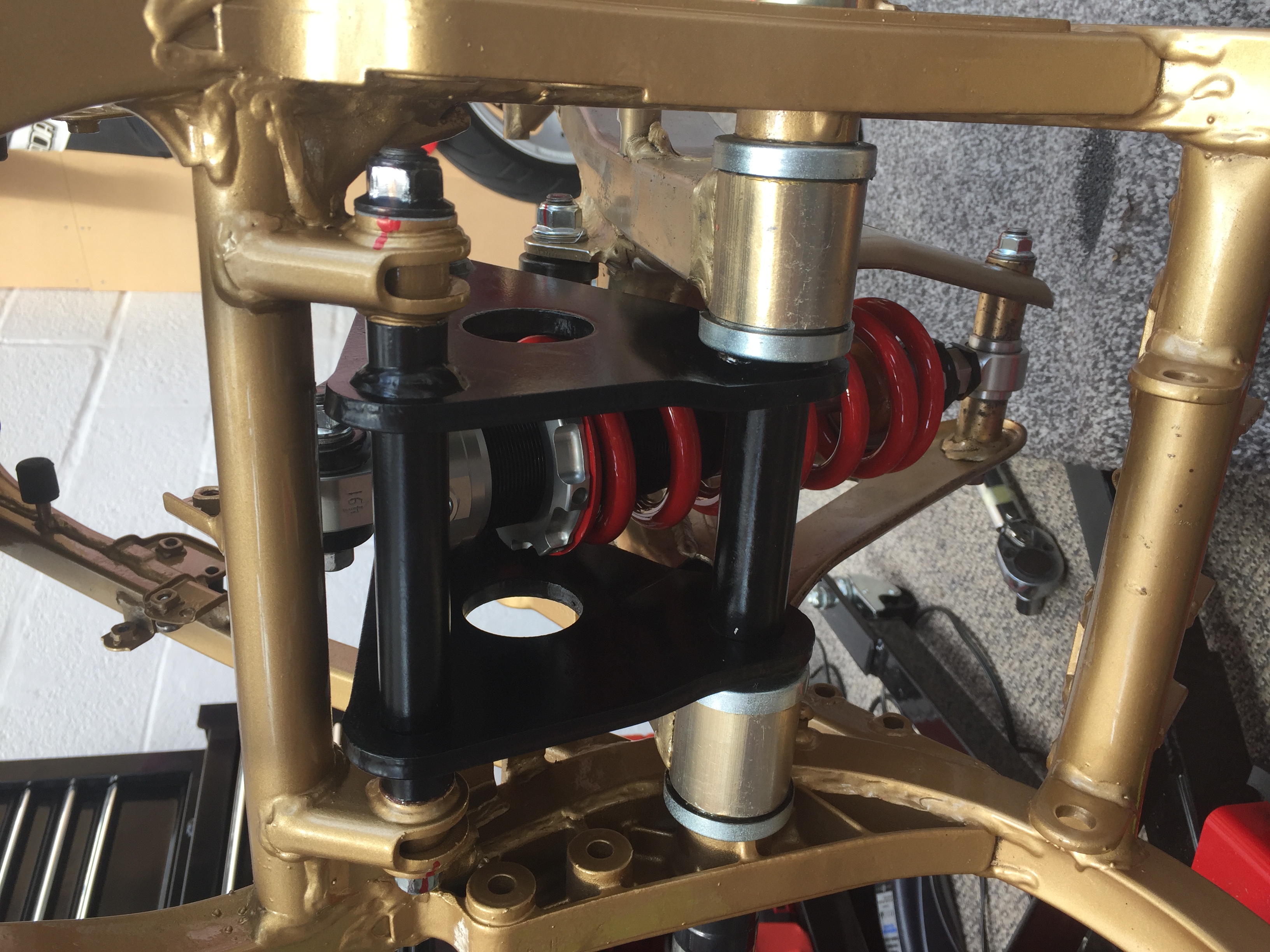

My tip to other folk is to make sure you put the rear brake shaft in/on before fitting the swing arm. Yep my bad

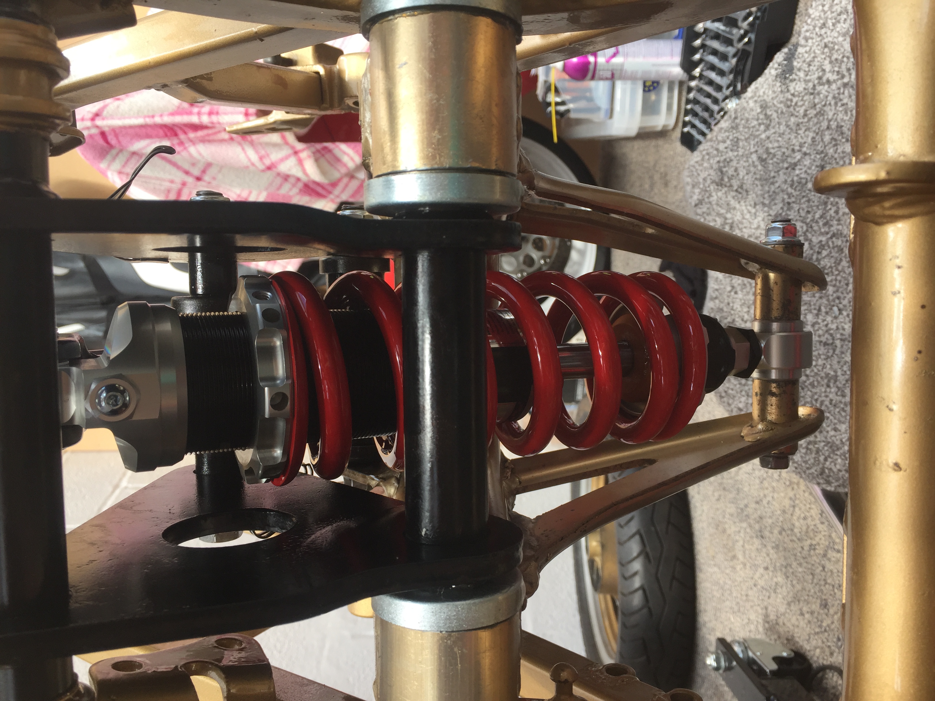

Posted: Fri May 15, 2020 4:09 pm
by Berti44
Lockdown progress is steady: this photo was taken before I had to remove the swing arm again.
