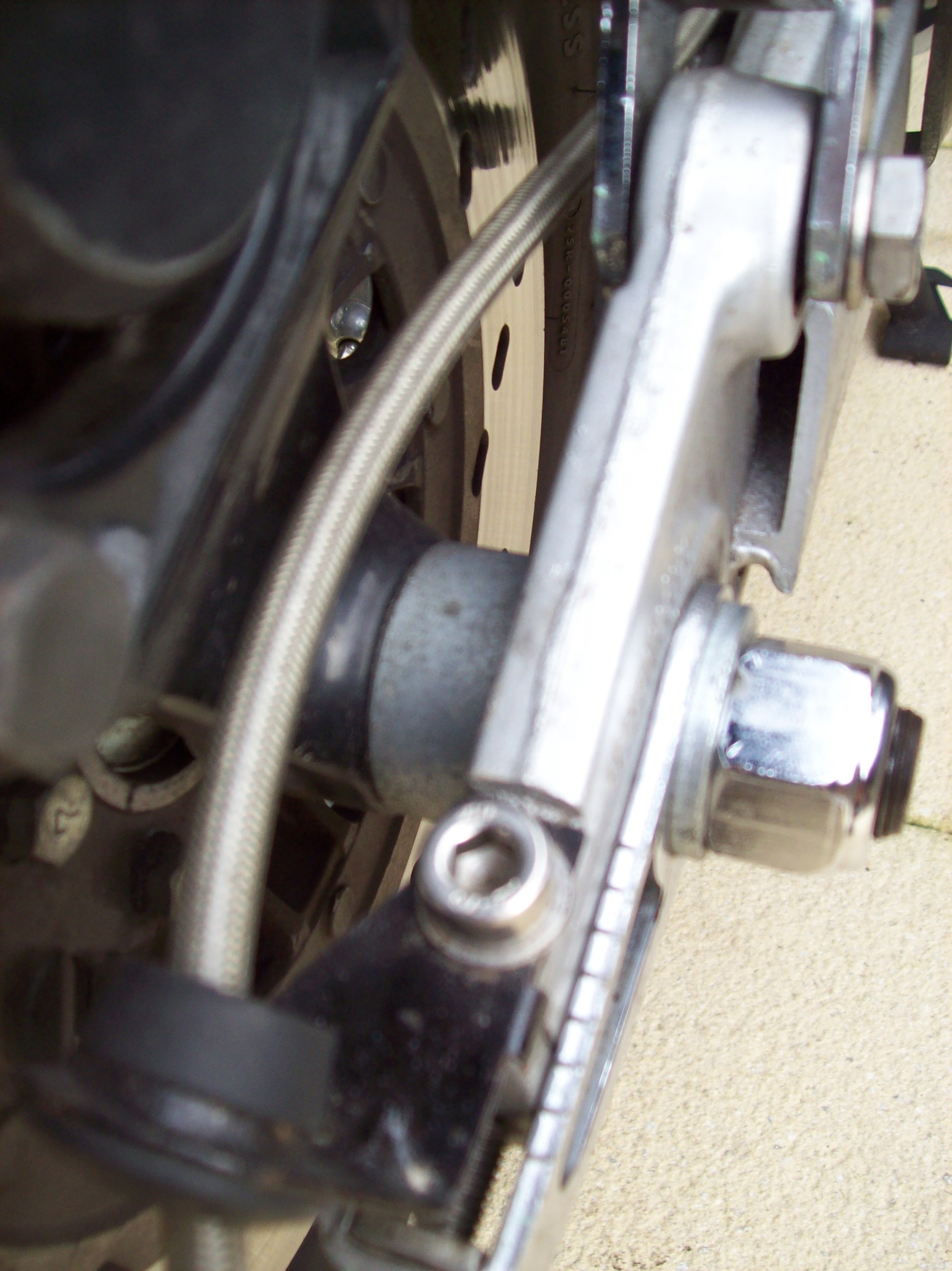

Post by Kryten » Tue Oct 31, 2017 6:37 pm
OK. So it's a 750 and the wheel's a spokey dokey. But it is pretty much what you will have for the 550
Right hand side: Nut-Washer-Chain Adjuster-Swinging arm-Spacer-Caliper Support
Second picture shows "Top Hat" or flanged spacer between Caliper support and hub

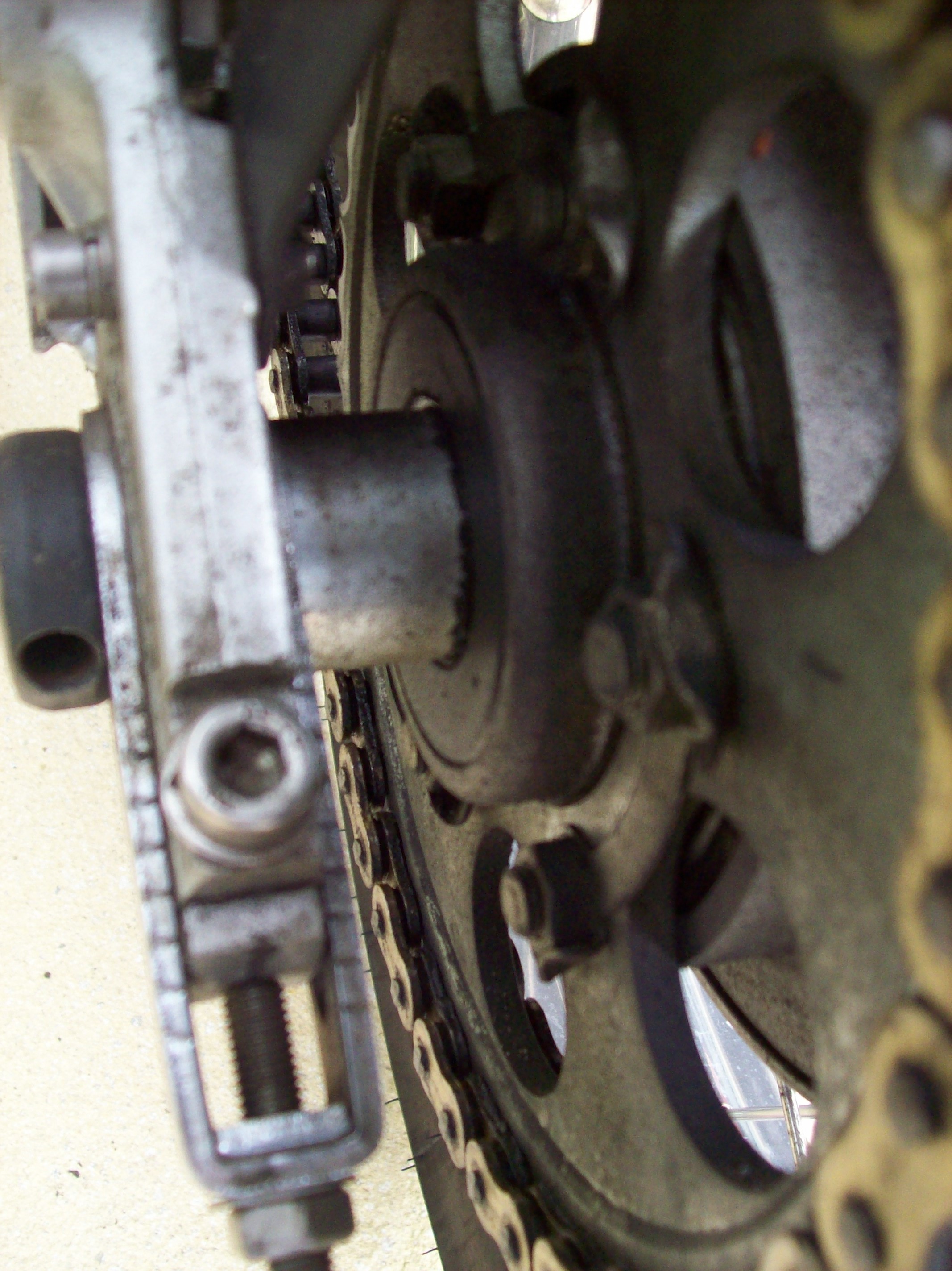

Post by Kryten » Tue Oct 31, 2017 6:40 pm
Left Hand Side shows: Spindle Head-Chain Adjuster- Spacer(into Oil Seal)-Sprocket Carrier
