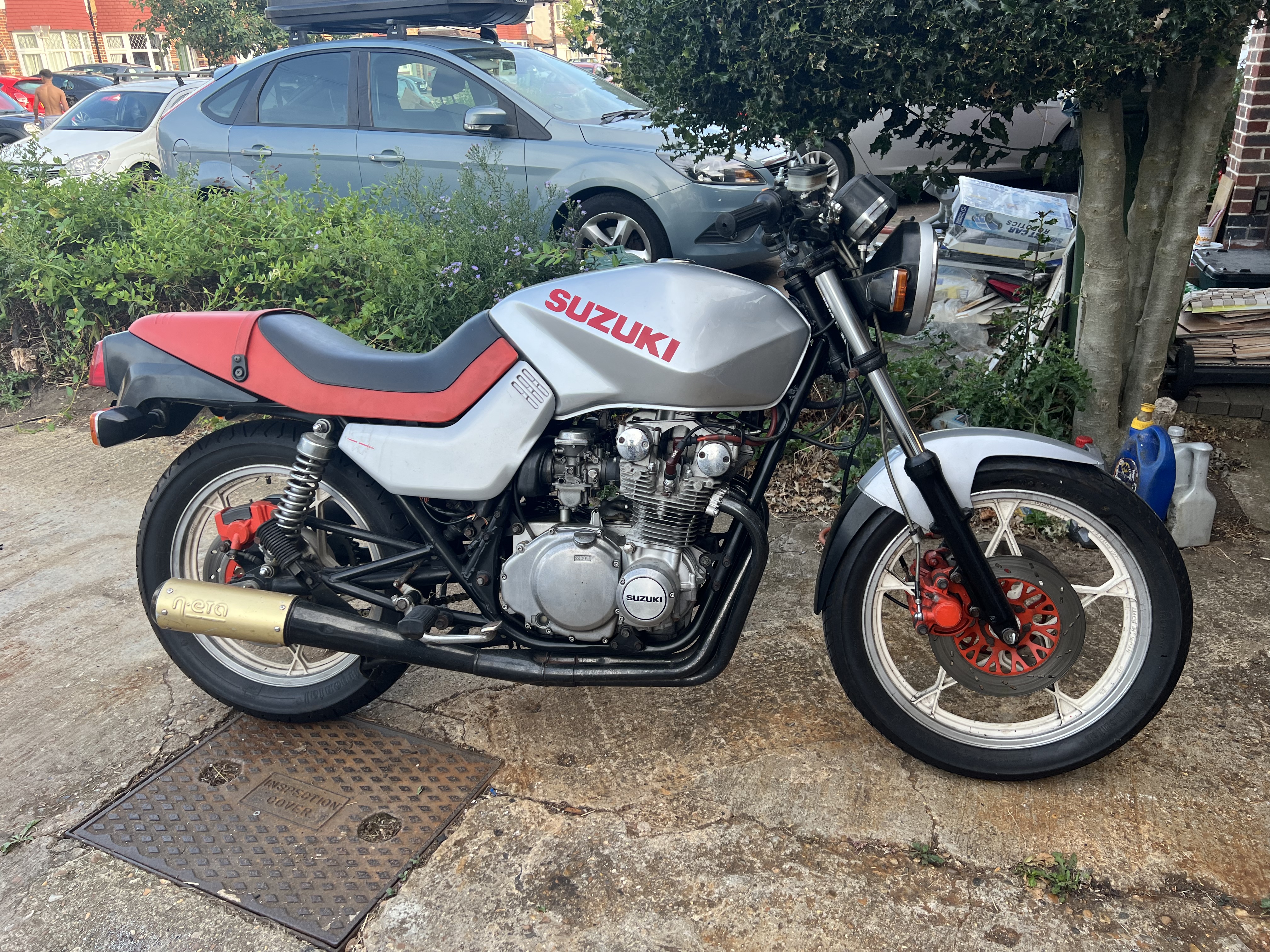

It was a non-runner but that's ok I have history with this bike so I'm willing to spend a bit more on it. It has nearly new tyres chain & sprocket and the new seat I fitted just before I sold it is still in very good condition. It has a motad exhaust that was fitted before i bought it the first time i had it is still in good condition. It had no spark the CDI was dead so I replaced it and tested the rec/reg but it was over charging so that's what probably killed the CDI. It runs ok above 2500 revs but not very well at low revs. I cleaned the carbs in my ultrasonic cleaner and I did a compression test. It's very low on the inner cylinders 65psi and little bit higher on the outer cylinders 95psi but that's still too low so I did a leak down test and you can hear air escaping into the crank case. It is running very rich so I will see if I can adjust the mixture to getting it running a but better at low revs so I can ride it before I get parts together for a rebuild. Not sure yet if it needs rings or a rebore I will have to strip it down to have a look but I would like to ride it a bit more before winter.

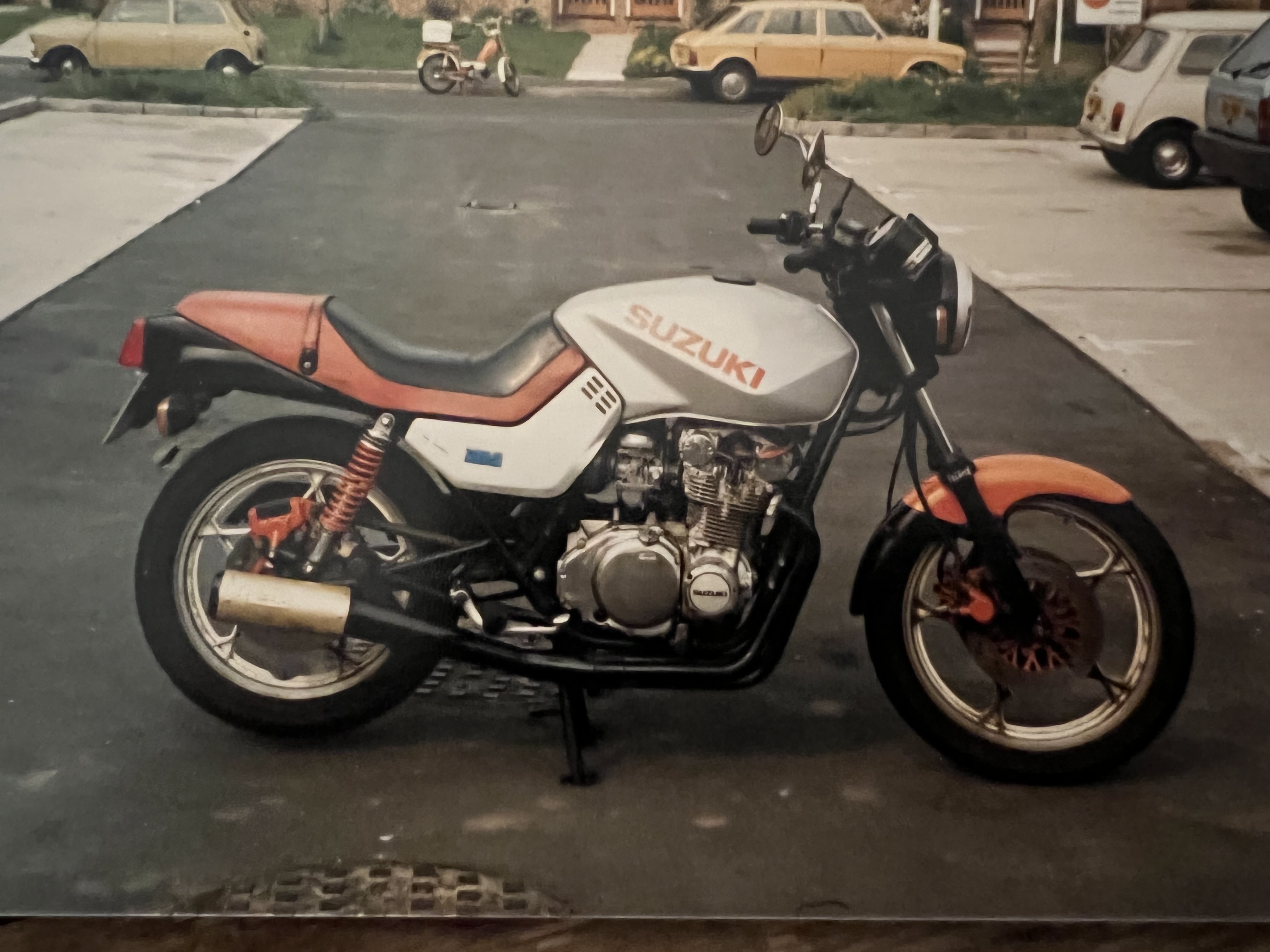

Bike the first time I had it
Bike now
Bike now

Wow. That looks to still be in excellent condition.
Love the old photo. Especially the Austin Maxi in the background. I passed my car driving test in one of them. Also Mrs GSF34058 currently has a beige Mini, and had a Honda Melody, if that is what is in the background. So I'm feeling all nostalgic now!

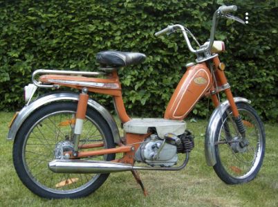

Looks like a Honda Novio which was my first bike! Don't ask.. I hadn't saved up enough cash for the Fizzy until 2 months after my 16th birthday - no bank of mum and dad in those days!

I think it's a Honda Camino. NOT my first bike!

I still think it's a Novio :-) I do have the same engine ( 49cc OHV ) in a couple of PC50K0 I have :D
