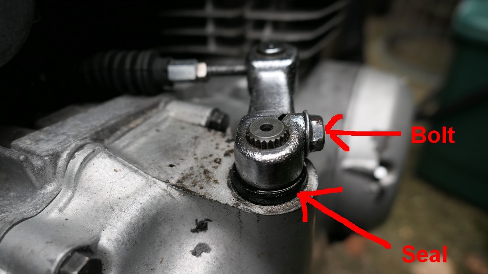

Here's a photo of the offending seal I should have posted, rather than my garbled description.
I guess I could try just removing the bolt, take the arm off the splines and try levering out the seal with a flat headed screwdriver?

Looking at exploded diagram there are 2 seals , so 1 must be under the actuator arm the other on the shaft .

Re: Suzuki GS 650 Katana Clutch Push Lever Oil Seal
Hi.
I have replaced that oil seal on the Kat I am rebuilding at the moment.
You are right in that it is removed outwards from below the actuator lever. This just lifts off having removed the pinch bolt. But it might need a bit of gently persuasion to get it moving.
The seal may well then be removed using a suitable tool to lever it up and out. But it may prove to stubborn! If you can get the seal out with everything in place then tap the new seal in having given it a wipe over with some grease.
I practised on a damaged clutch cover and found that the seal and upper needle roller bearing will come out if the clutch actuator shaft is drifted gently from below to move both the upper bearing and seal. This should leave the upper bearing able to be refitted.
The lower bearing I could not remove without destroying it! The only reason to remove the lower bearing is to have the clutch cover chemically dipped or some such, unless you found the cover in the compost heap or in a canal
Refitting is pretty straight forward. I greased the lower bearing with corrosion resistant grease, Then dropped the actuator shaft into place.
Then having greased the upper bearing it can be gently drifted back in followed by the seal that has also been greased to avoid damage to the seal lips. A 3/8” or 1/2” drive socket is as good as anything to use as a drift.
Well in the end, the seal just came out using a flat bladed screwdriver. No need to take the cover off. So it was a quick job.
Looking on YT, it seems other bikes sometimes require removal of the cover to gain access to the seal but I was lucky here. Took the bike for a quick spin and it seems to be oil tight so far, so fingers crossed that's fixed it.
For anyone that's interested, got the seal (pattern) from Wemoto for £3.47 inc P&P. They're based in the UK and have quite a few Katana parts. Have found them reliable with good service in the past.
