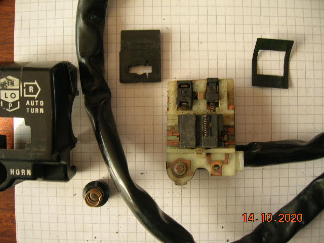

Three times over the years I have had the turn/main/dip button fall off whilst I have been out riding. Perhaps I use the indicators too much??
Twice I replaced it with a genuine Suzuki assembly. After it came off the third time I managed to grab hold of the button and use it to make an improved metal slider part that goes in the switch. This has not come out (yet!).
I still have one original switch unit, without the button. I have partially stripped it and here is a photo of the inside. If you need me to take it apart further just let me know. I can also take higher resolution photos.
I'm not too sure about the location of the two black parts at the top. They fell out as I took the switch apart. I do know that the flimsy plastic part goes back in first, then the thicker part with the slots in it, but I'm not yet sure which way around they go.

Thanks David...that's a great help. Shows clearly where one of the springs goes :D I know how the two black bits of plastic fit...so just one more spring and a small ball bearing to go. It is a pain putting it back together but once I know how the last two bits fit will persevere till done :)
