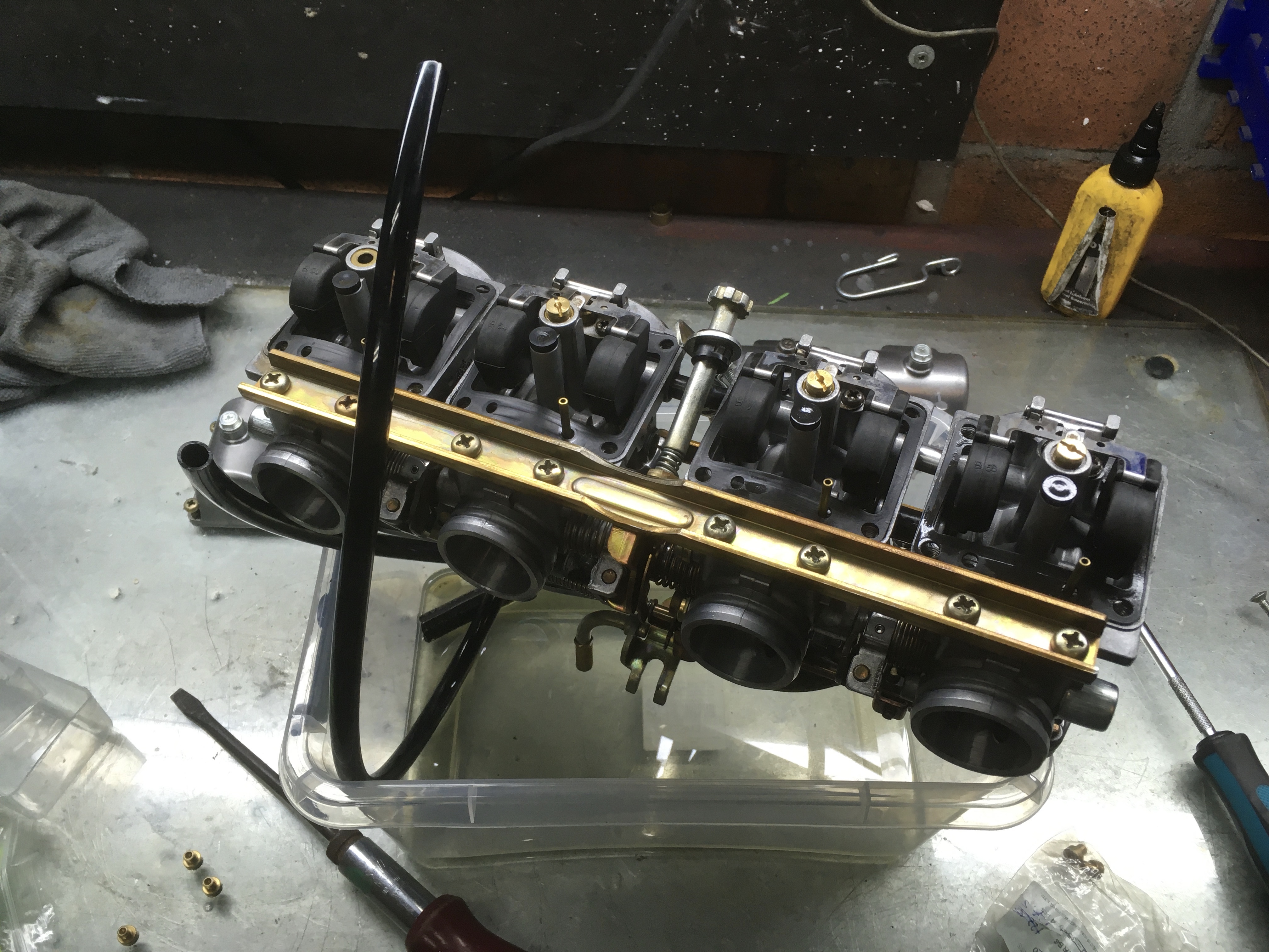

Post by SamK » Thu Sep 10, 2020 6:25 pm
So the saga continues...
Although it doesn’t seem quite so bad now, seems to rise to just over 2k revs, which is bearable.
Been doing other tinkering in the meantime. Changed the handlebars to be slightly higher and replaced the clutch and brake pipes with Venhill ones. Had a delay with the Spanish post losing a package and then me not measuring the brake line properly.
It’s a wonderful feeling putting the steering on full lock without catching your thumb
However, test run yesterday showed up another issue....
Bike revs freely at standstill but then bogs down at around 4K revs under load.
Felt like ignition coil issues I had years ago but they both check out ok.
Over the past couple of months the fuel in the carbs has completely evaporated a few times.
So carbs off again and another clean.
