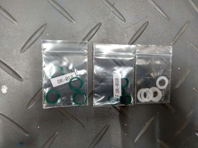

Post by SamK » Mon May 25, 2020 12:23 pm
Update...
Throttle shaft seals have been replaced but the problem persists.
Any further suggestions?
Sam.

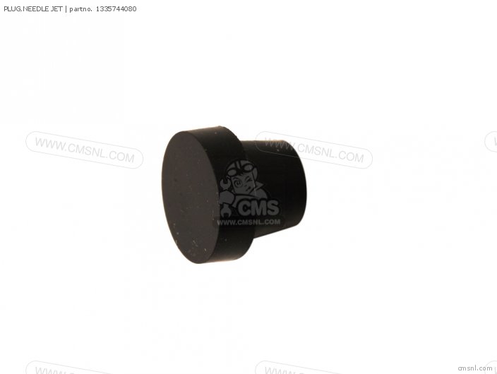

Post by Lexdba » Mon May 25, 2020 3:43 pm
And does it react to anything when ice-cold? If it's a leak it should definitely pick up rpm's.
Are all of these present?
SamK
Posts: 266
Has thanked: 11 times
Been thanked: 64 times
Re: Popup carbs
Post by SamK » Mon May 25, 2020 5:33 pm
Lexdba wrote:And does it react to anything when ice-cold? If it's a leak it should definitely pick up rpm's.
I spray tested both when just started and ticking over and after a run with no noticeable Rev increase.
I’ve not been in the float bowl at all.
I assume if that plug isn’t sealing, or missing, it could draw fuel up into the mix?
