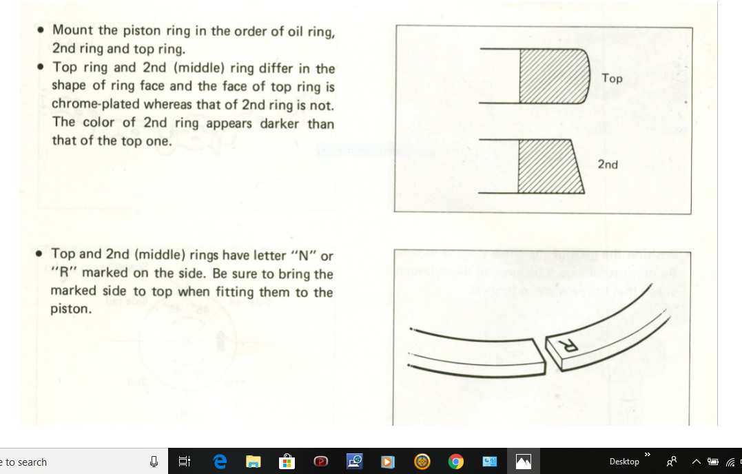

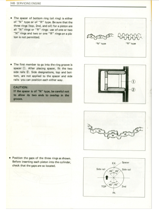

Hi Mick
Grabbed these images from my workshop manual. OK so it's for a "Boat Anchor" but it's still relevant
I think I have a valve spring compressor in the shed. I'll have a look and see next week before the mice bed down for the winter and let you know! you're more than welcome to borrow it if I have and I will send it up to you with your Ventura side rails.
