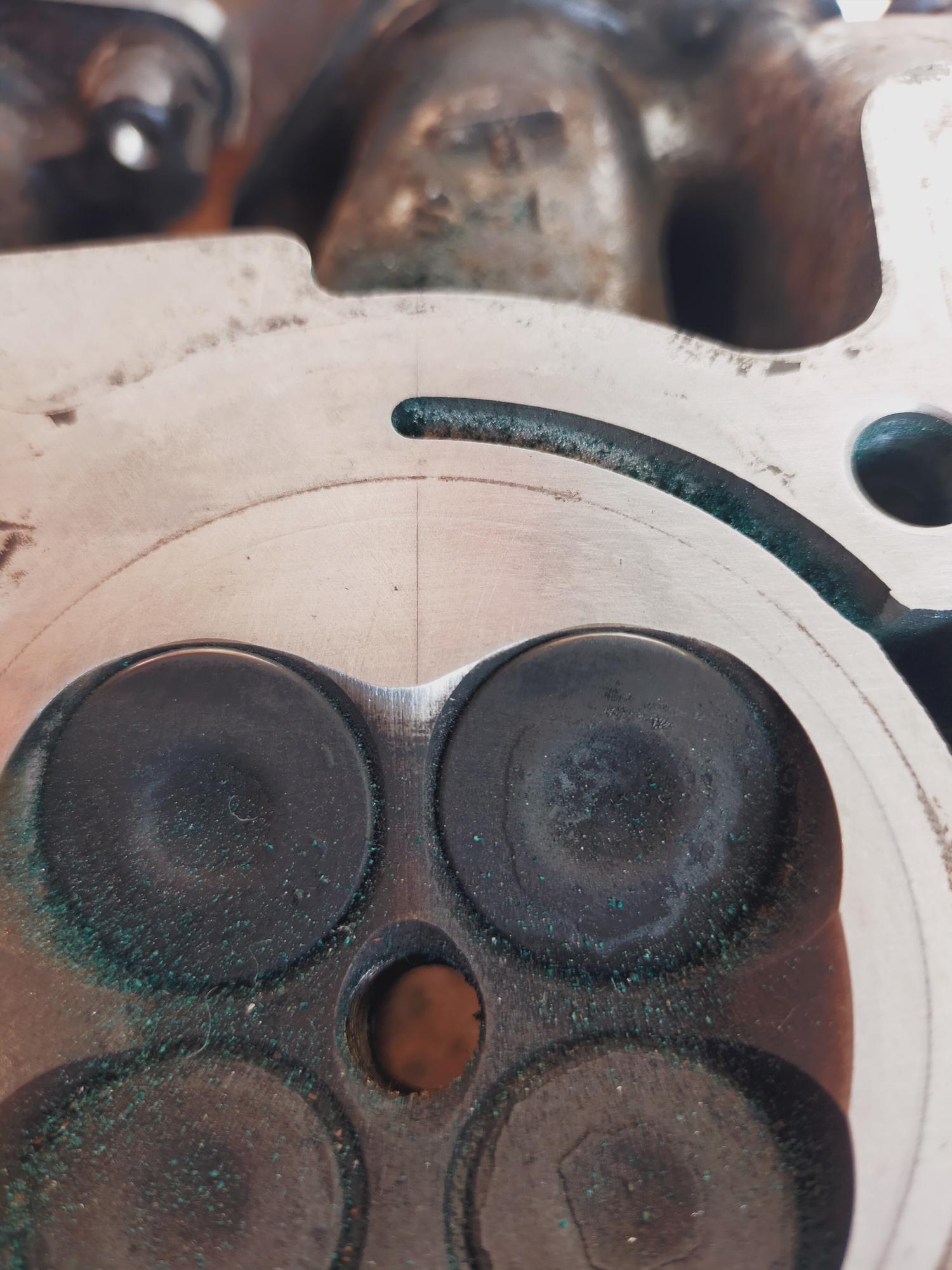

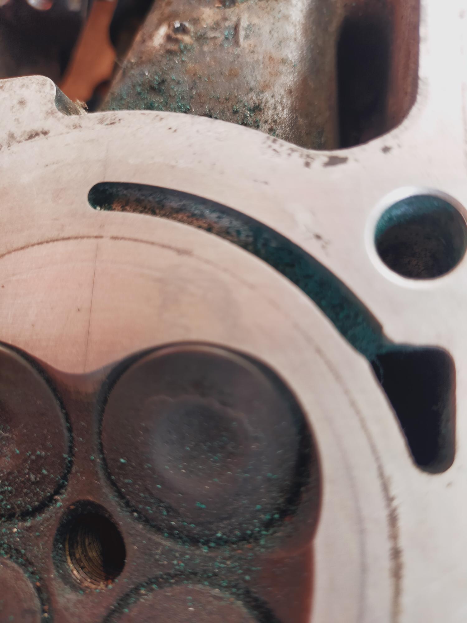

Hi all, following low compression readings (2&4) I pulled the head off to commence inspection.. valves are caked in soot, but the elephant in the room appears to be what feels/looks like a fracture/crack on number 2... it can be felt when running a thumbnail across it.. I fear it may well be game over for the head
I would appreciate you thoughts

Hi Smallkat, certainly, yes... I`m still deciding on whether to rebuild this mill, working on the premise that the line is indeed not a crack... I do need a head gasket, obviously, and I have been reliably informed you are the very fellow I need to speak to!!...
I`ve had no joy with Fowler`s nor Robinson`s Foundry.. is it possible that you can point me in the right direction>?

Hi Bob, that is an option to have one cut on my oppo`s laser cutter and keeping it mind... I may need to think about a skim of the head due that "line" on number two. or I opt for another mill or shove something naughty in!!...I regretfully have had to shelve it for the moment as ain`t making any money when I`m preparing to flush it down the SSN whole!!!... admittedly, the purchase of was a view to dismantling and selling as spares.. In stead of this I have sentenced the bike to the corner of my lock up to think about it`s actionsUncle Bob wrote: ↑Thu Feb 16, 2023 11:27 amIf you can't get one how about making one out of copper? Allen Millyard video on how he made his 6 cylinder one
