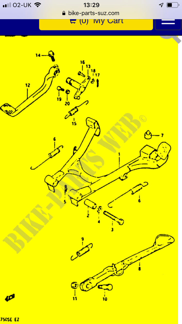

Pop up centre stand - item 7
- Posts: 1807
- Has thanked: 122 times
- Been thanked: 257 times
Re: Pop up centre stand - item 7
Must.......
Resist......
Probably on the LH exhaust silencer
Stops the centre stand clanging against the silencer or coming into contact with the chain
Resist......
Berti44
- Posts: 119
- Location: Wolverhampton
- Has thanked: 5 times
- Been thanked: 21 times
Hi Blix yep it’s a rubber bung, but no hole for location on the centre stand or swing arm, those were my thoughts too.
I think Kryten has probably solved my query but not got to the stage of fitting the exhaust which is motad Neta.
The centre stand at the moment does hit the chain. Thank you both for your reply’s
- Posts: 5206
If you have a Motad system fitted the bung goes on the mounting bracket to stop the centre stand fouling.
If you have a Motad Neta system you will need to adjust the silencer just after the collector with a ball point hammer to accommodate rear brake lever travel!
