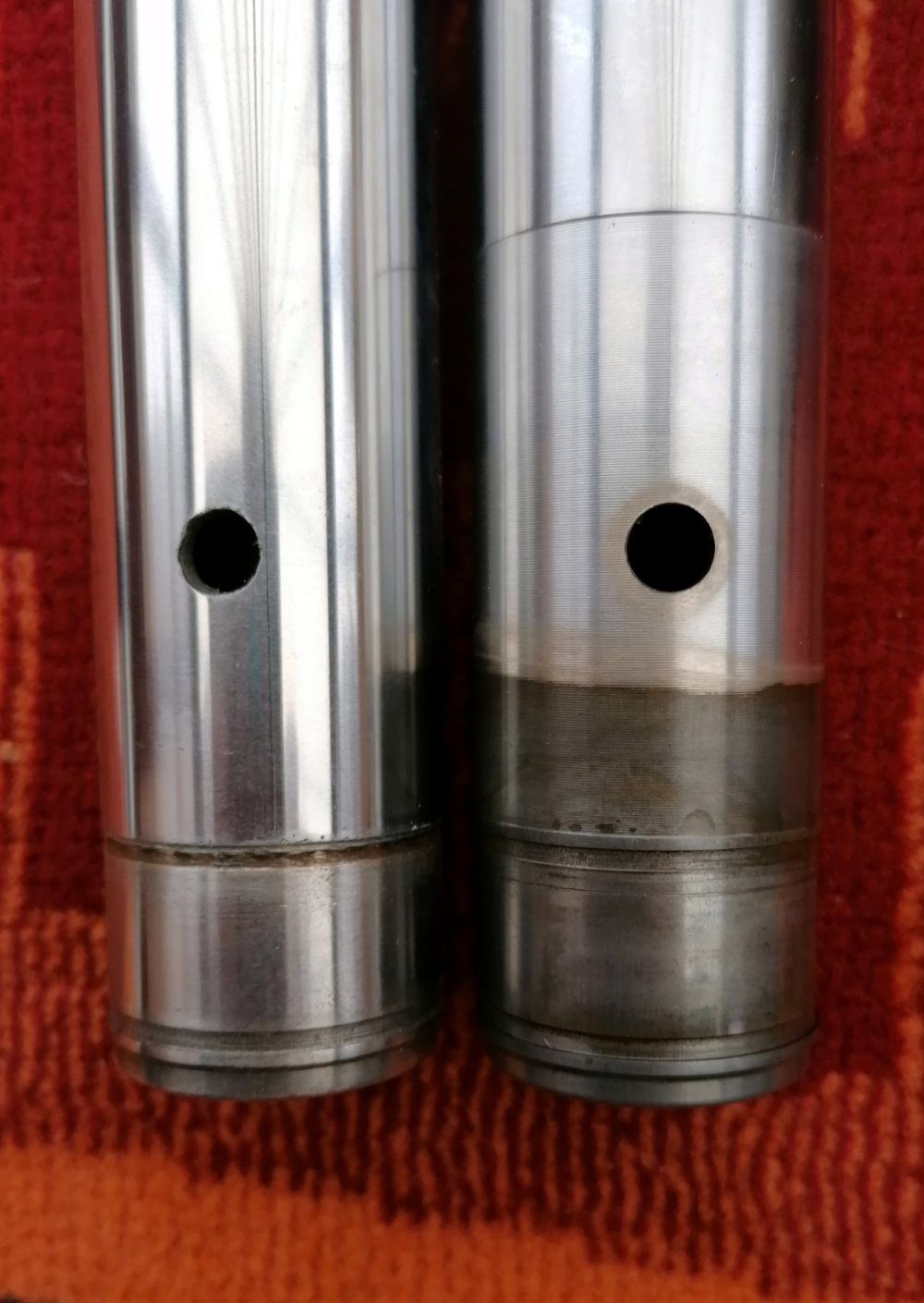

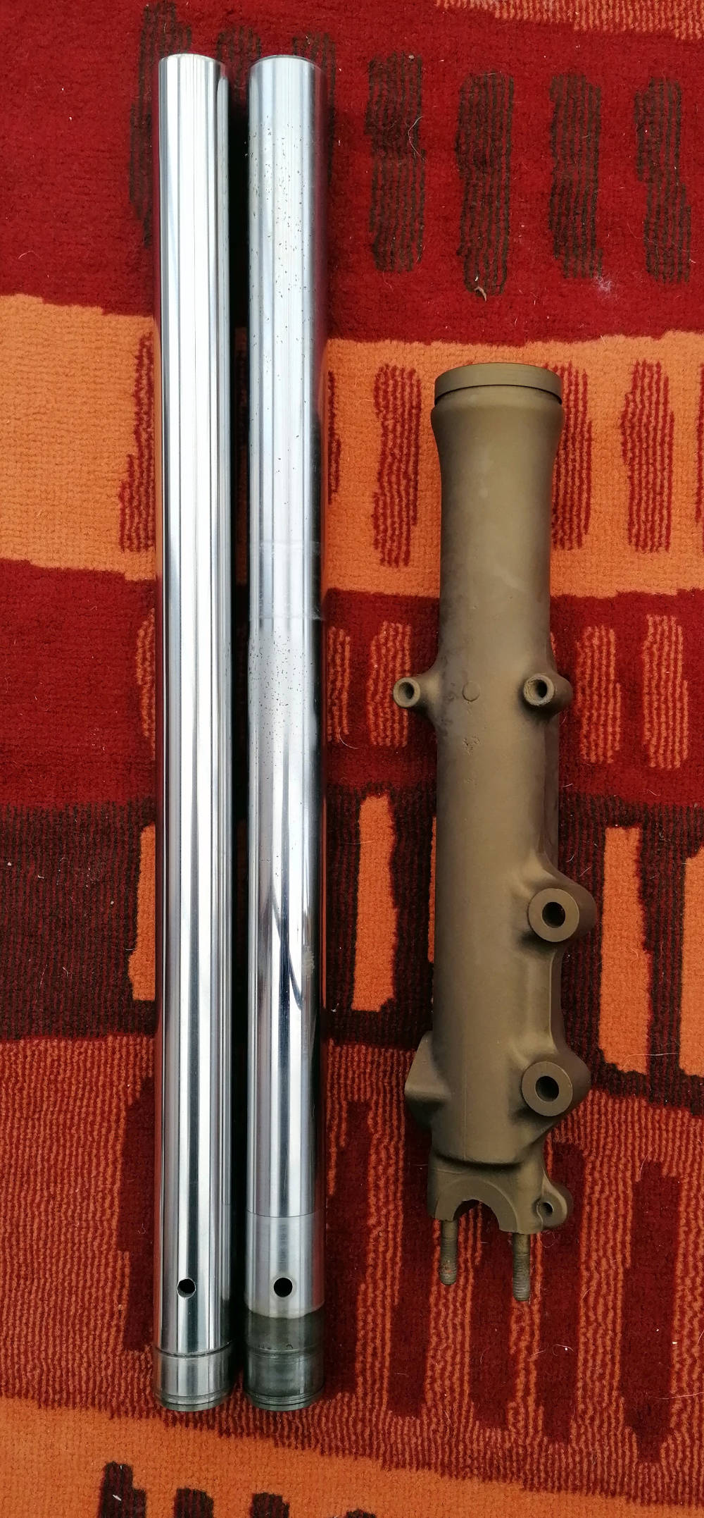

Post by Rob65 » Sat Dec 28, 2019 12:57 pm
I just thought I'd close this post with some feedback. I ended up sending my fork tubes to Philpots rather than Hard Chrome Plating Ltd on the basis the forum comments suggested they were lower risk. They sent their courier to collect, promised max 6 weeks turnaround and had them back with me in two. I don't know if I was just lucky or if they have listened to feedback but they were properly cleaned and stripped of masking. As you can see from the pics, there are some differences to the standard plating - I've taken a pic against another old ESD tube. Diameter is 37mm and quality very good. The top has not been beveled and like Uncle Bob's, they did not grind back the lower area above the bush. Still, I think they charged me £200 and as replacements are now about £240 they do work out good value and the steel may be a better grade that the Chinese alternative although I have nothing to support this.
If you are interested, the fork lower in the first pic has been painted with Cerakote burnished bronze. I may put some details of the rebuild in the projects section as the whole bike will be done in this paint as a bit of an experiment.
