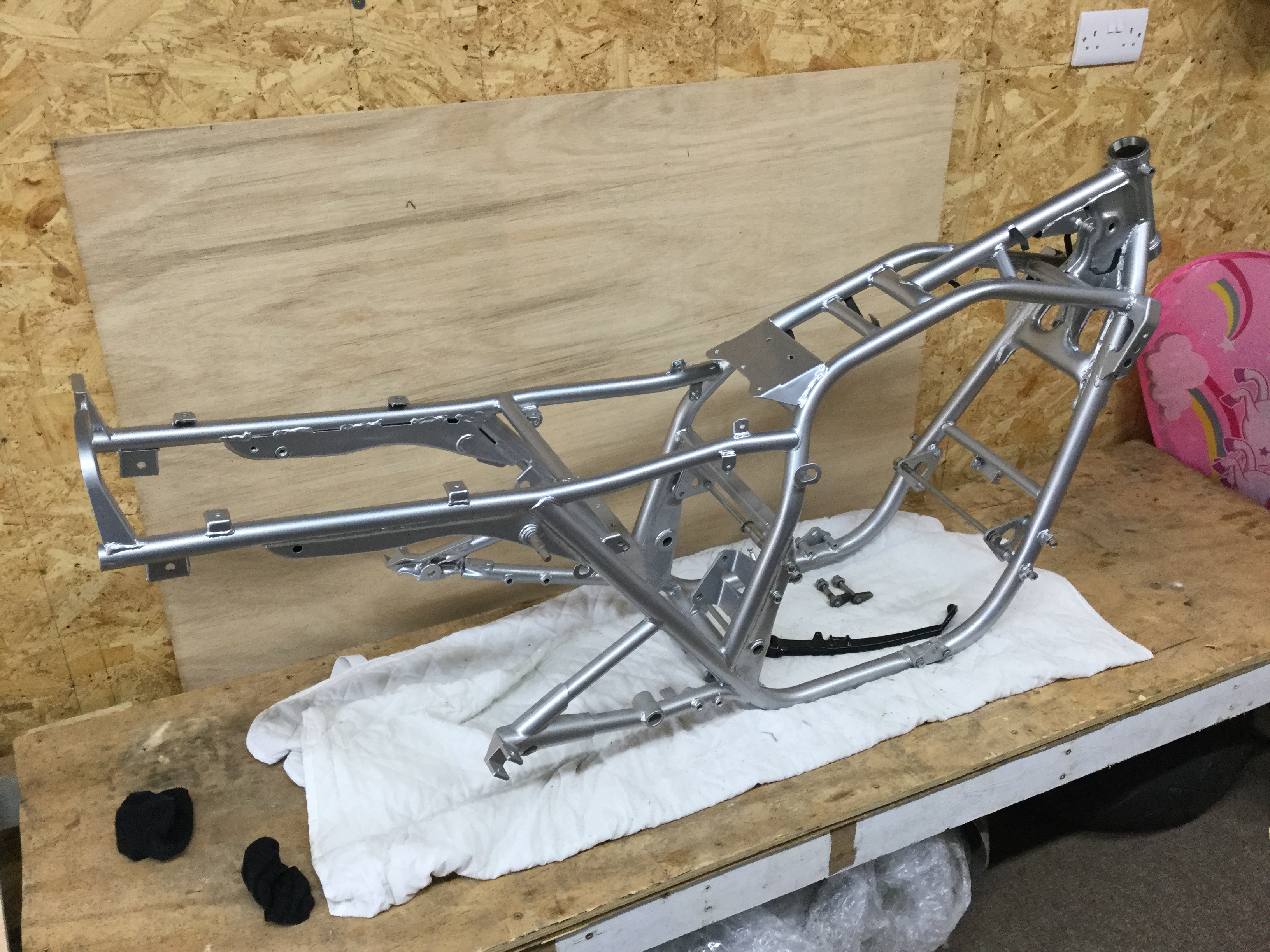

Going to be listing this frame and other parts soon, but want to confirm frame model,I think it’s an sz
Frame number GS110XOO530827
Engine number GS110X-150339
Thanks very much for your time
Posts: 1806
Has thanked: 122 times
Re: Frame I.D
Post by Kryten » Sun Oct 01, 2023 9:42 pm
Looks like an SZ from the front engine mounting point.

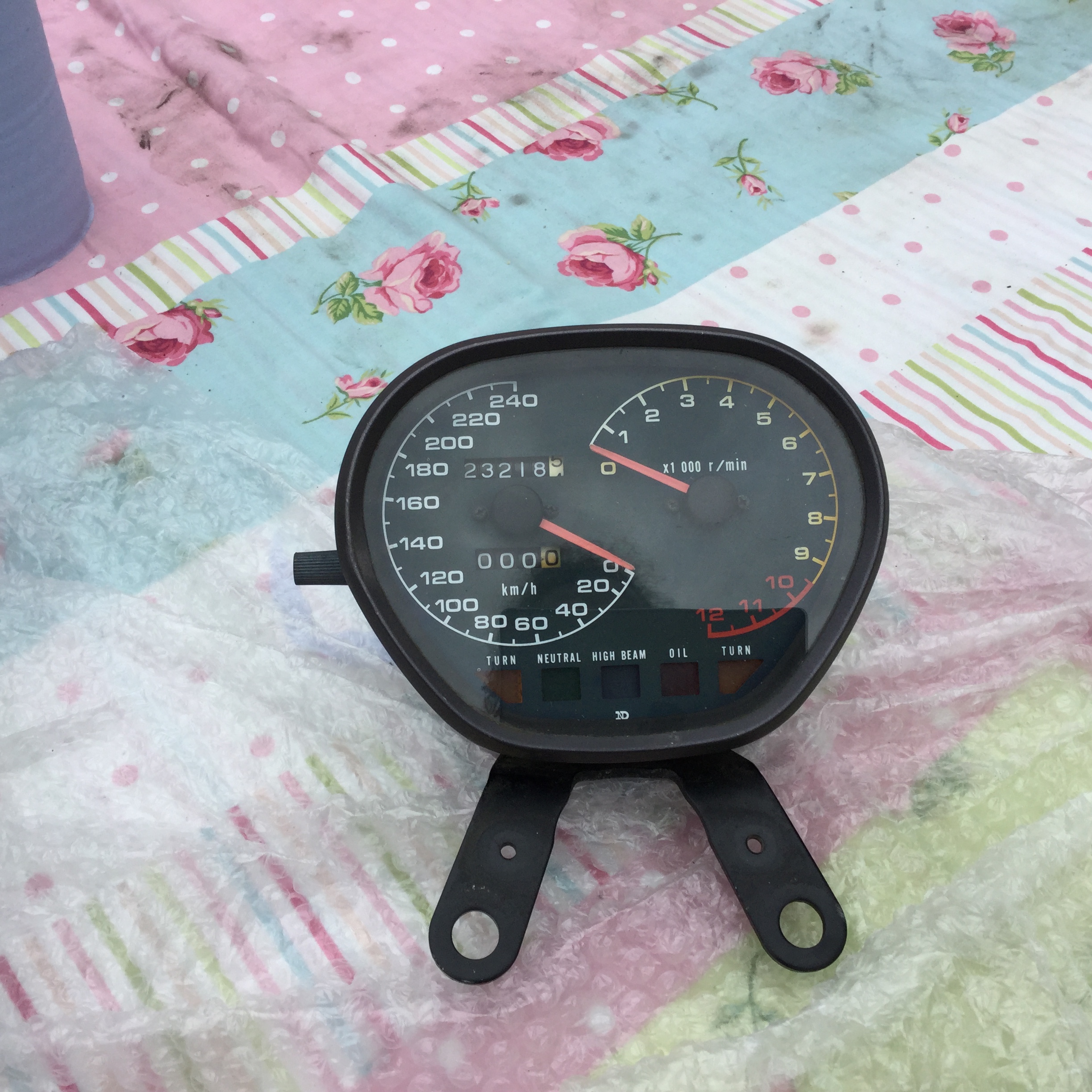

Sorry should have mentioned I have v5
Declared manufactured 1982
Date first reg in U.K. 1989
It came with kph clocks but unsure if there the original ones
Like yourself I thought of front engine mounts,just want to double check

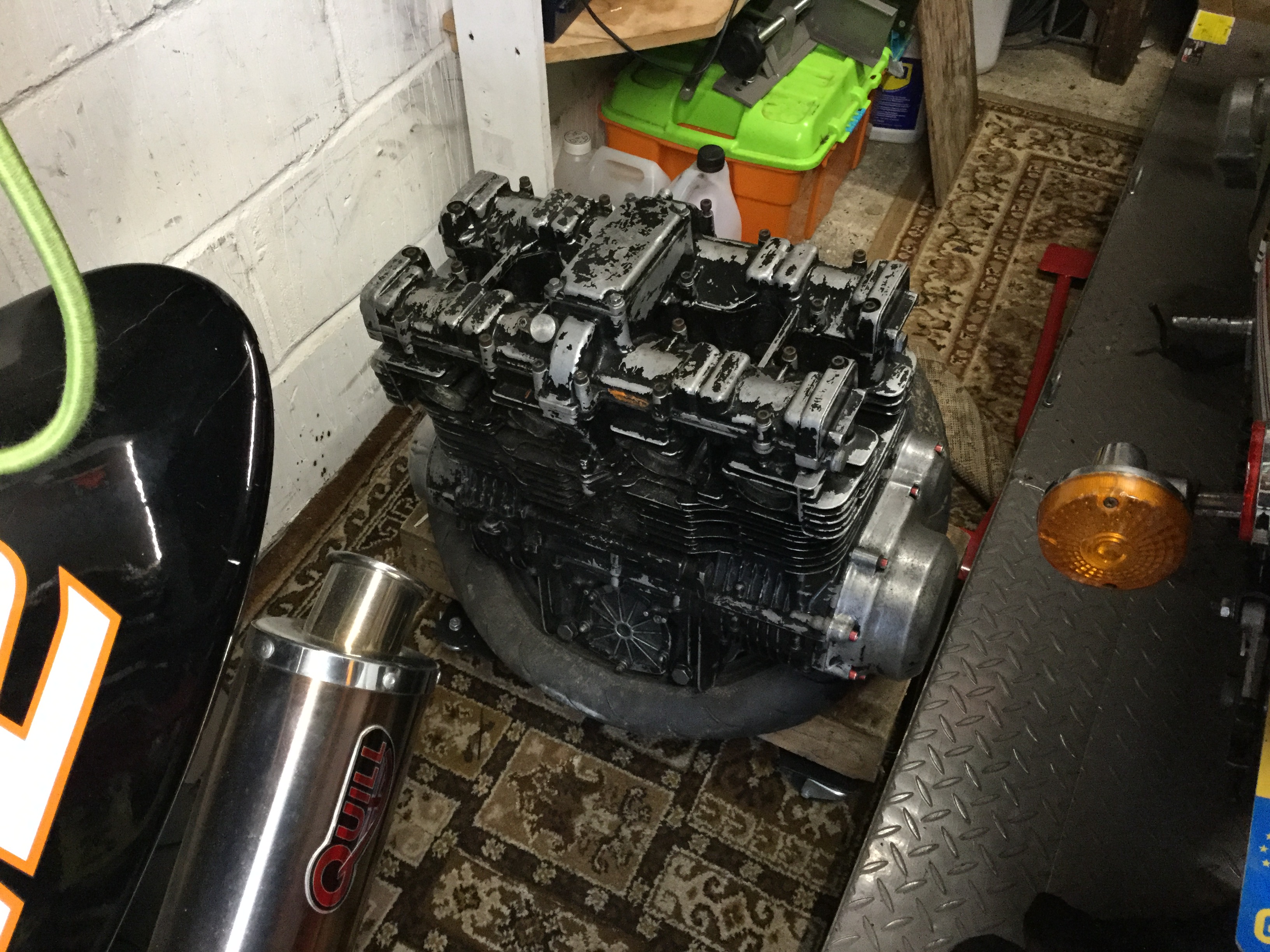

Indeed,the engine is also black
Would the paint come of like this if it was factory black or is it a silver engine painted black (if that makes sense), again thanks for input
Posts: 5204
Re: Frame I.D
Post by fossie » Tue Oct 03, 2023 9:56 pm
That engine has been painted aftermarket,its the wrong colour and type. Ultimately it dosen't really matter 40 years on , its going get blasted and recoated eitherway I'd have thought.

Re: Frame I.D
Post by johnr » Sun Oct 08, 2023 8:12 pm
frame is SZ.
frame is also bent on the right side footpeg carrier. they almost always bend where the rear brake pivot is welded into the lower tube. its visibly bent in the pic. the lower tube should be straight but the forces of braking bend the tube in time.
Savav2v1

Re: Frame I.D
Post by Savav2v1 » Tue Oct 10, 2023 7:48 am
frame is SZ.
Thanks for that,I see what you mean,hope it doesn’t put people off :( , I’m hoping that people will see it as more of a design fault than a dodgy bent frame :?
