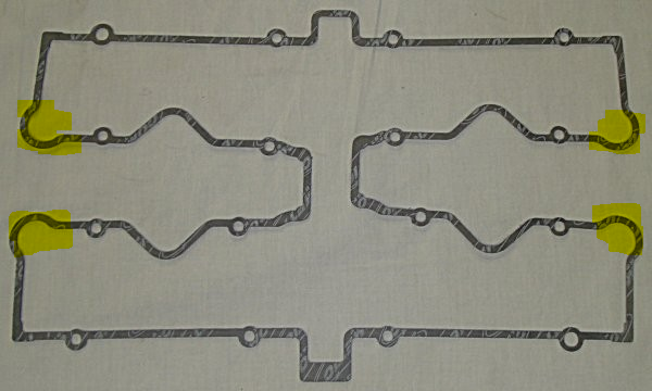

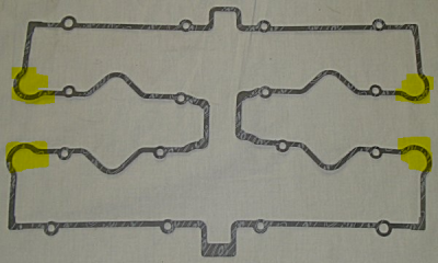

The GSX1100SZ had 20 bolts (holes) cam covers. The GSX1100SD (and I guess onwards) has 24 bolts (holes). On some pattern gaskets the 4 holes that are more or less next to the side covers are not fully enclosed so you might count 4 less (on both) if looking online at images. I have hi-lighted in yellow the image below the ones I mean (this is a SZ gasket).
The SD gasket has the extra 4 bolts end side of the Cam Chain tunnel, I guess cause it leaked there on the SZ(?).

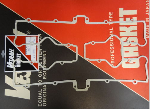

Not wanting to pay Suzuki OEM prices I just bought some Vesrah Cam Cover gaskets from Poland as that was the best price I could find as they gave free postage over €65 (I got some other stuff as well). There's a post I think in the Technical section with part numbers (Vesrah SZ = VV-3006, SD = VV-3020).
