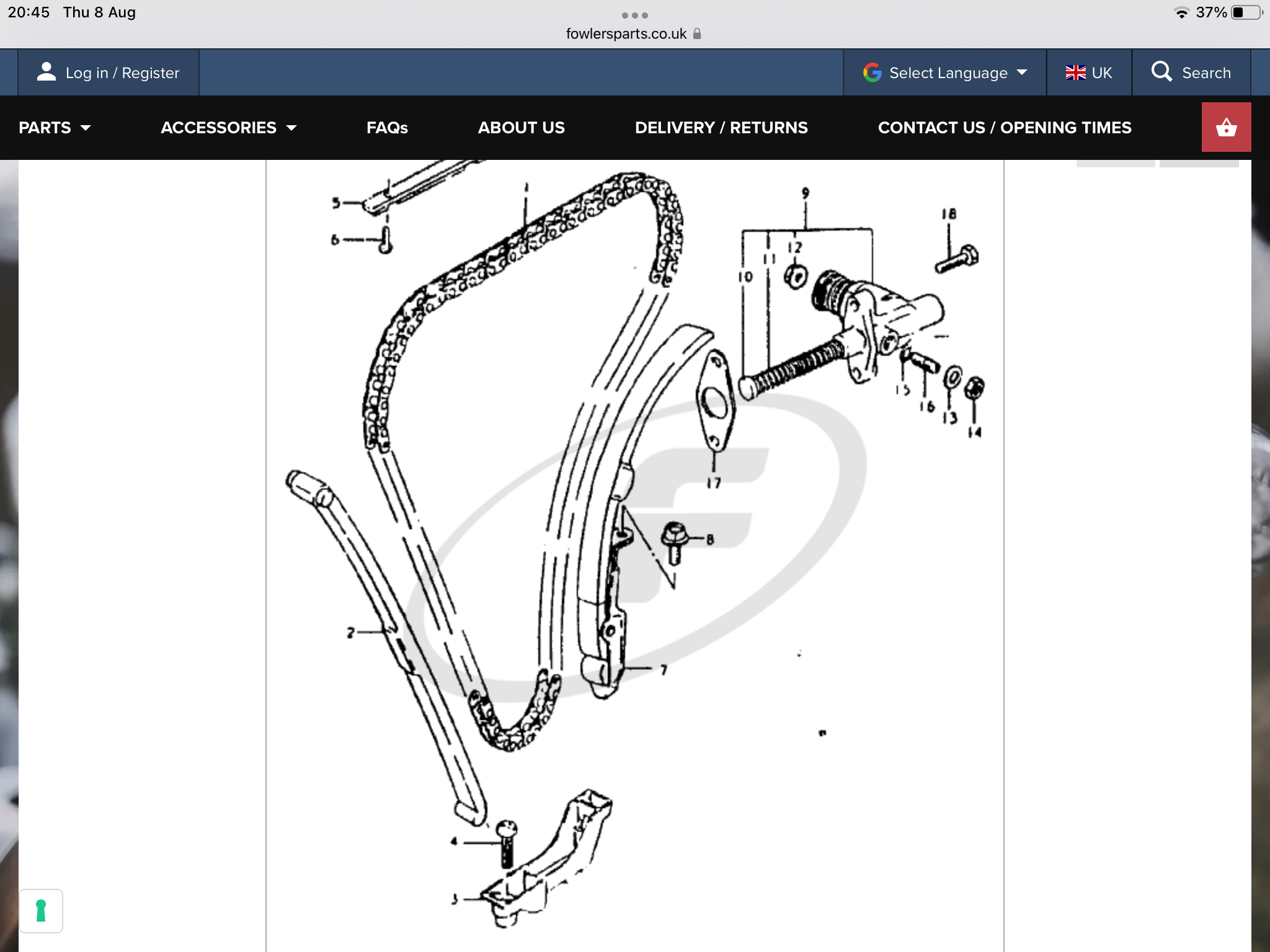

Do you mean the gasket?
Item No. 17 in the picture below.
Apart from working in the space below the carbs, it’s fairly straight forward.
In order to stop the tensioner springing forward and sending plungers and balls and bits all over the place, you need to tighten up a lock bolt. Then it’s a case of removing the two bolts holding it on to the cylinder barrels.

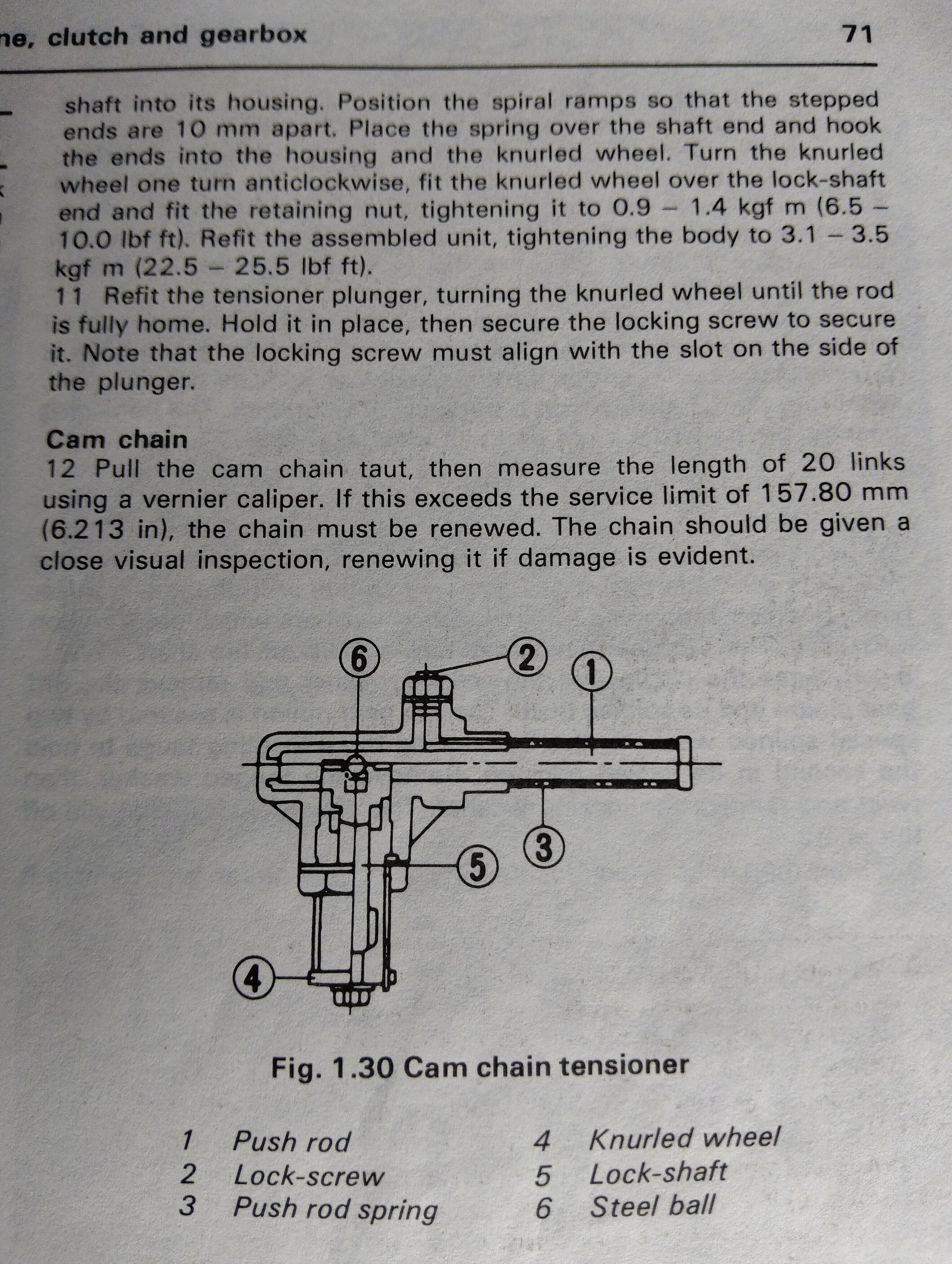

According to the Haynes manual.....

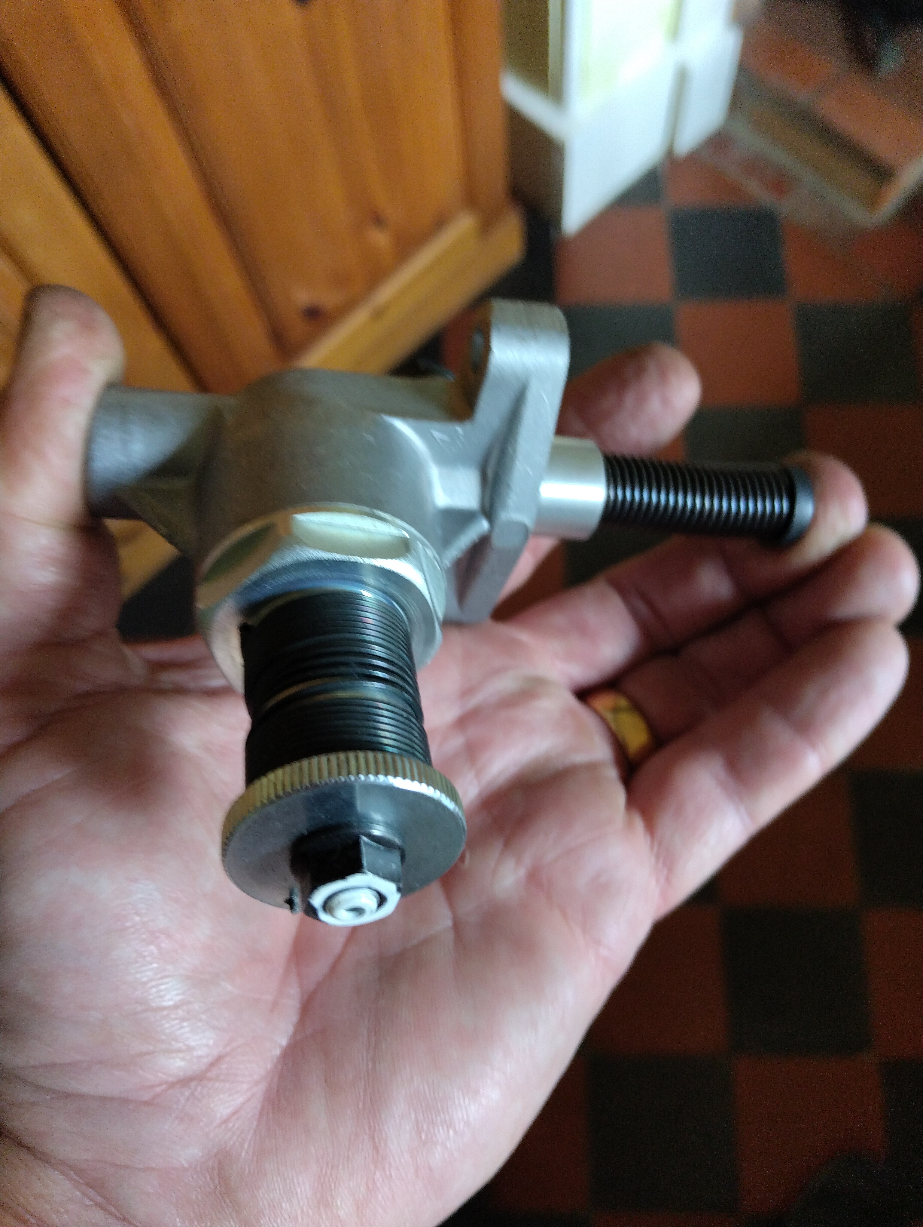

The bit you're interested in is this
On the left hand side of the engine release the lock nut and tighten up the lock screw. Only snug it up to the push rod..
Then tighten up the lock nut enough to prevent it all from moving.
Unbolt the tensioner and replace the gasket.
This is the lock nut and lock screw.

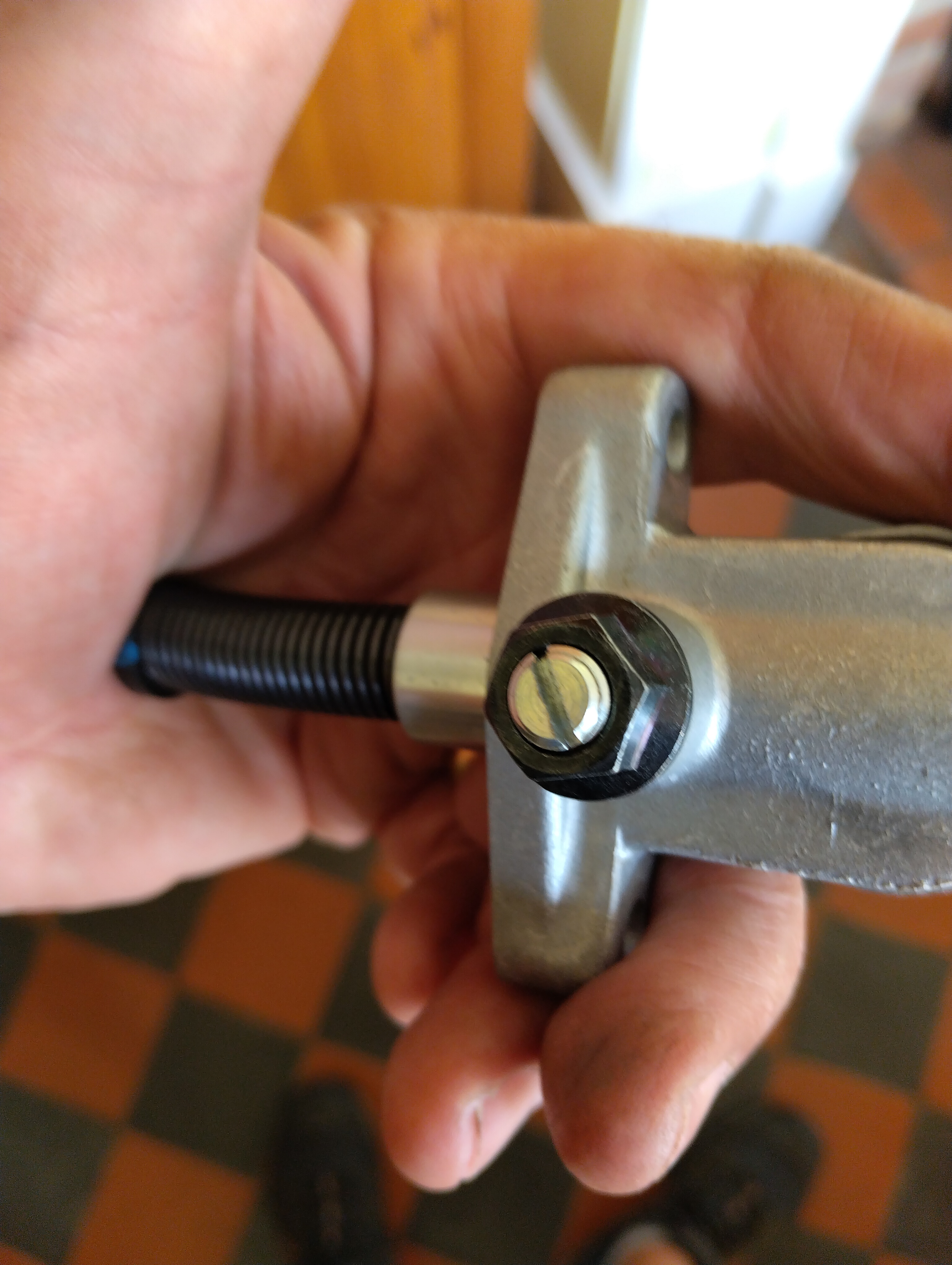

- Posts: 1806
- Has thanked: 122 times
- Been thanked: 257 times
Re: GSX 1100 SD Cam Chain Tensioner Oil Leak
When re-fitting the tensioner you will need to back the push rod into the housing a bit.
Squeeze the push rod back in as the photo while turning the knurled nut anti clockwise after easing the lock screw off the push rod.
The more you turn the knurled nut the further the push rod will go go back.
When you have moved the push rod back enough, tighten the lock screw up to hold the push rod.
Reassemble it onto the engine with a smear of grease on the gasket.
Actually easier to do than write about
