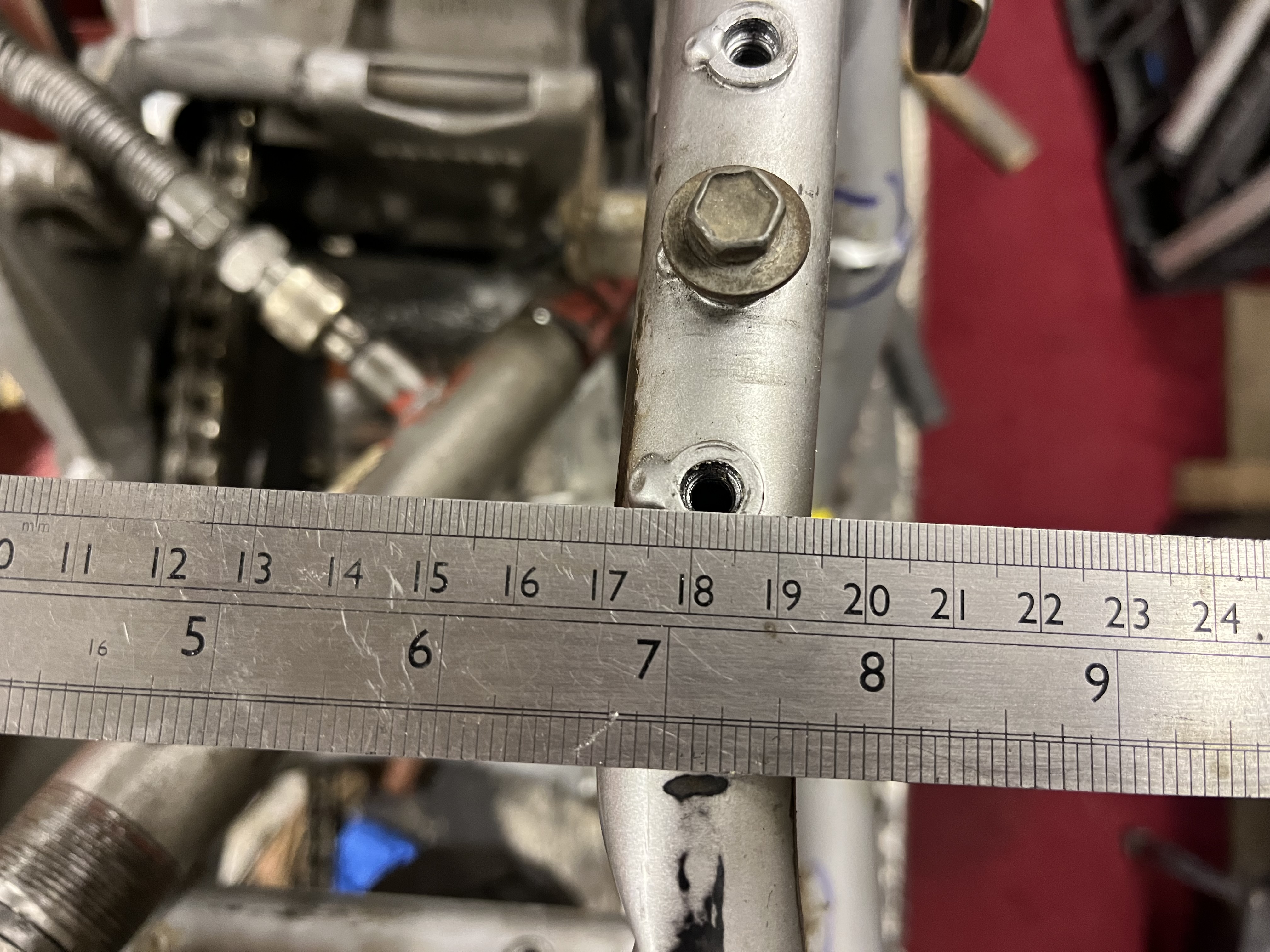

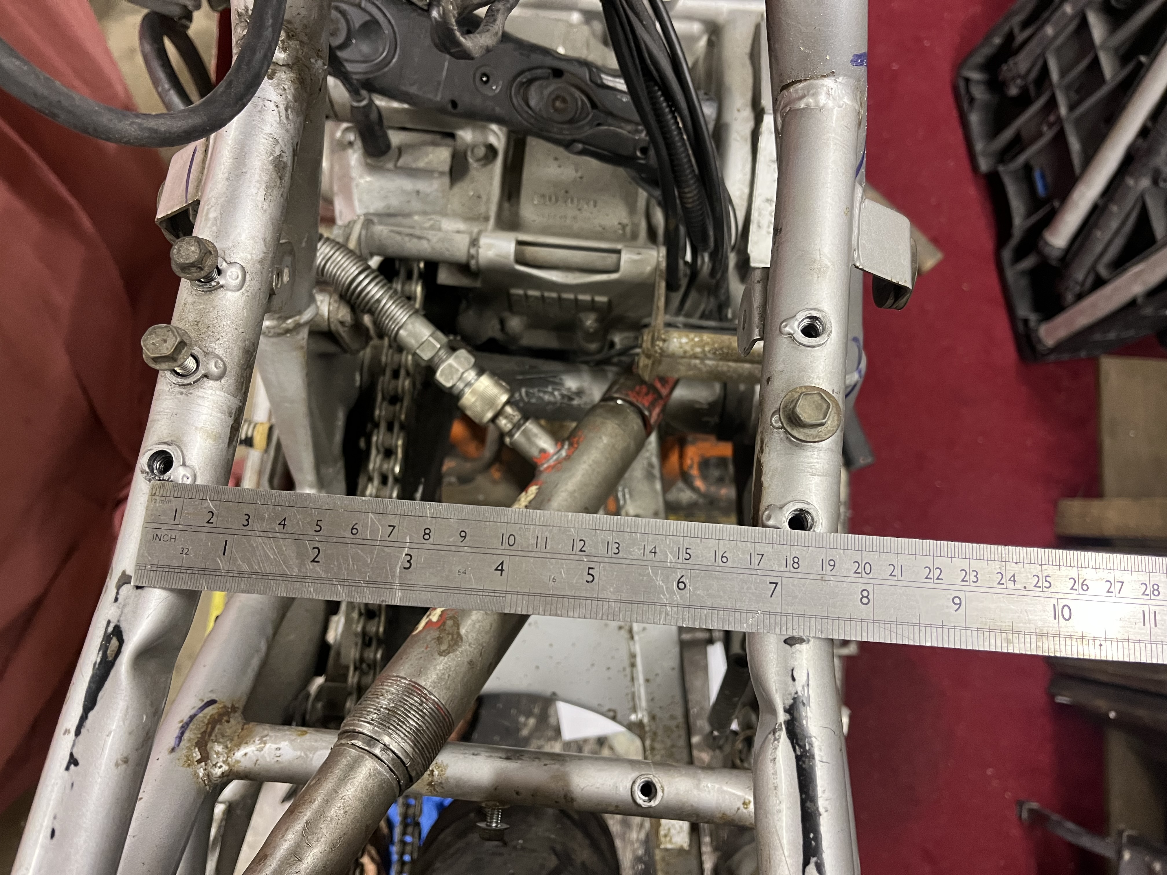

Excuse the pics in wrong order. I’ve two top tubes with manufactured kinks in them but one on the right hand side is the bent one and I’ll push it to where it needs to be. Question I need an answer for is the distance between the bolt centre’s in one of the pics. Can someone just measure me the exact distance the bolt holes centres should be, I’m guessing it’s 190mm to be precise, I’ve put a pic of a steel rule to show.

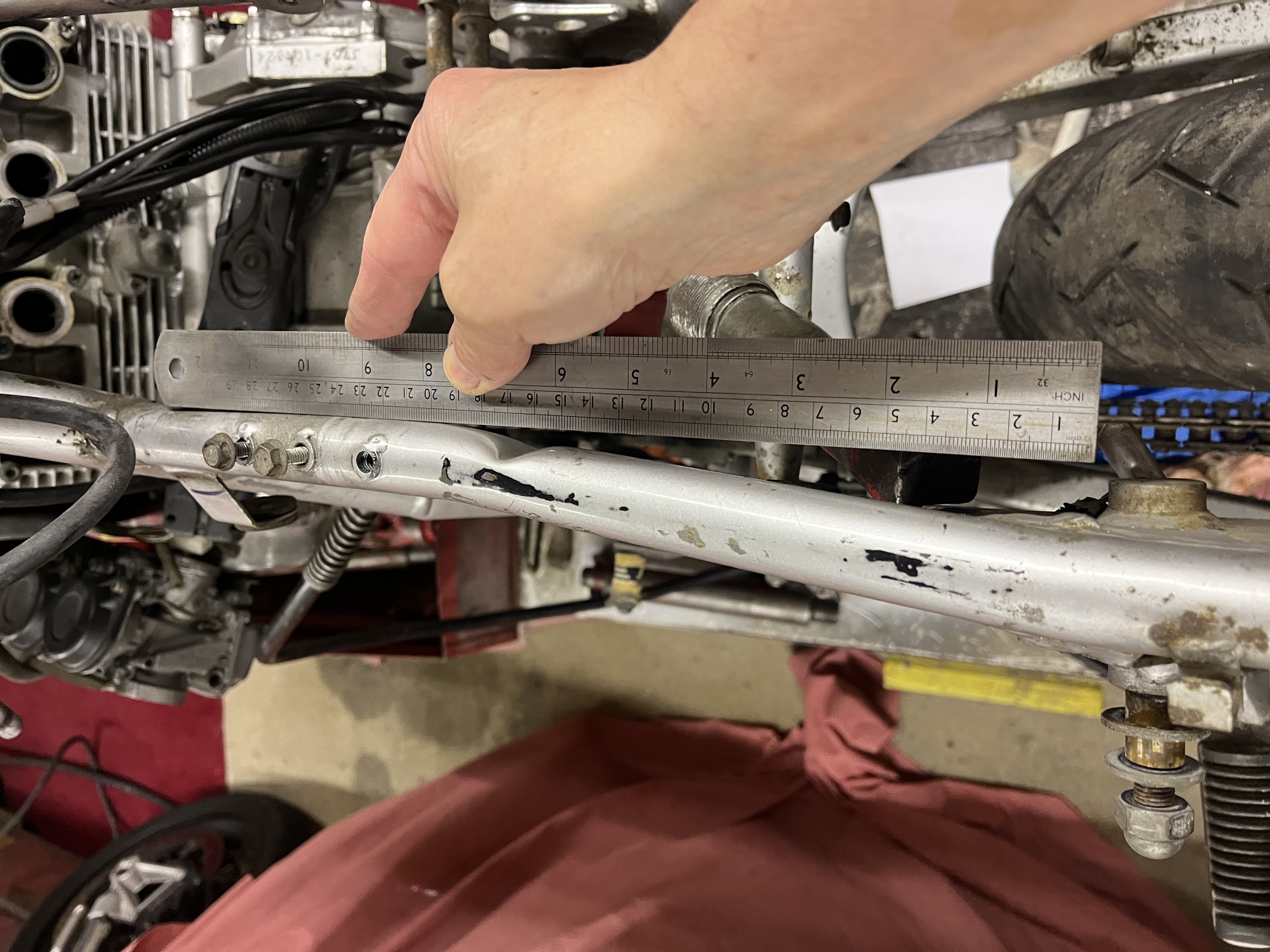

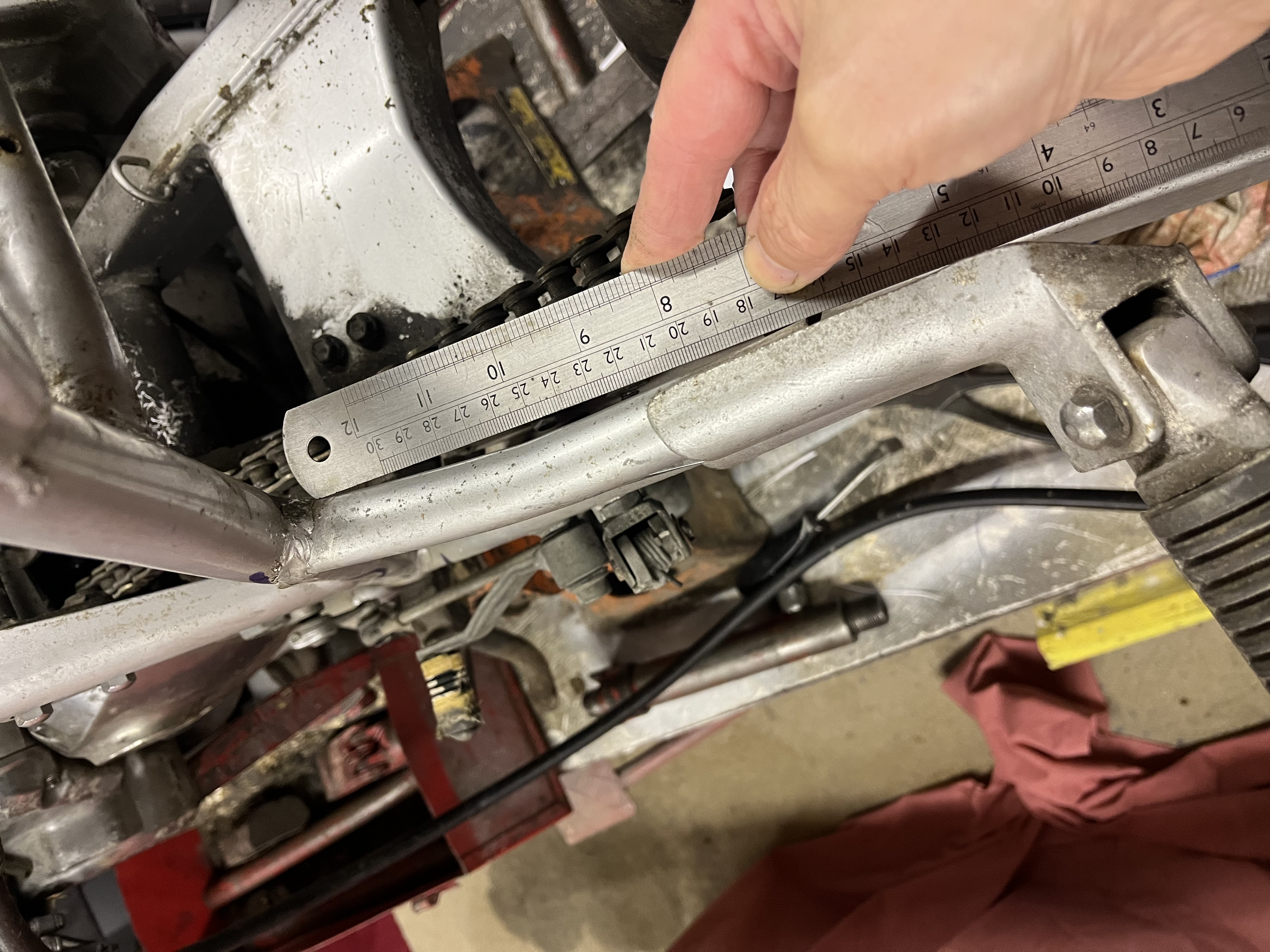

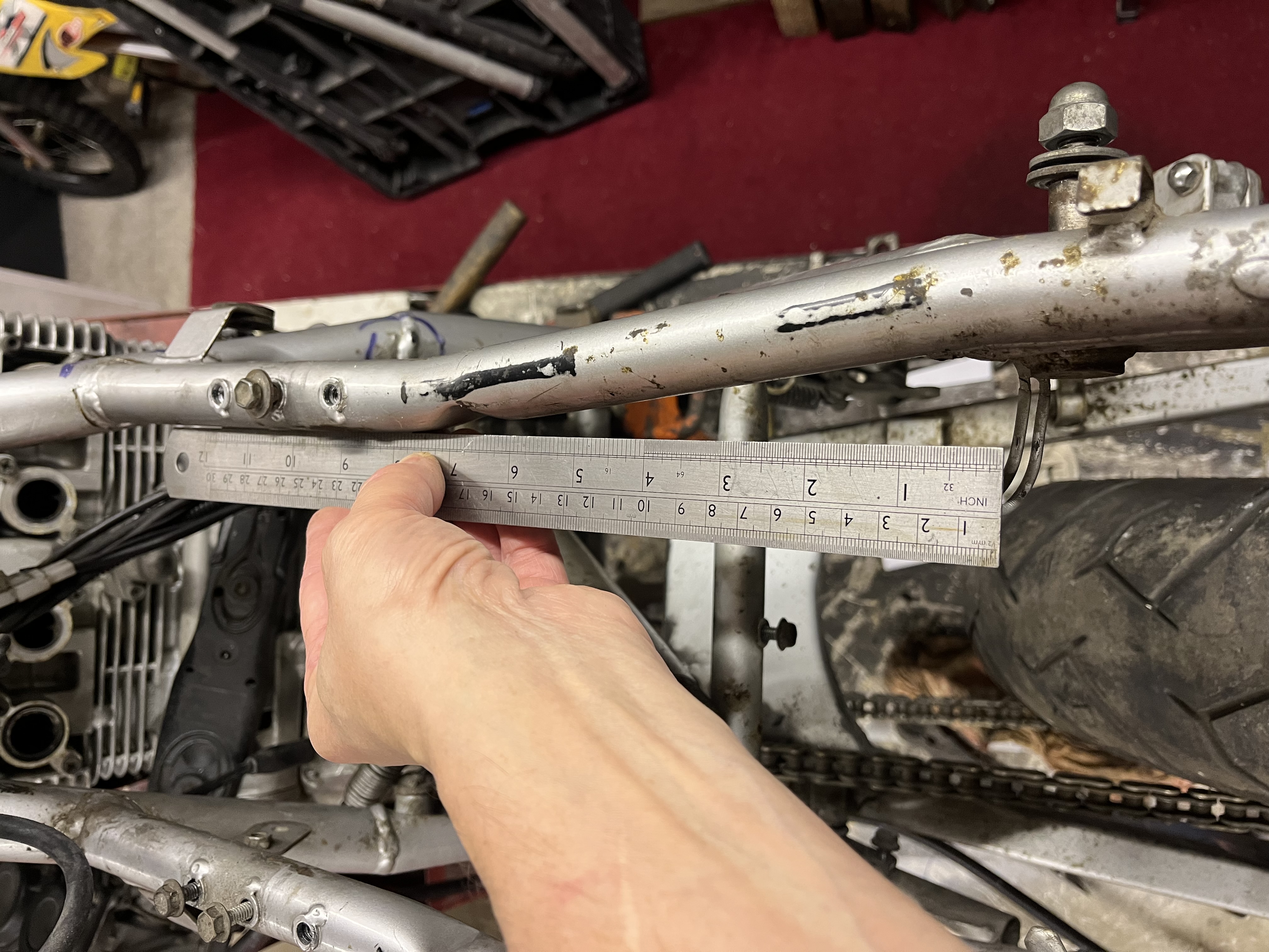

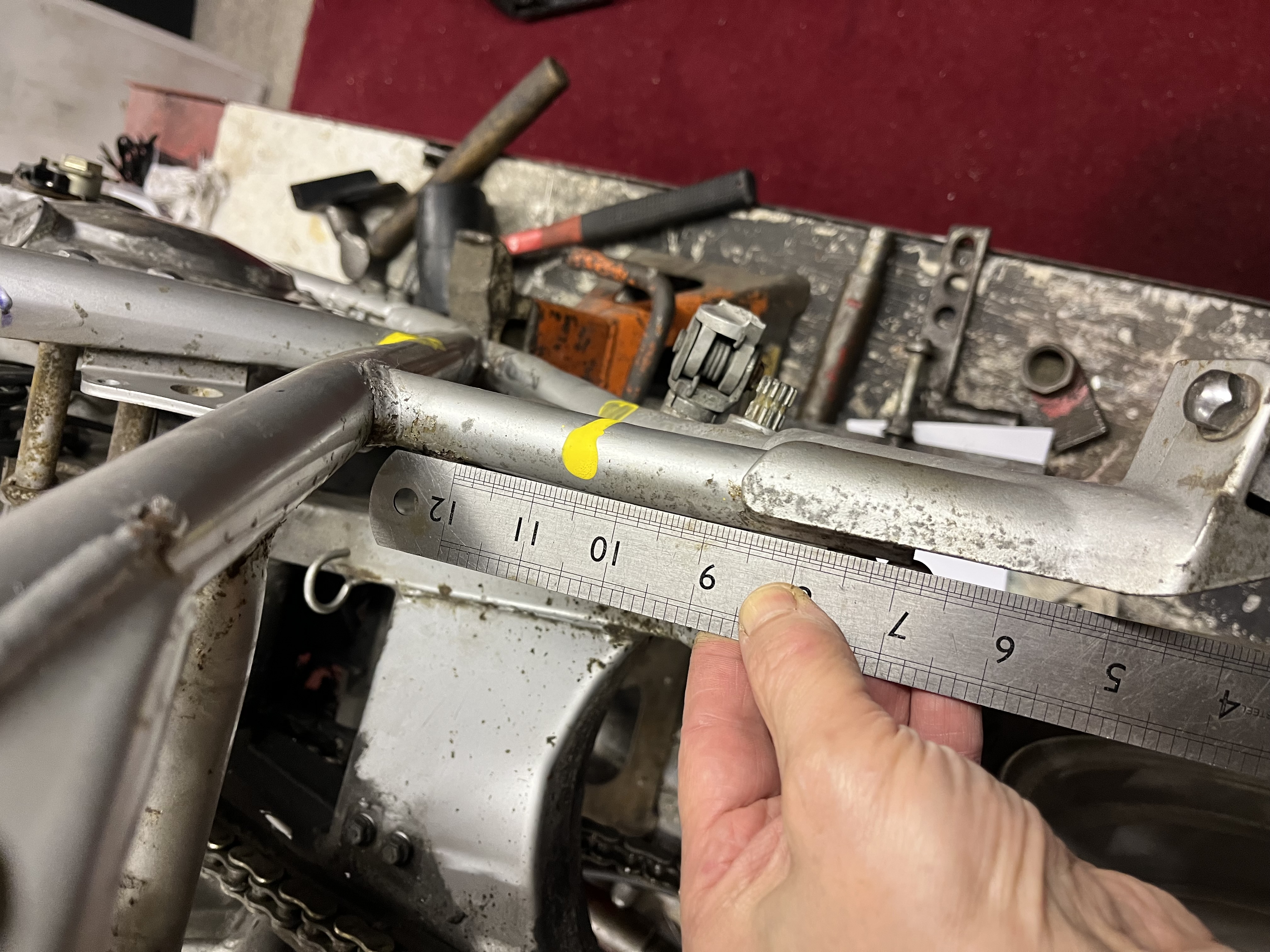

The other things are the foot rest frames, ones concave in a fashion and the other is convex. Can someone just do a visual check on their own to see if they are perfectly straight or have a gentle curve and if curved which way? Cheers for that.

Yes I still need them. Is there any chance you can take pics of the rear foot rest hangers from lots of angles as I think they have a specific ’slope’ in their style as they stretch from the main frame outwards? Cheers and yes I should have said 250 but I presumed it was the same as a 400 as it’s in this ‘water sword’ section of bikes.

Anyway I’ve got my frame nearly symmetrical and there’s still a few minor things to tweak. I removed the rear foot rest ‘triangles’ as they were very damaged and I’ll repair and refit but still needing a few bits of information regarding the exact distance apart they stick out out from the main frame. If anyone can tell me the bolt hole centre distance between the rest mounts that would help?
