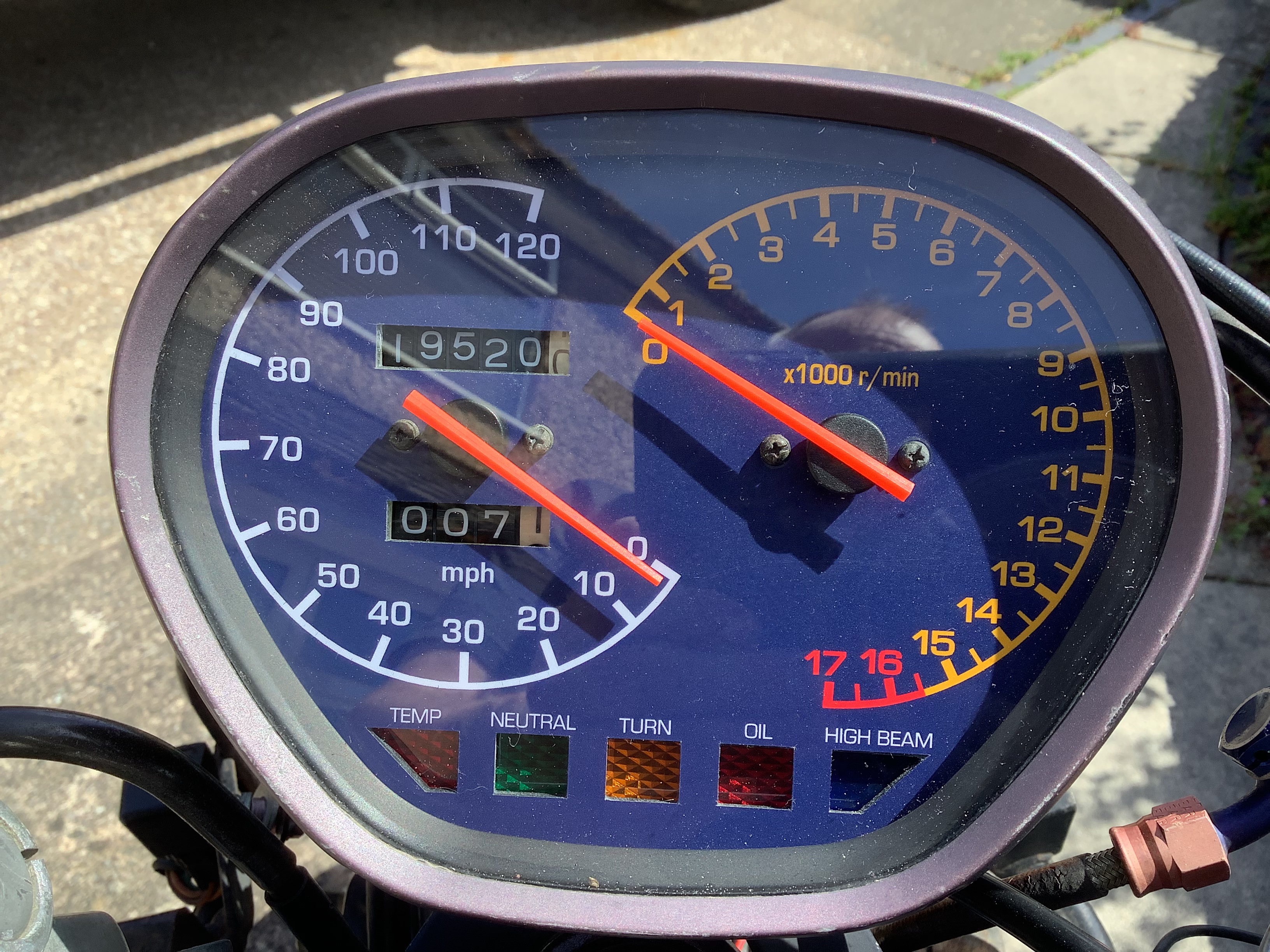

Thanks for advice, you’re right about the sound. I changed my speedo with an overlay to mph😁 Mileage still reads kph though. Had to replace the needles as well.

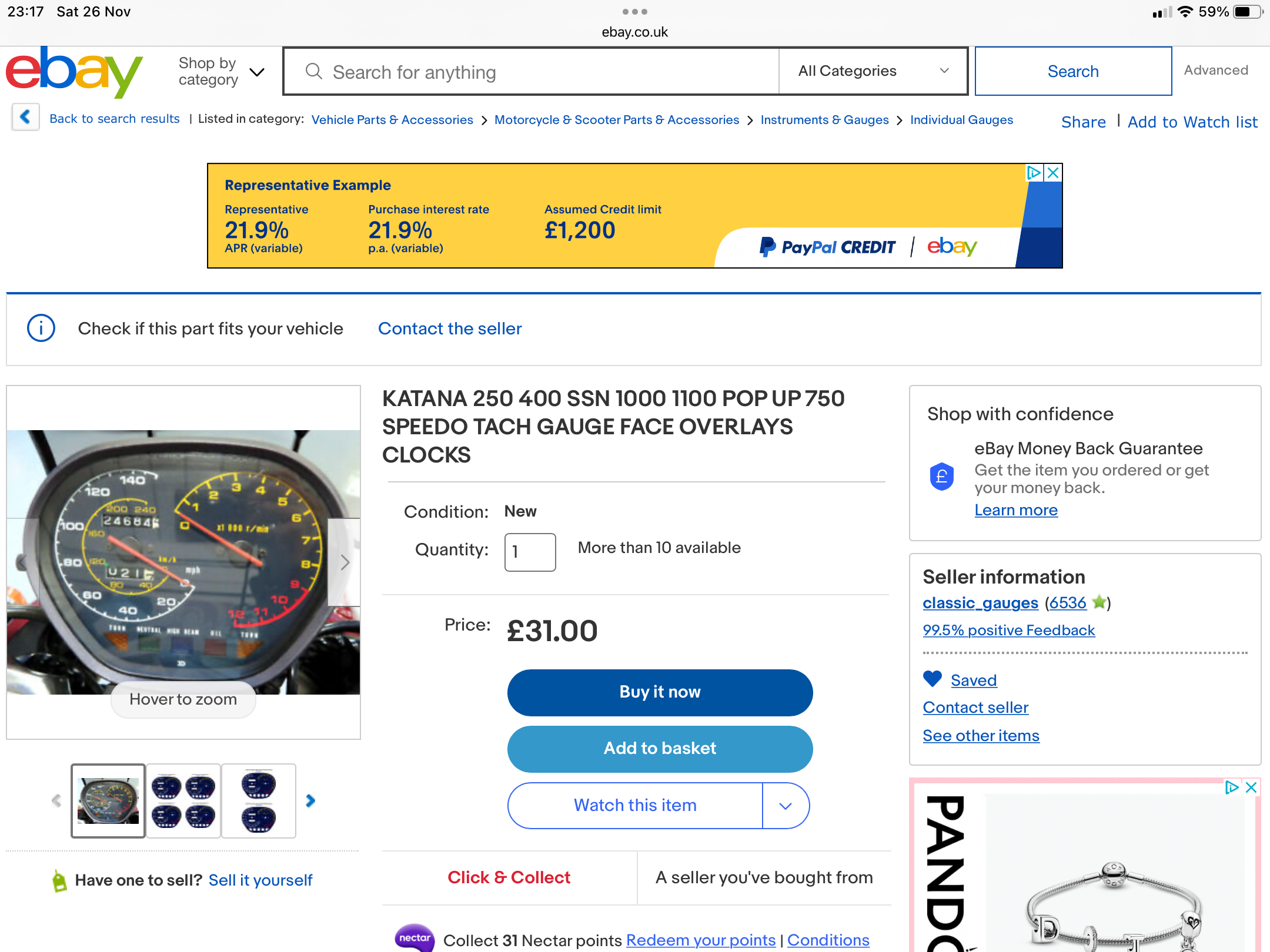

Very smart Tonycat. The inevitable question, where did you get that overlay from... and cost please. As mine is still in kit form from my recent wrestling match I'm taking time to touch up the gnarly bits and that will tidy up the speedo unit 100%.

This is the overlay I used 👍

I'd love that overlay and new needles on Smallkat, but I'm frightened of f**king it up. I'm not going to find another instrument set anytime soon.

On a 400 there no need to bother ;) in top 3000 Rev is 30 mph , 4000 is 40 mph etc it won't go over 112 mph anyway as the black box will shut the power until it's back below for a measured distance ...Japanese legislation. . ;)
The assist option is the inline convertor the screws to the rear of speedo in the cable , used to in abundance , but still getter able , ( I have one for trying / reference ) you need the blue not black .

However we have had people but mainly one in recent memory who had a kph speedo and fitted this mph over lay , it read out by a large amount really . The reason is just swapping the clock face won't alter the gearing in the speedo unit It's self , the amount of turns the wheel goes to the amount of turns the cogs turn ....mph clock and kph clocks are different .
The person whom I'm referencing ended up using a blue convertor , the obvious downside is only the first part of the speedo is used .. ;)
Maybe this has been addressed and the spacing is suitable , but I fail to see if the trip meter/ odometer is in kph and these spacing so look like original that it anywhere near actuate .

Thanks Tony, ordered one up.
