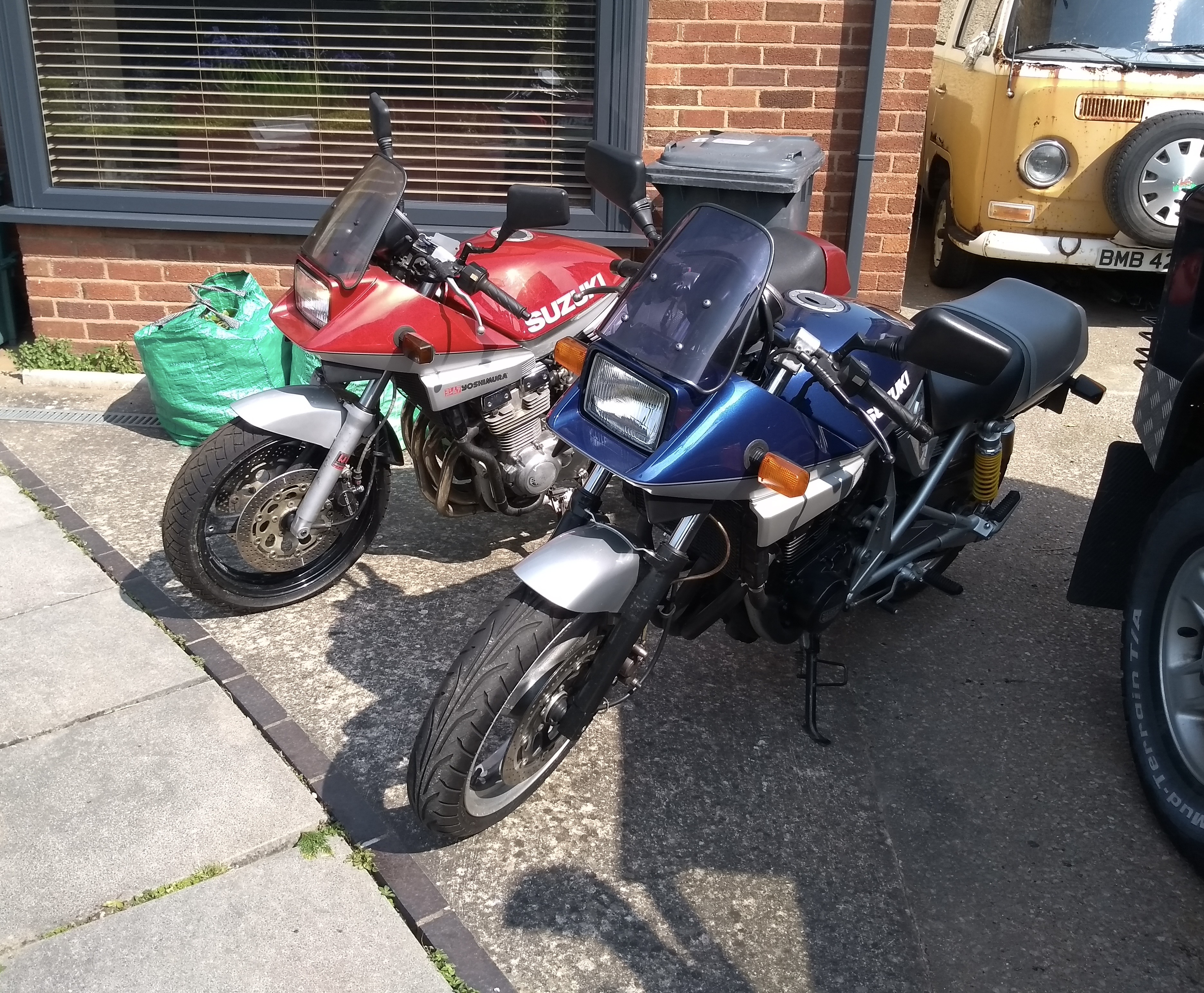

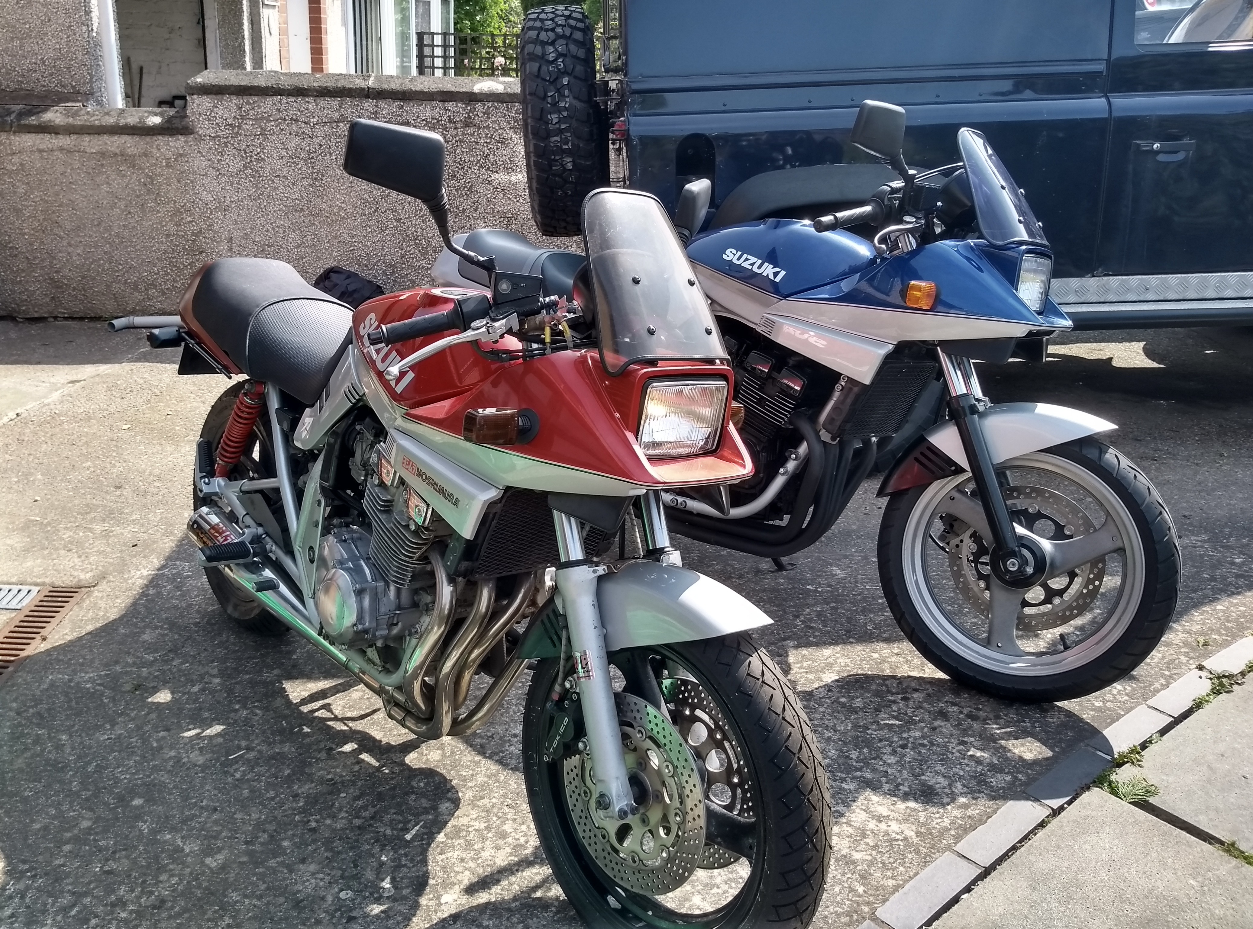

Love both of those paint schemes and coveting that Yoshi.
