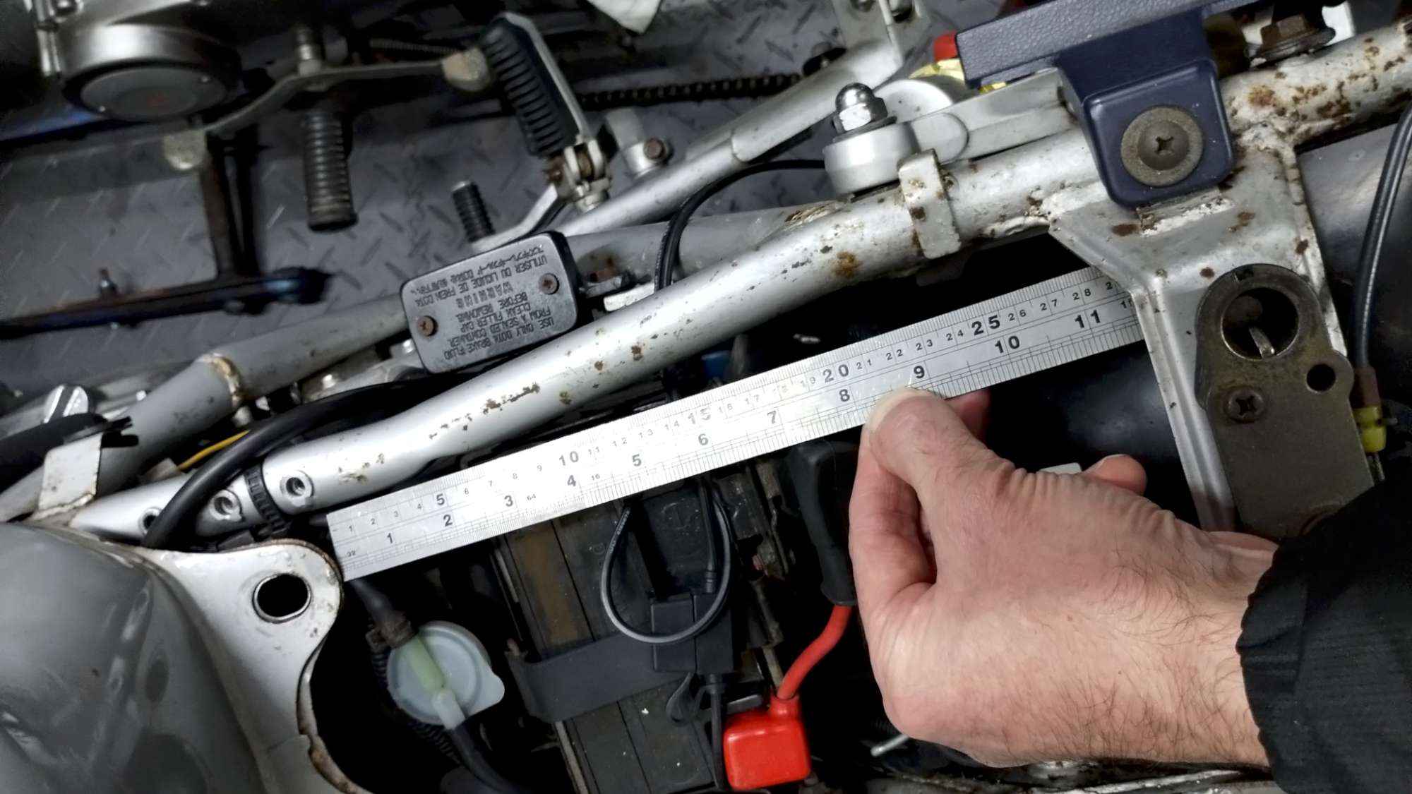

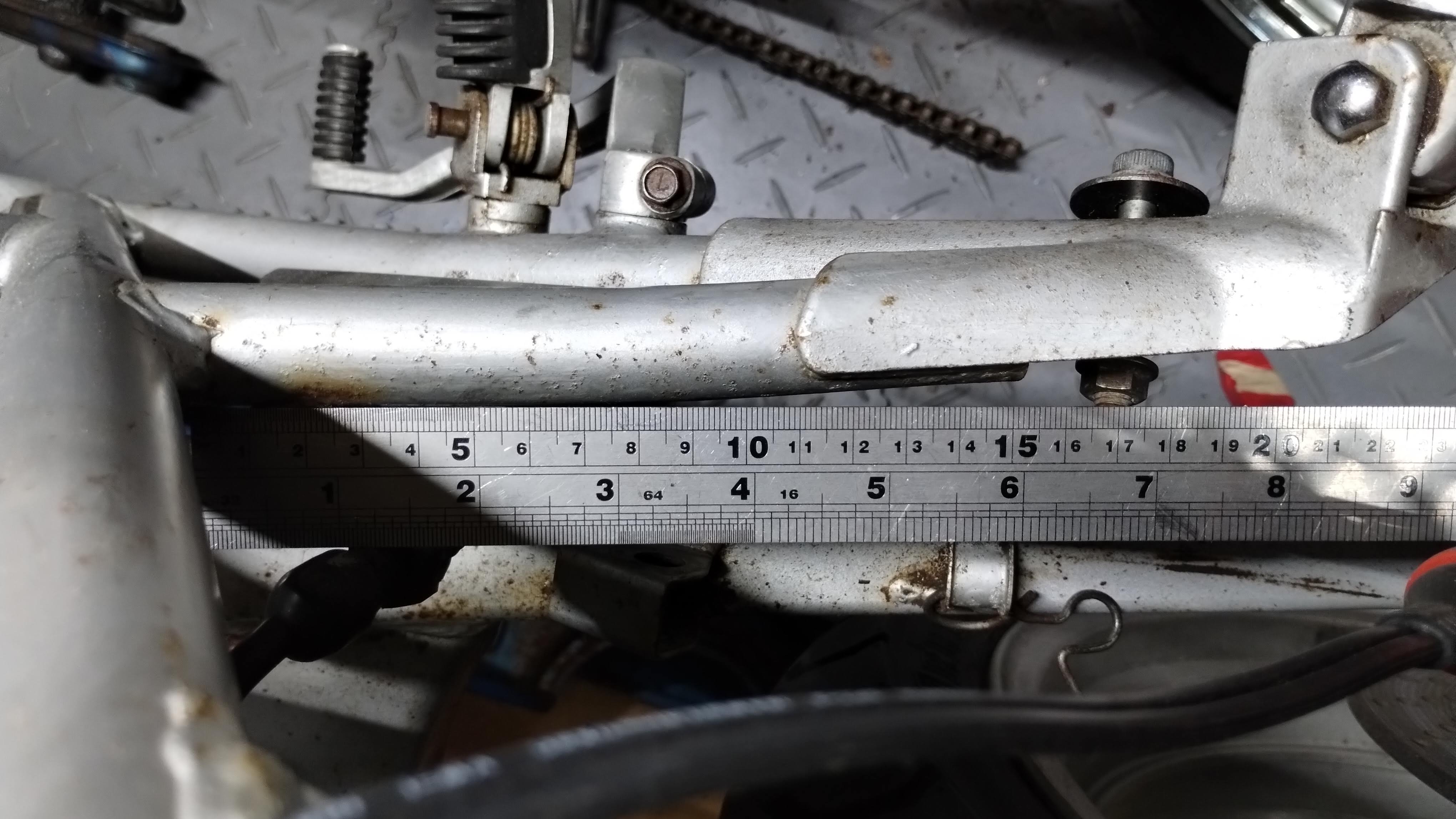

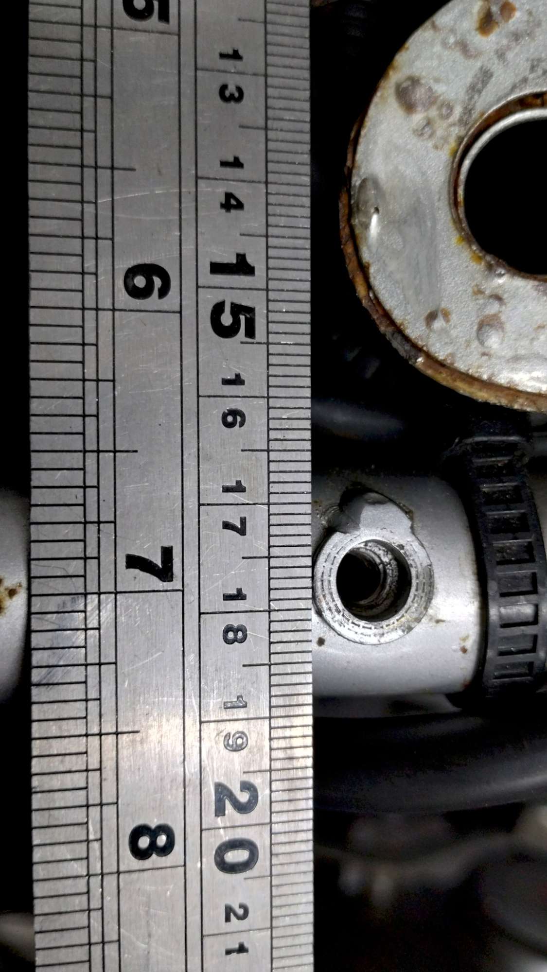

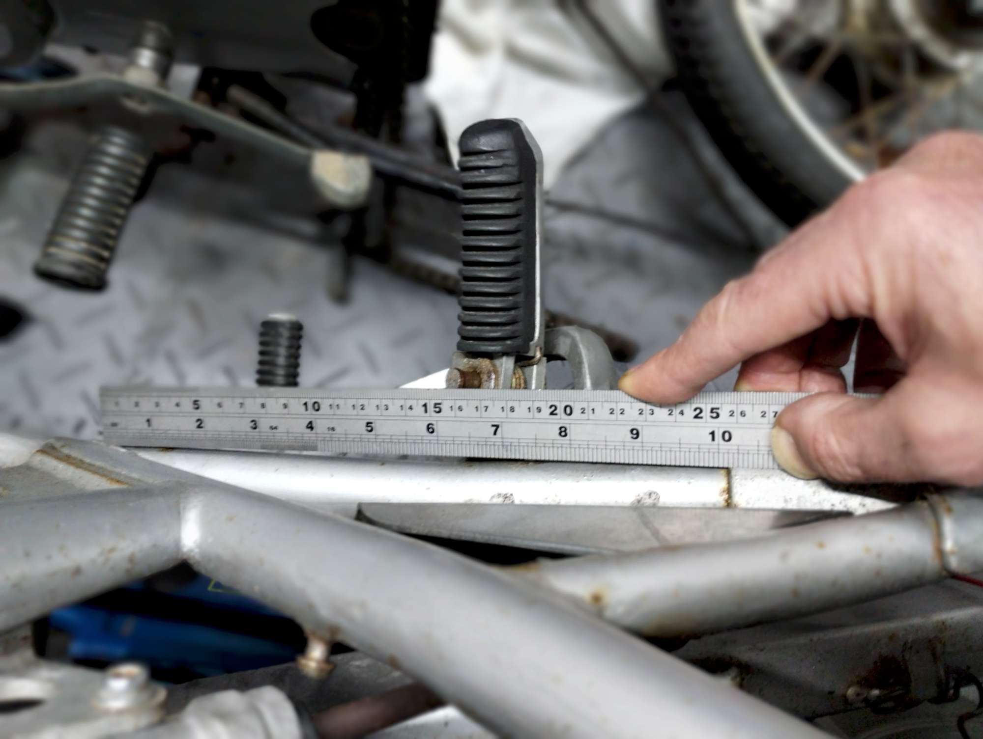

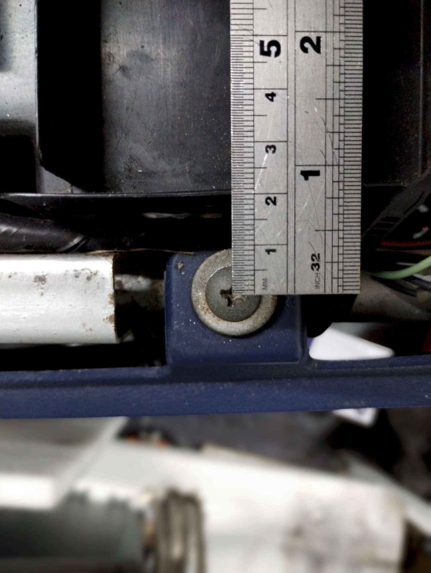

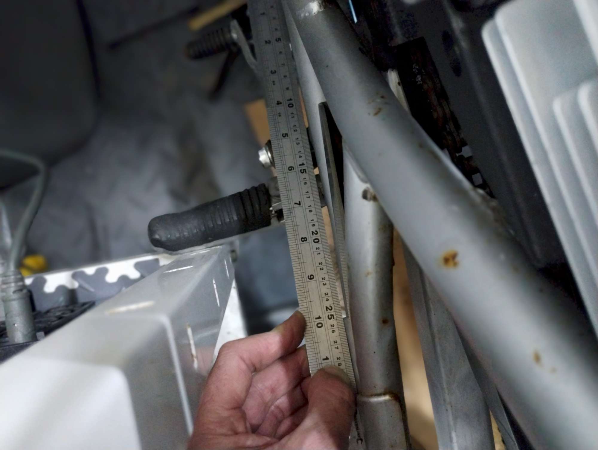

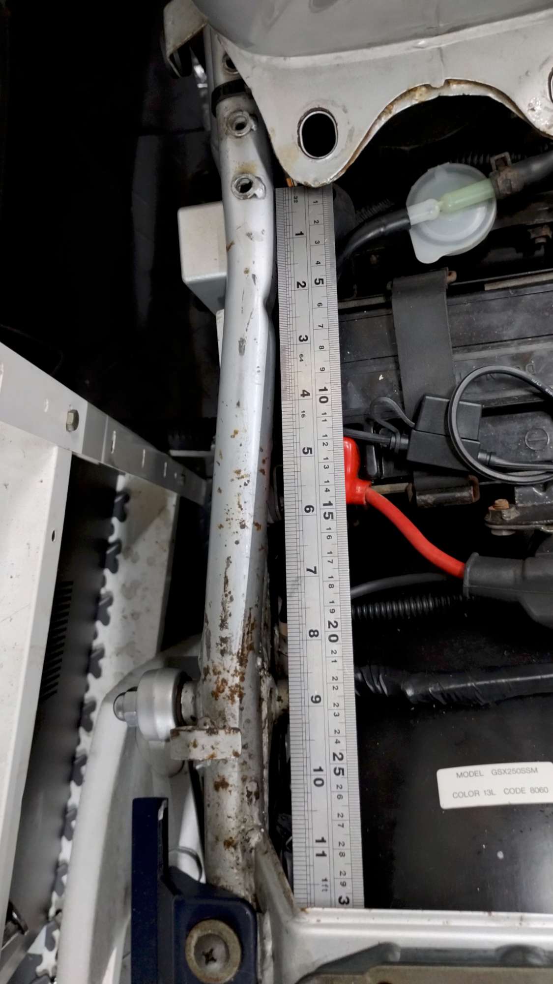

Post by Uncle Bob » Mon Nov 20, 2023 8:35 pm

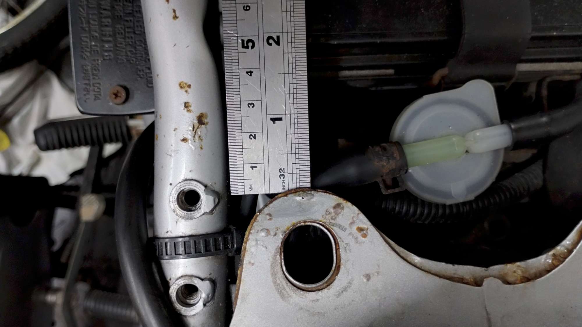

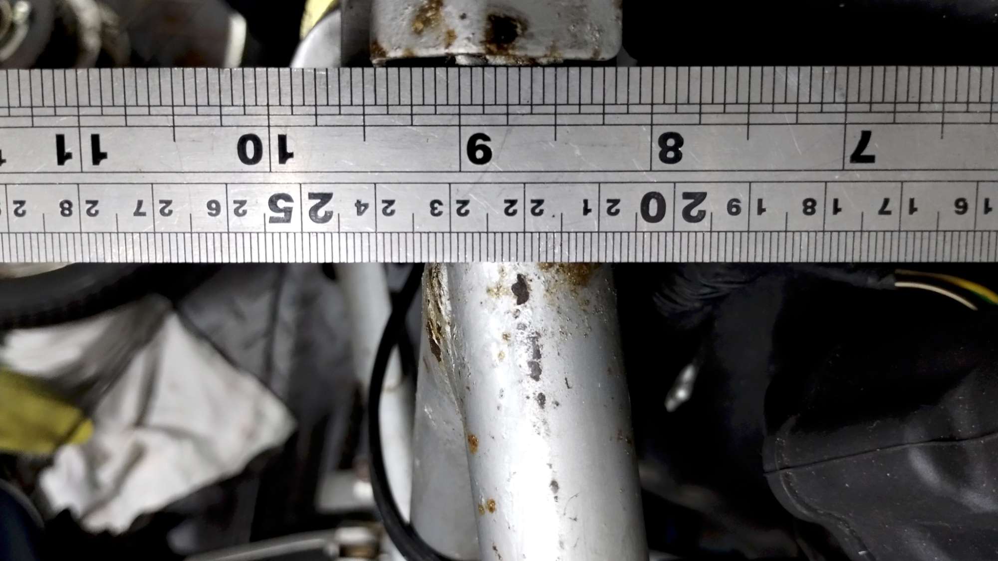

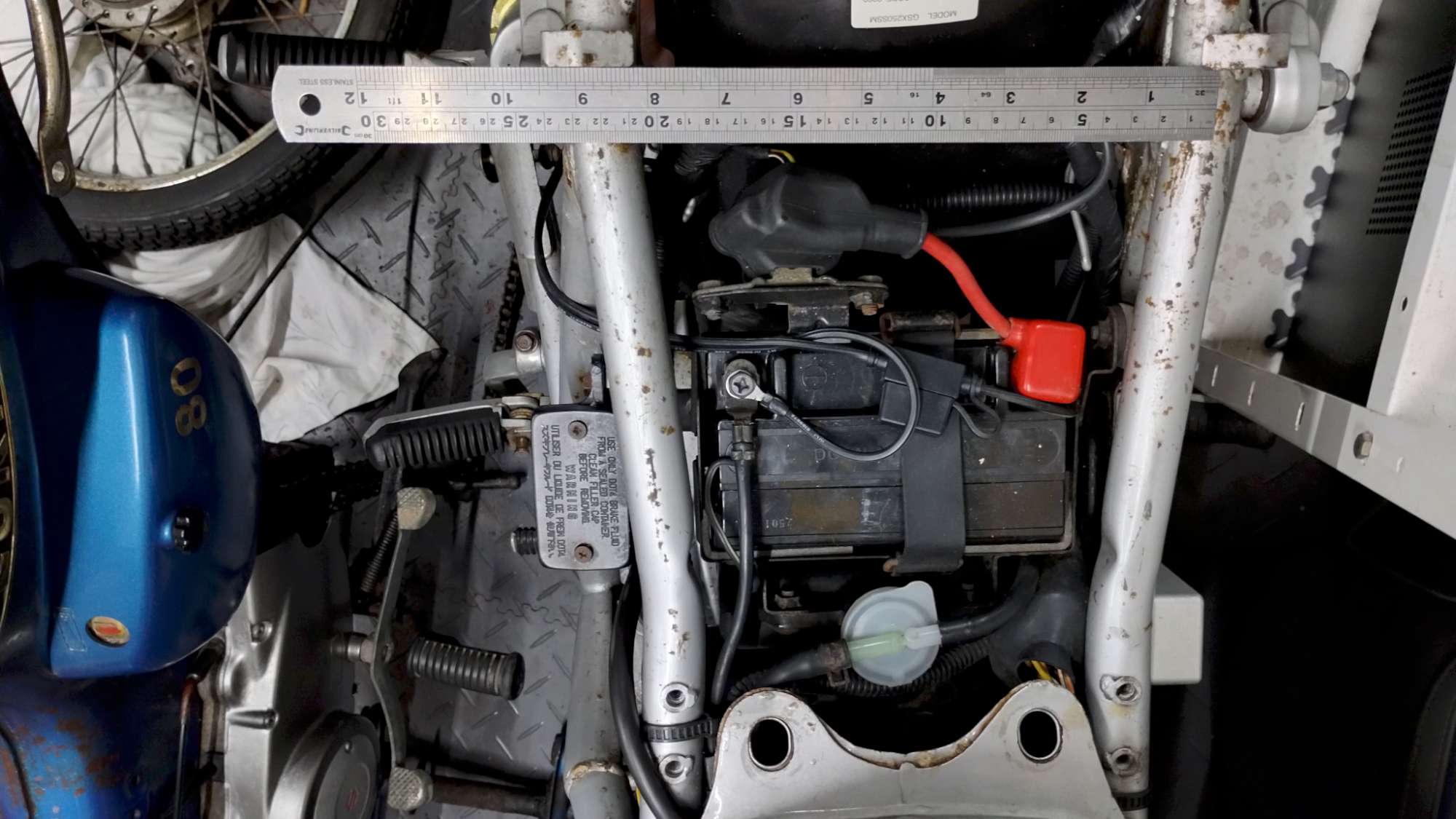

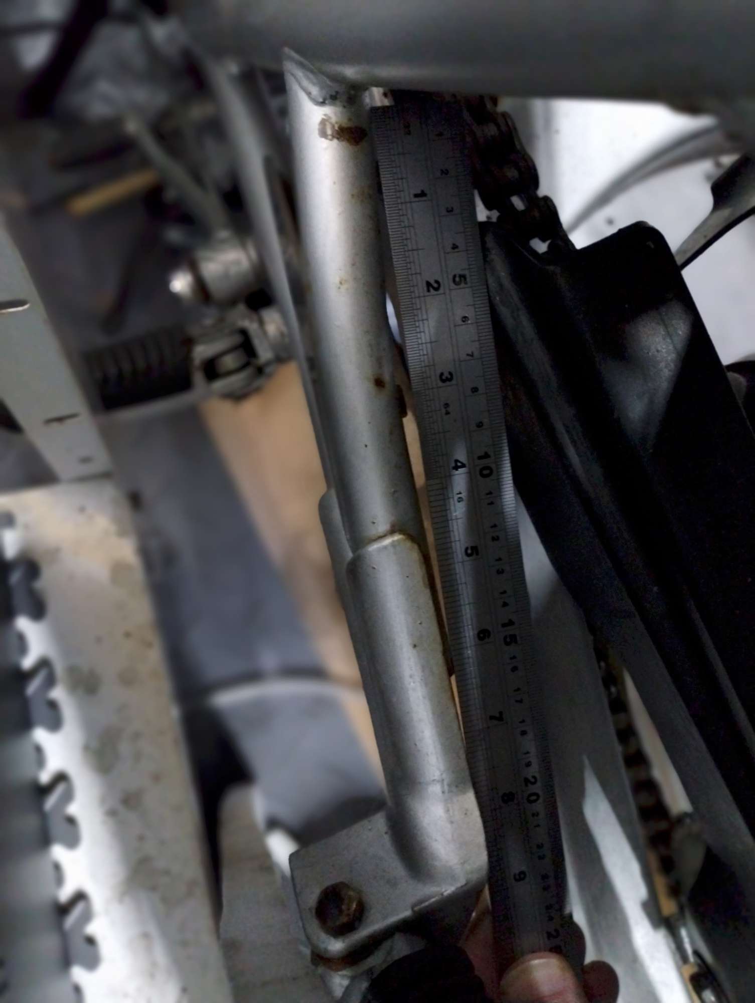

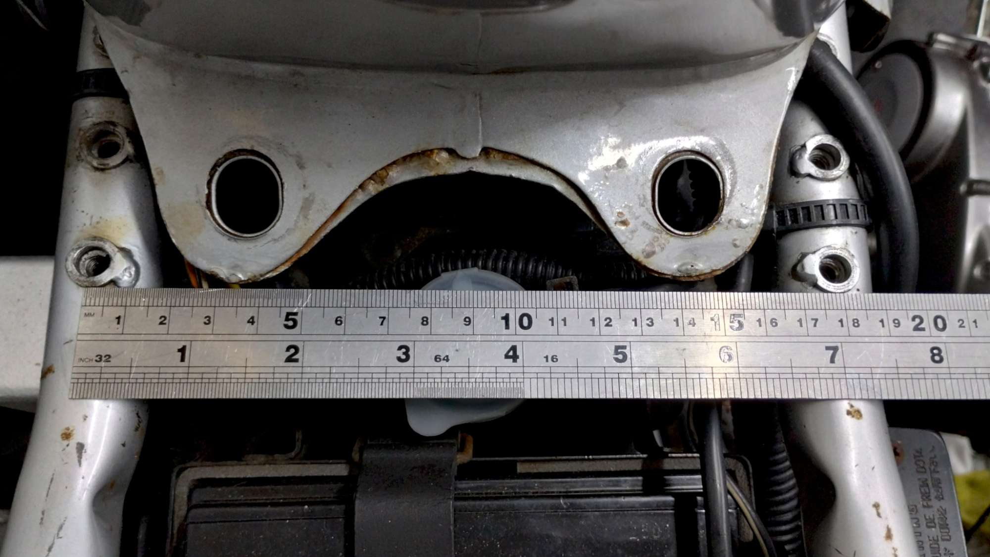

Finally managed to uncover the 250. I couldn't move it so left foot rest harder to do as against the wall.

Post by tigcraft » Mon Nov 20, 2023 11:18 pm

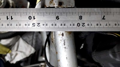

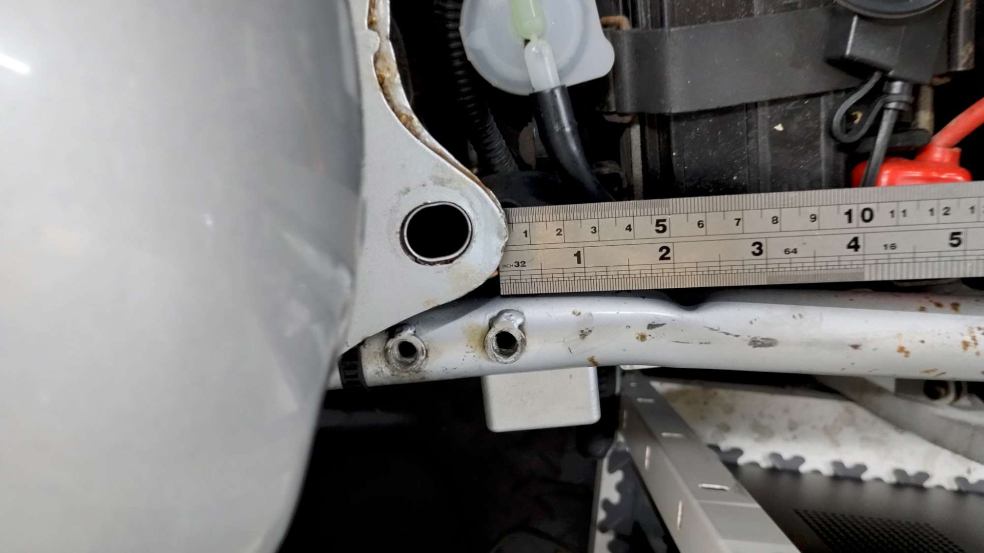

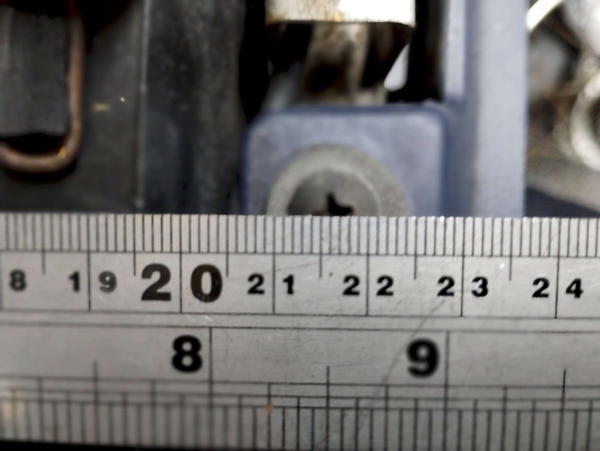

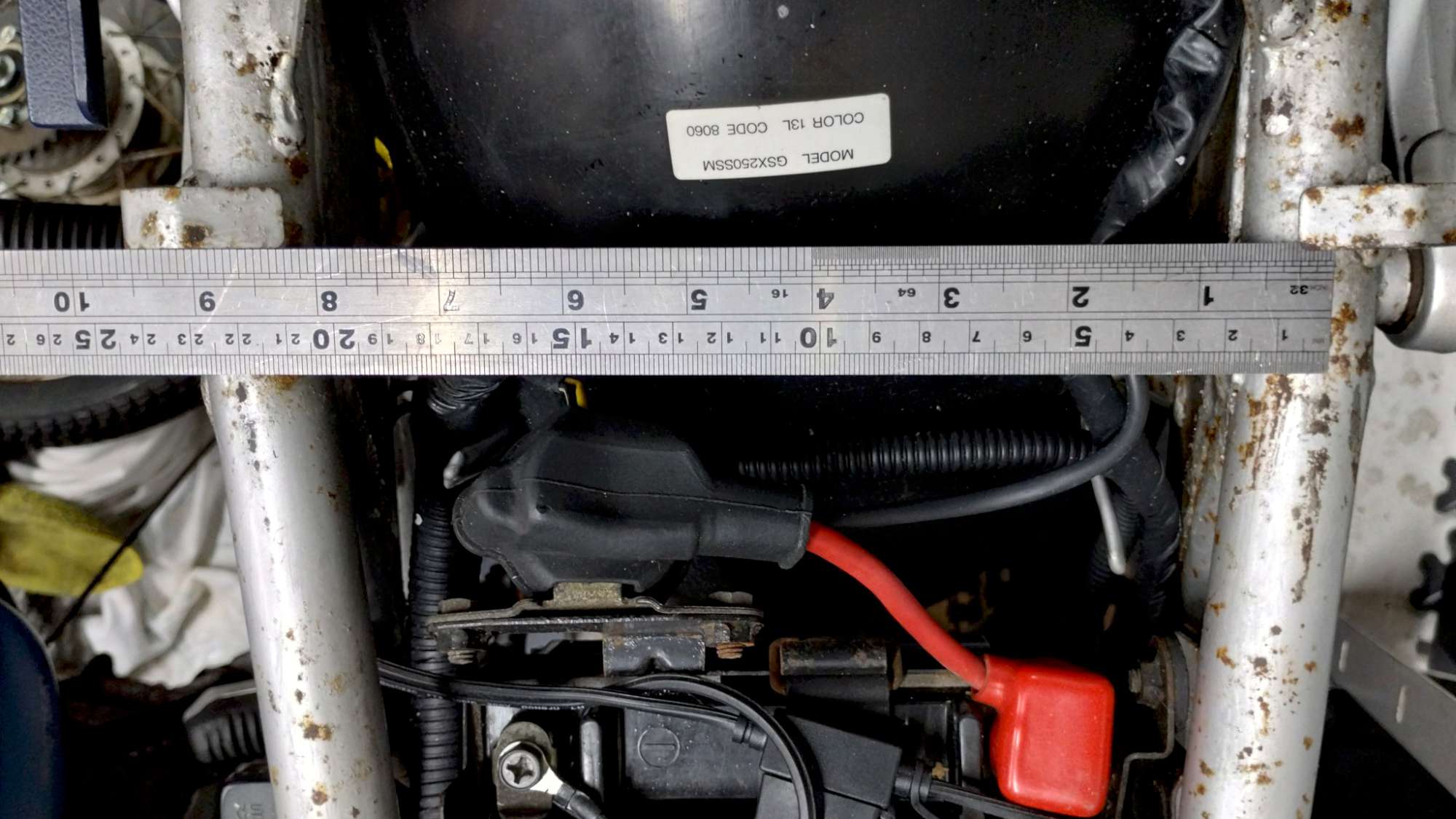

Wow thank you for the help. There’s a fair few important information ares in there just on the picture even using a straight edge without measurements. Let me process it and I’ll see where I am. Eric

Post by tigcraft » Mon Nov 20, 2023 11:28 pm
First thing I’ve noticed is the foot rest frame triangles, LHS upper tube is a gentle convex whilst lower which holds the gear leaver mount is flat. Over to the RHS the upper triangular tube is concave slightly therefore doesn’t match. The lower RHS is concave too ever so slightly as that can only be answered by saying it’s had pressure on the footrest from a gentle fall. It’s valuable infor!!

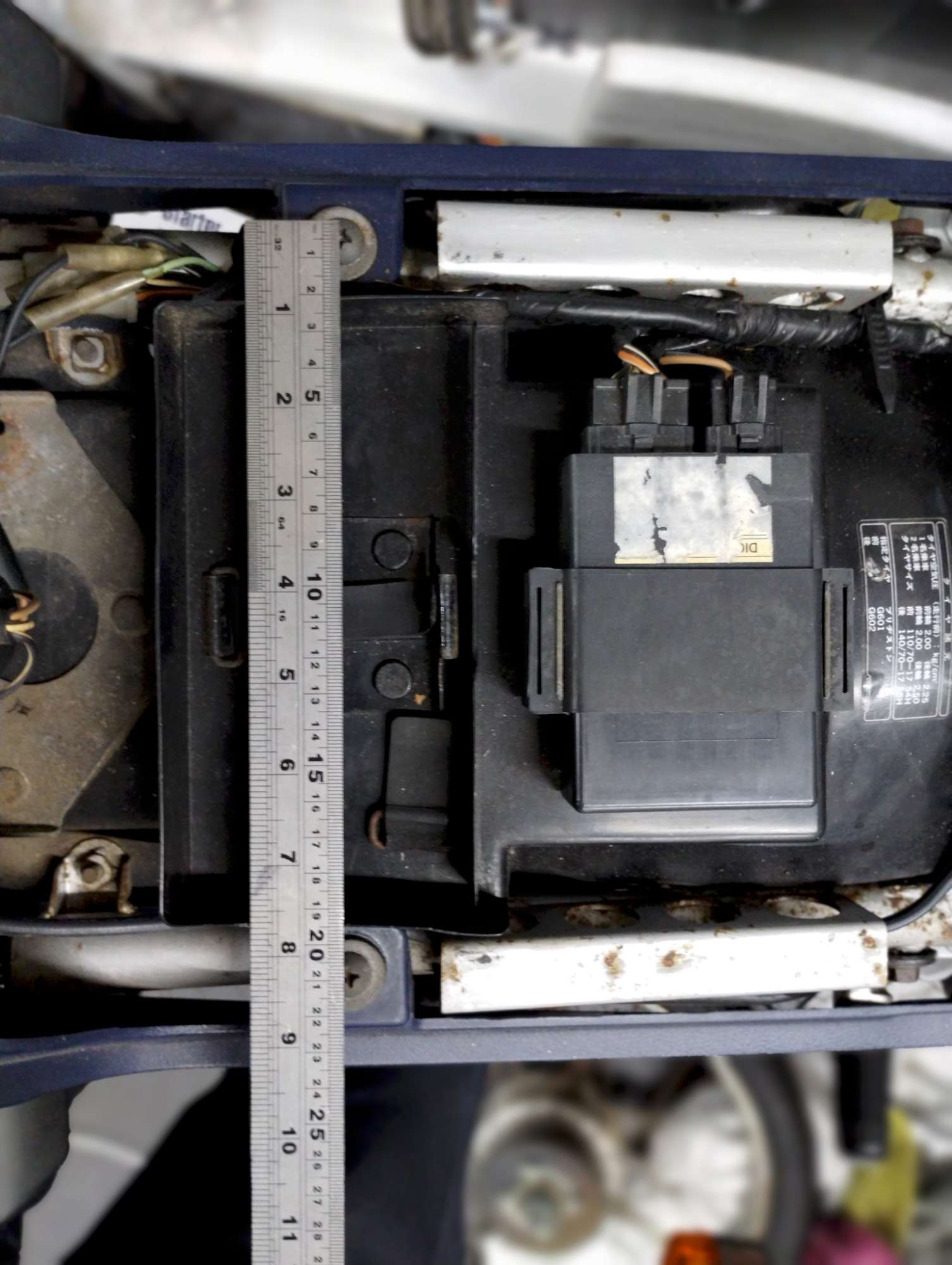

Post by Uncle Bob » Tue Nov 21, 2023 8:23 am
Sorry this was missing from above as phone didn't automatically copy it over...

Re: Frame repair……..
Post by fossie » Tue Nov 21, 2023 8:40 am
Could the RHS concave be due to the original exhaust shape/locating..obviously not obvious if you havean aftermarket Yoshi fitted.

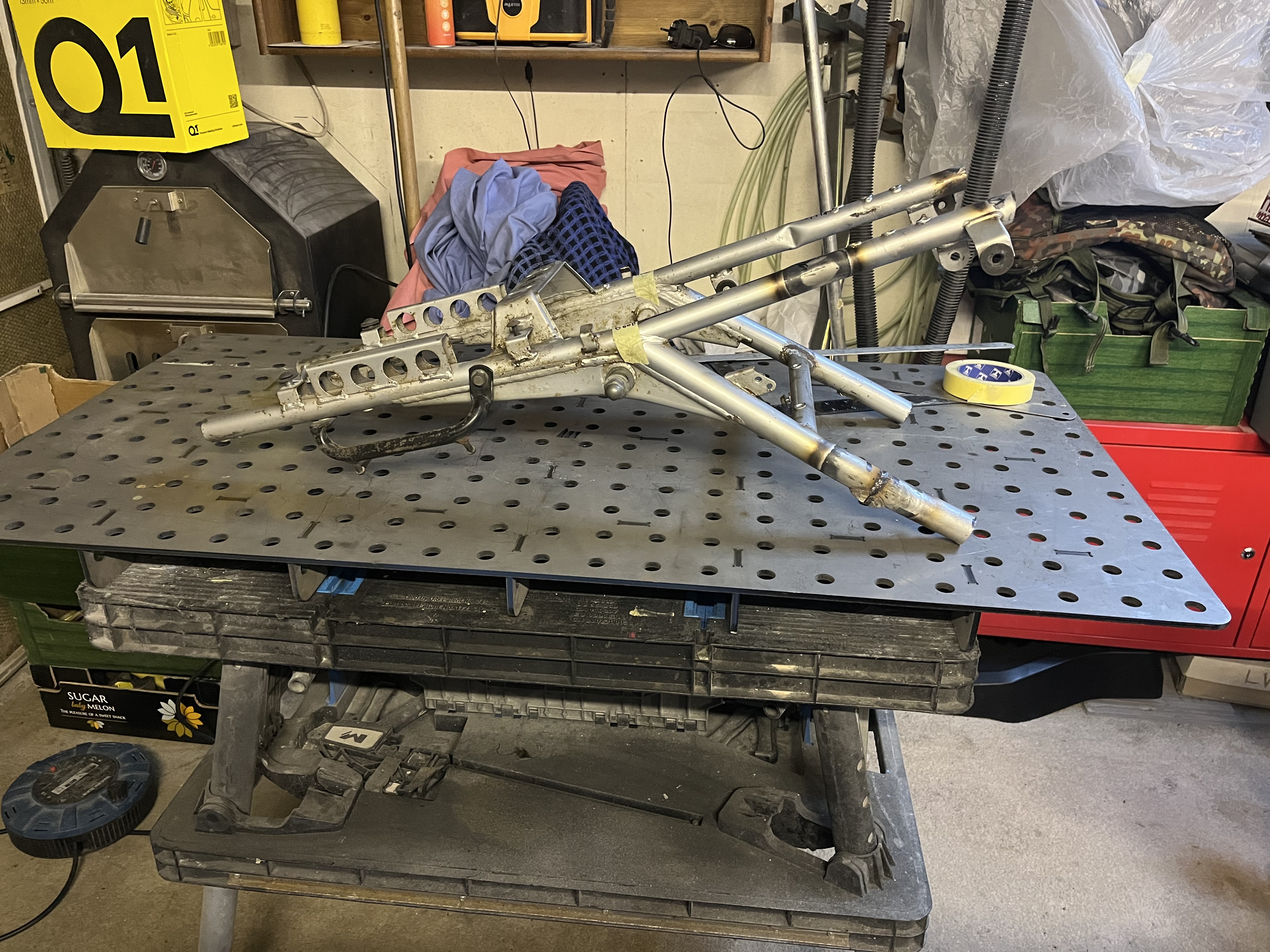

Post by tigcraft » Tue Nov 28, 2023 6:48 pm
I decided the easiest way to sort this thing is to lob the back subframe off and straighten it on my welders table jig.
