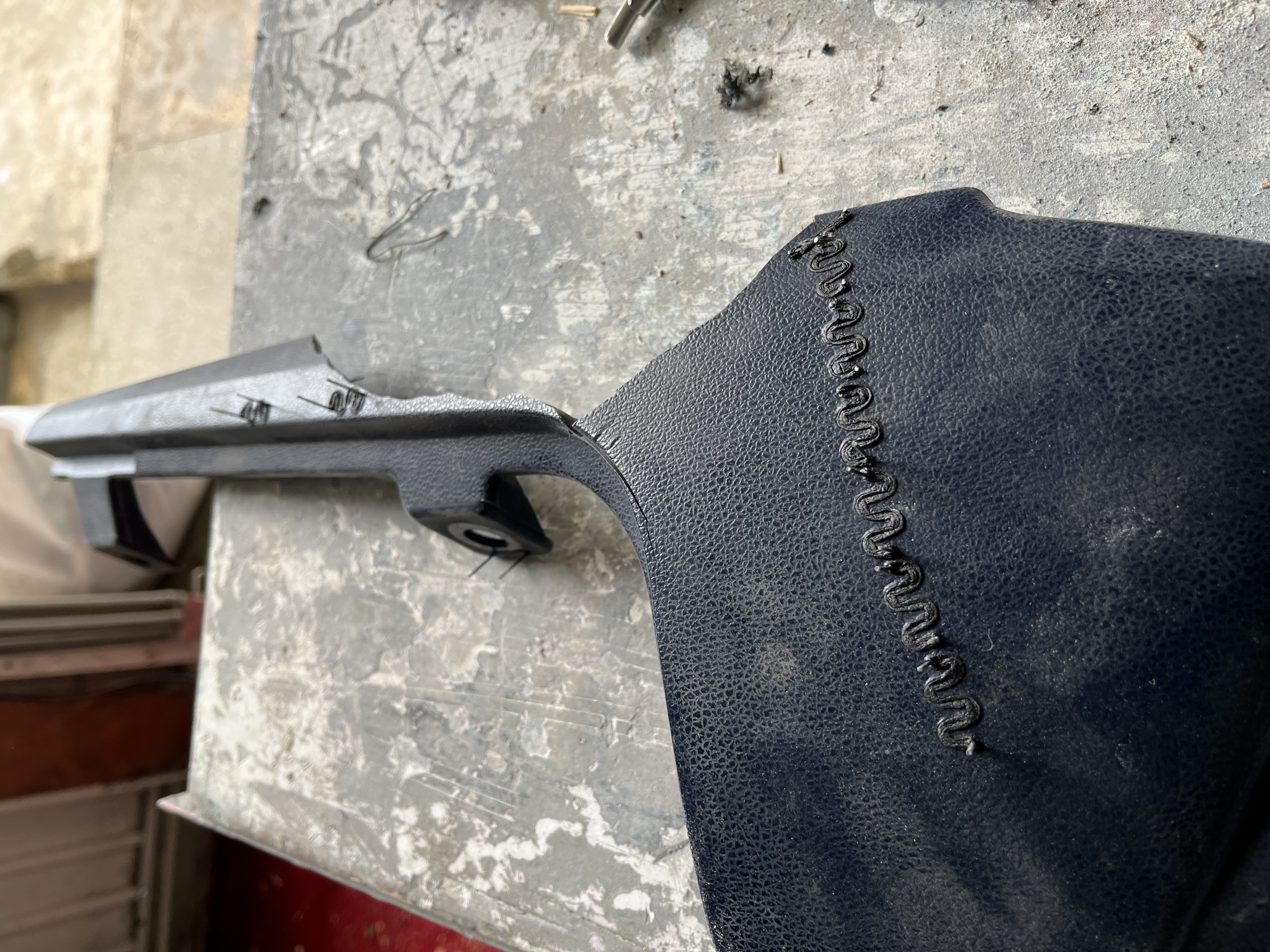

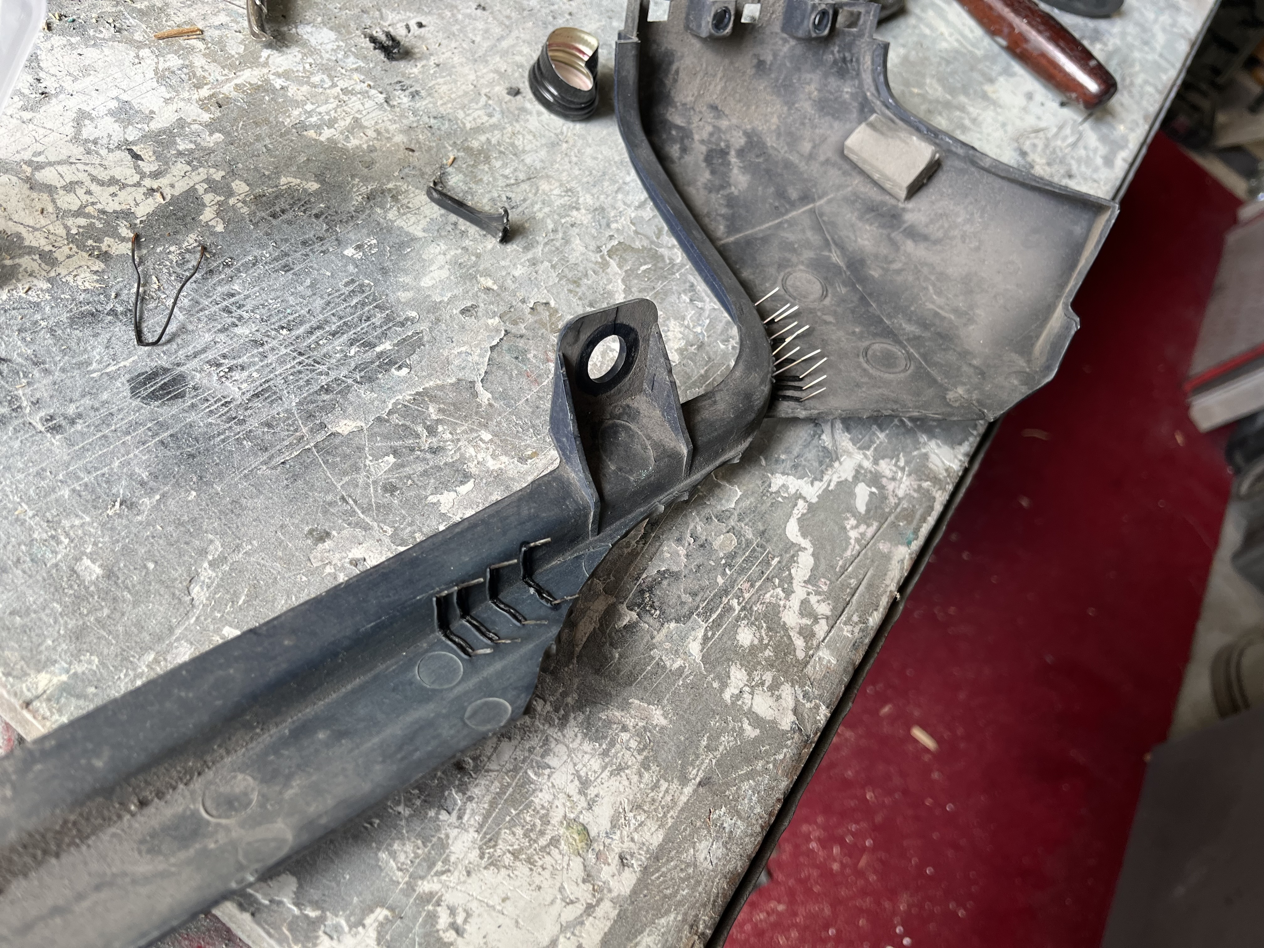

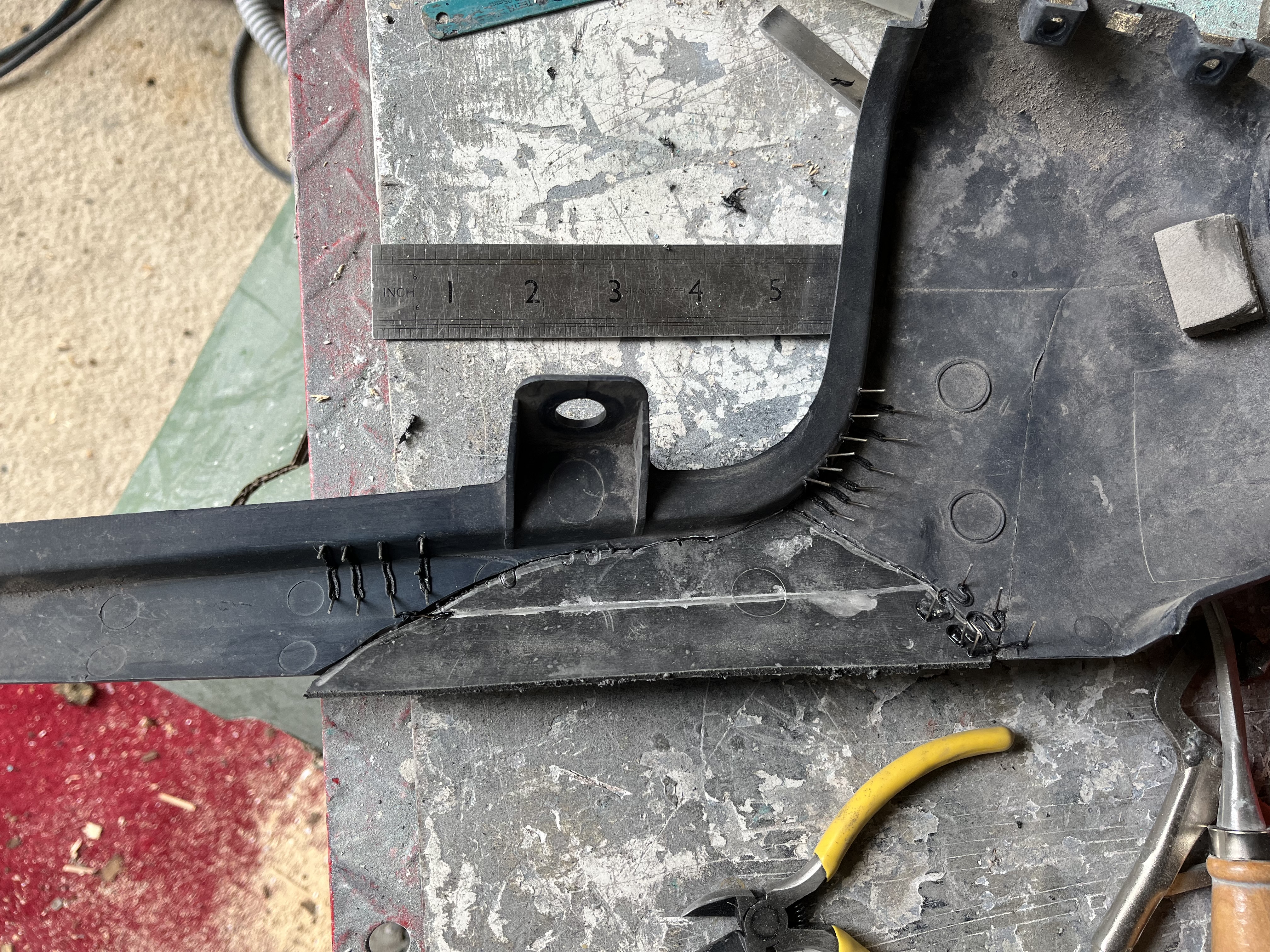

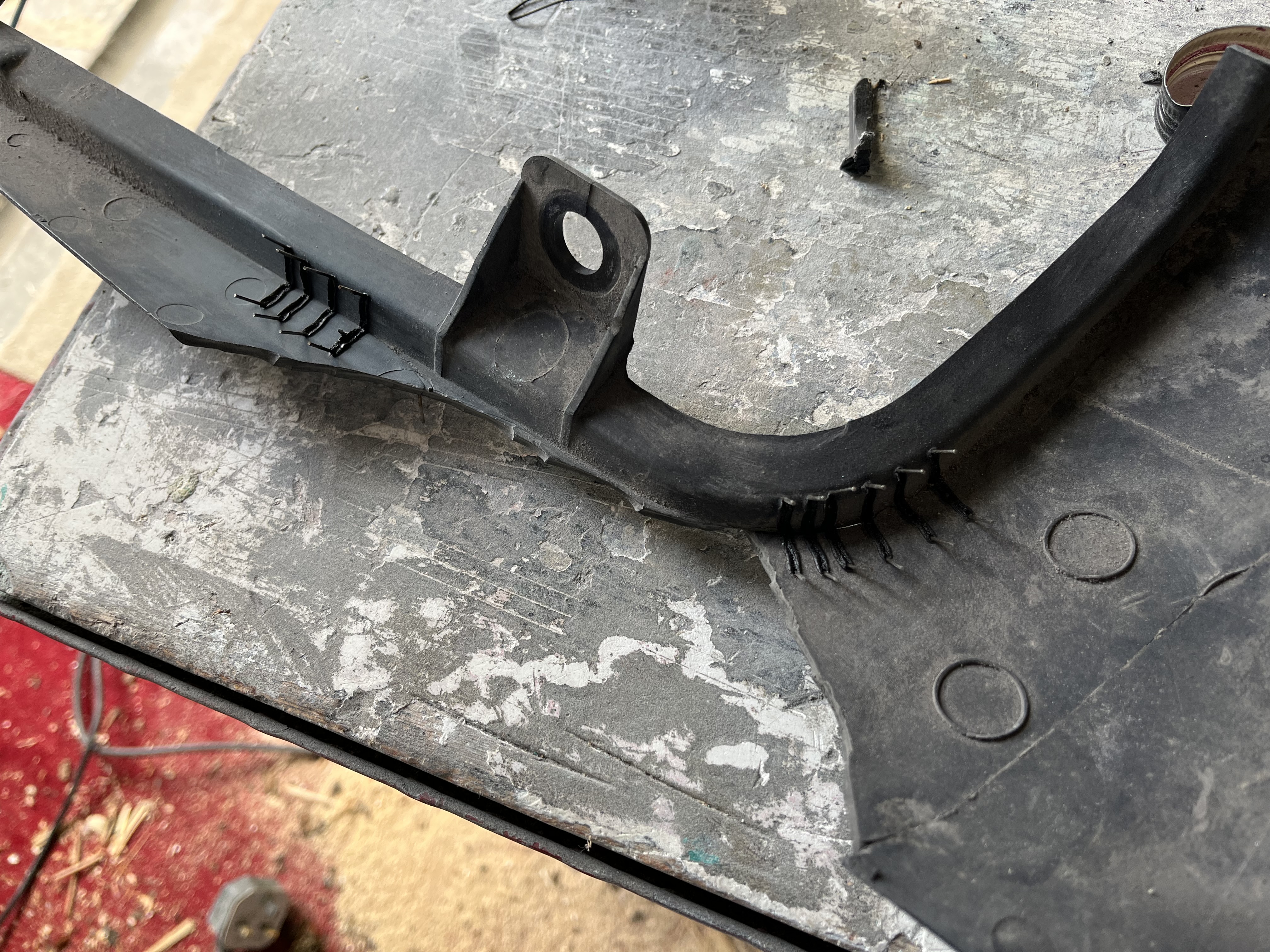

Can’t find a decent side section to replace my damaged seat pod so it’s a repair job. Massive lump of plastic missing so just made it up out of off cuts of my damaged rear mudguard. I decided I hate the blue fake texture so it’s just as well. It’ll go tank colour.

Re: Fixing time!
I used those "hot" staples the other month for the first time on the airbox of my X7. Seemed to work well. I did cover in JB Weld afterwards as well!
