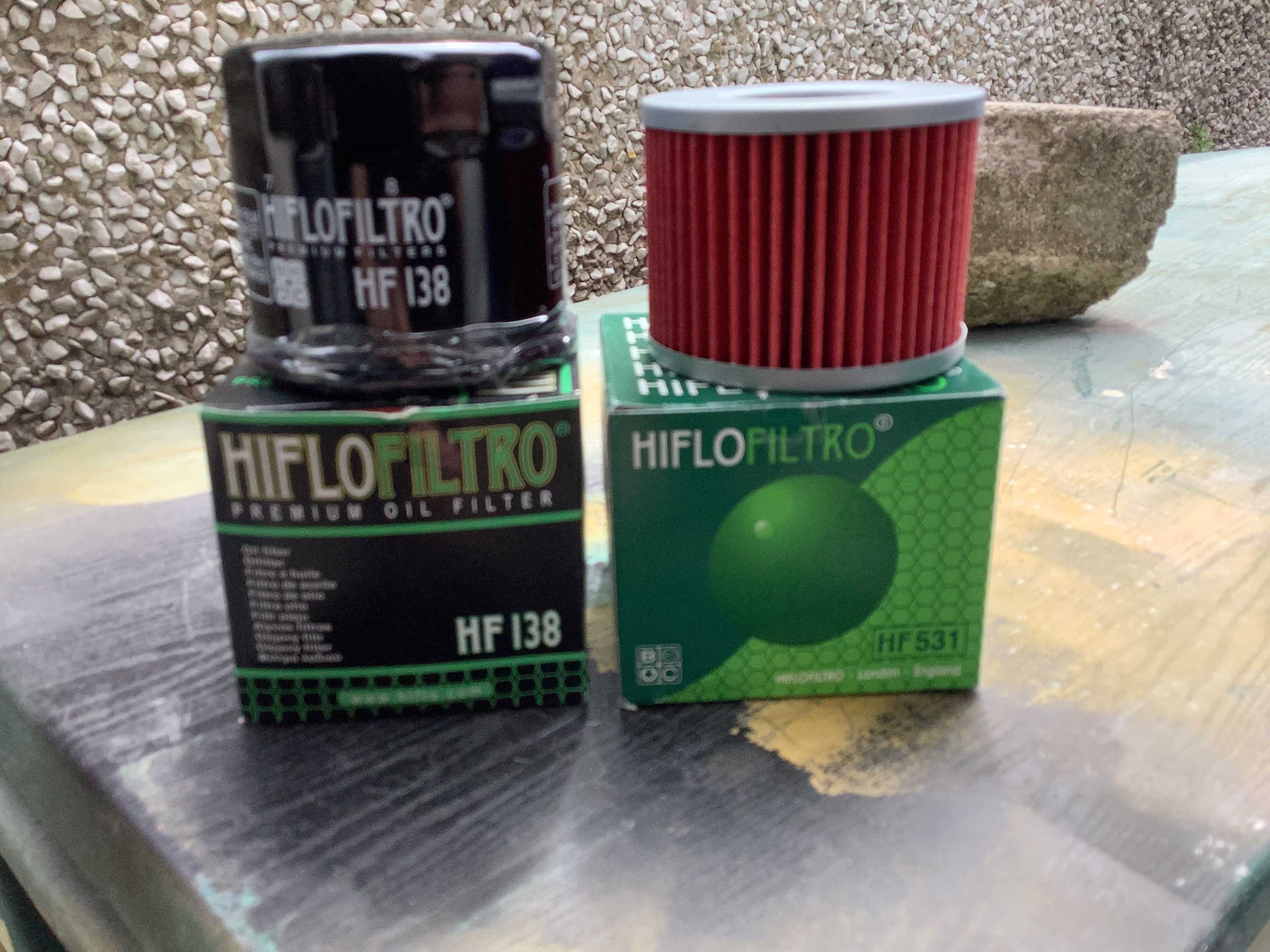

Hi Fossie, I did get oil filters for the 250 and the 400 from Wemoto, are these correct?
Posts: 506
Re: Oil in air filter
Post by pookie » Fri Jul 29, 2022 9:49 pm
HF531 is the correct oil filter for the 250 Kat 8-)
Posts: 5205
Post by fossie » Fri Jul 29, 2022 11:59 pm
Anyway does anyone want any of these filters before they get moved onto the open market. :) ;)
