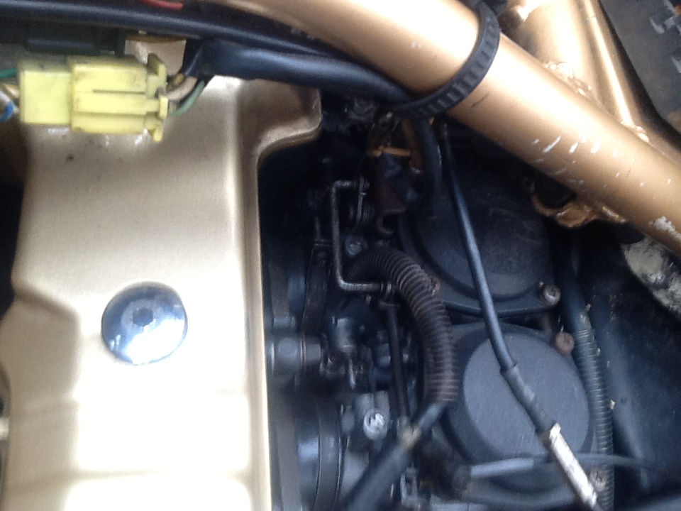

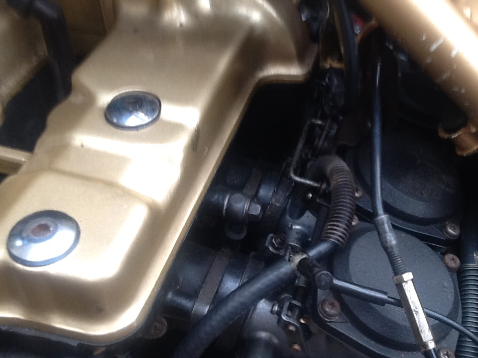

Post by Berti44 » Sun Apr 02, 2023 1:47 pm
Is this the correct location? Fouling on the petcock

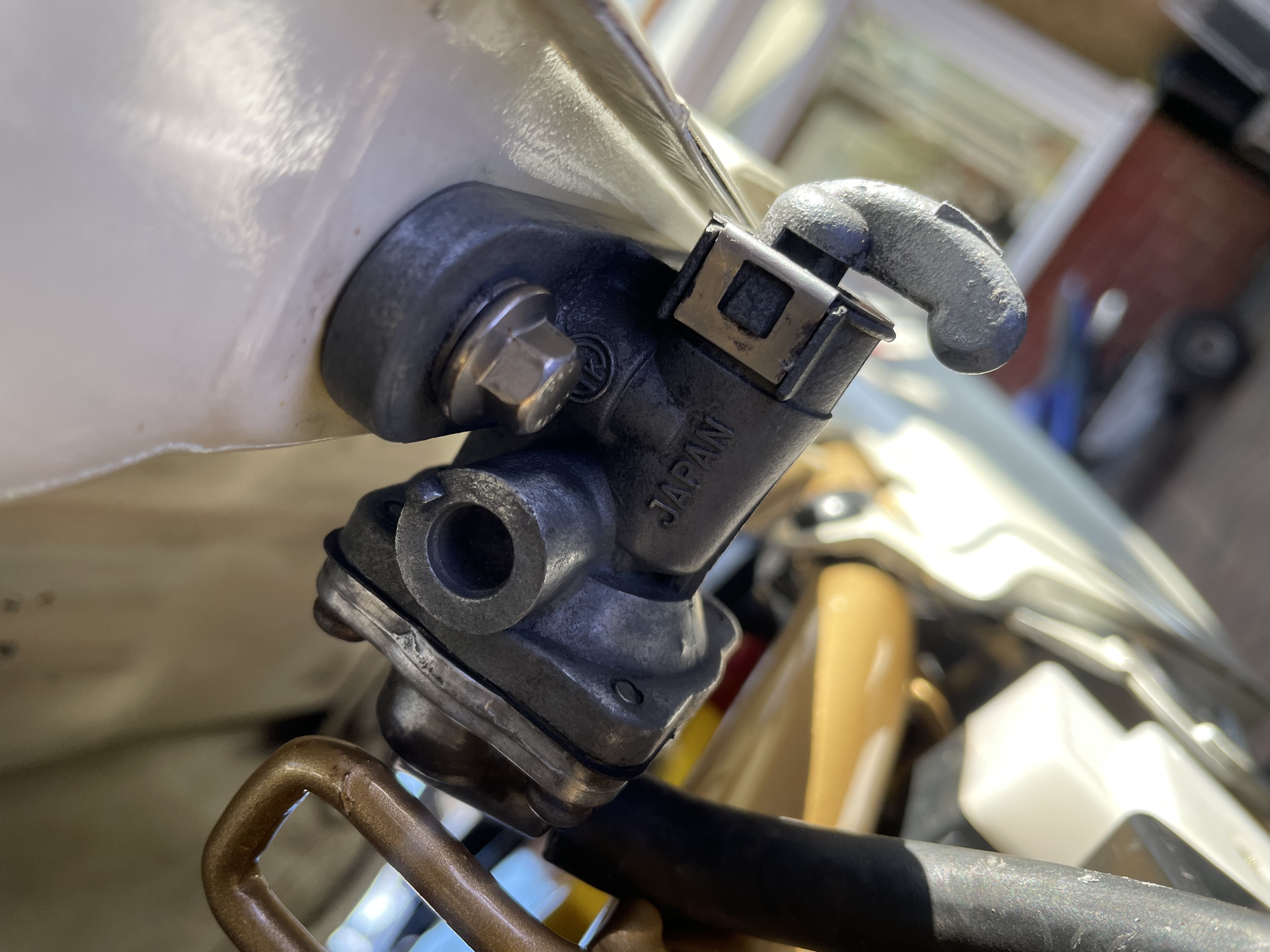

Post by Berti44 » Sun Apr 02, 2023 1:53 pm
Is the petcock right?

Re: Choke bracket location
Post by Berti44 » Sun Apr 02, 2023 2:31 pm
I’m guessing the choke bracket should be on the 2nd carb in?
Posts: 5205
Post by fossie » Sun Apr 02, 2023 3:05 pm
It goes on number 2 car with the gap between 2-3 if you get my drift.
Oh by the way we're British so it's a fuel tap! :D :D :D :D

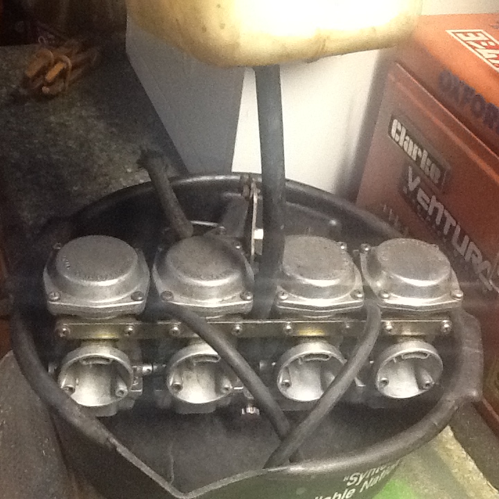

:idea: :? Now about this gap? Is that the space between carb 2 and 3 😳
Okay - I’m sat on the bike and the bracket fits to carb 2 👍 now I see a square top right hand corner is threaded hole one to 4 in a Clockwise direction. Where do I put the bolt. I’d guess hole two?

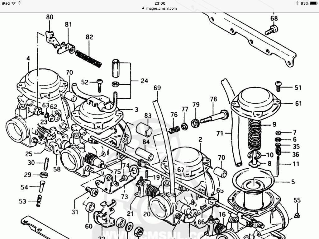

Post by fossie » Sun Apr 02, 2023 10:02 pm
Any help
Posts: 5205
Post by fossie » Mon Apr 03, 2023 2:05 pm
This any better ,,
