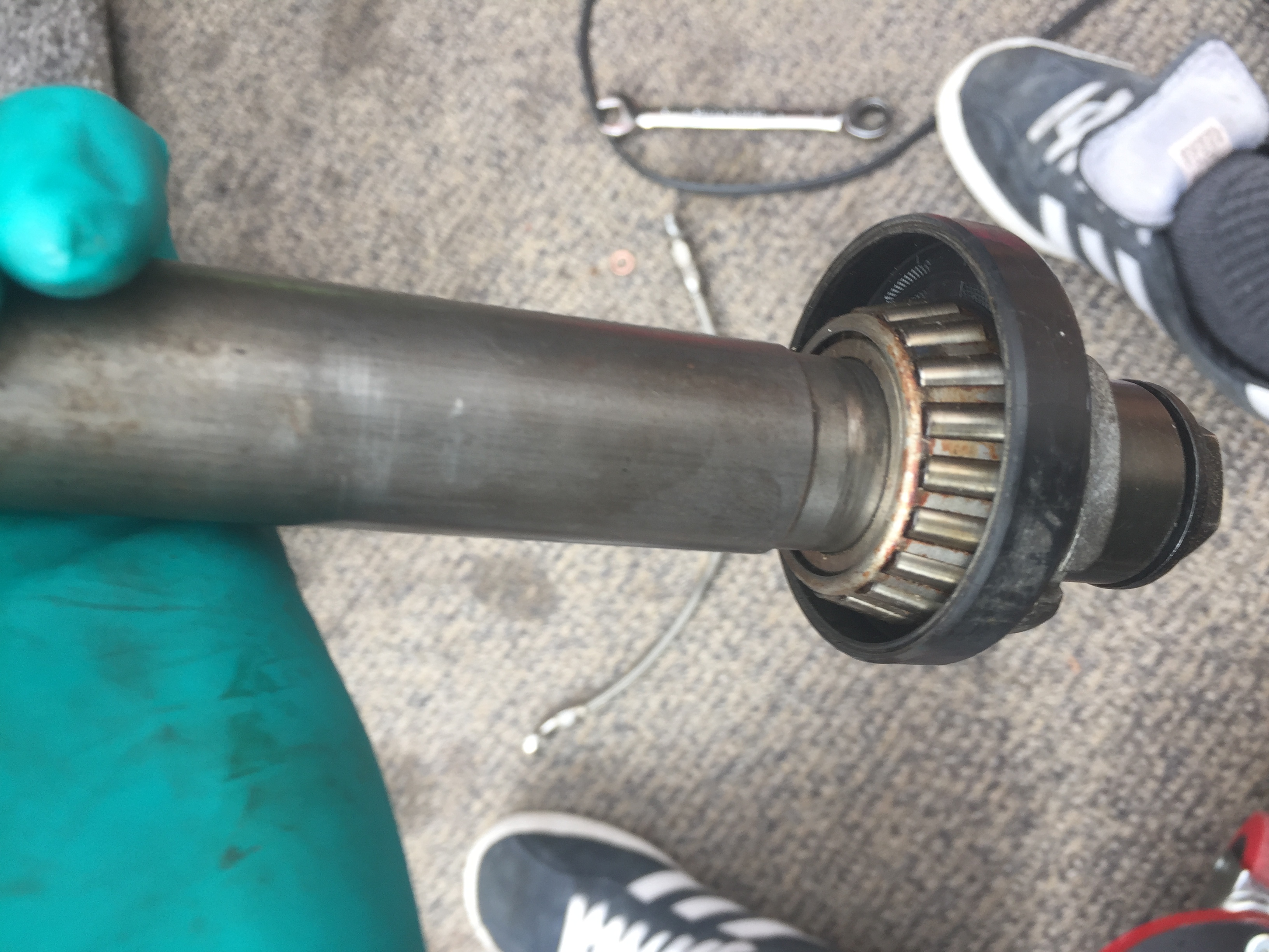

Re: Bits n pieces are a forming
Post by Berti44 » Sun Sep 23, 2018 6:33 pm

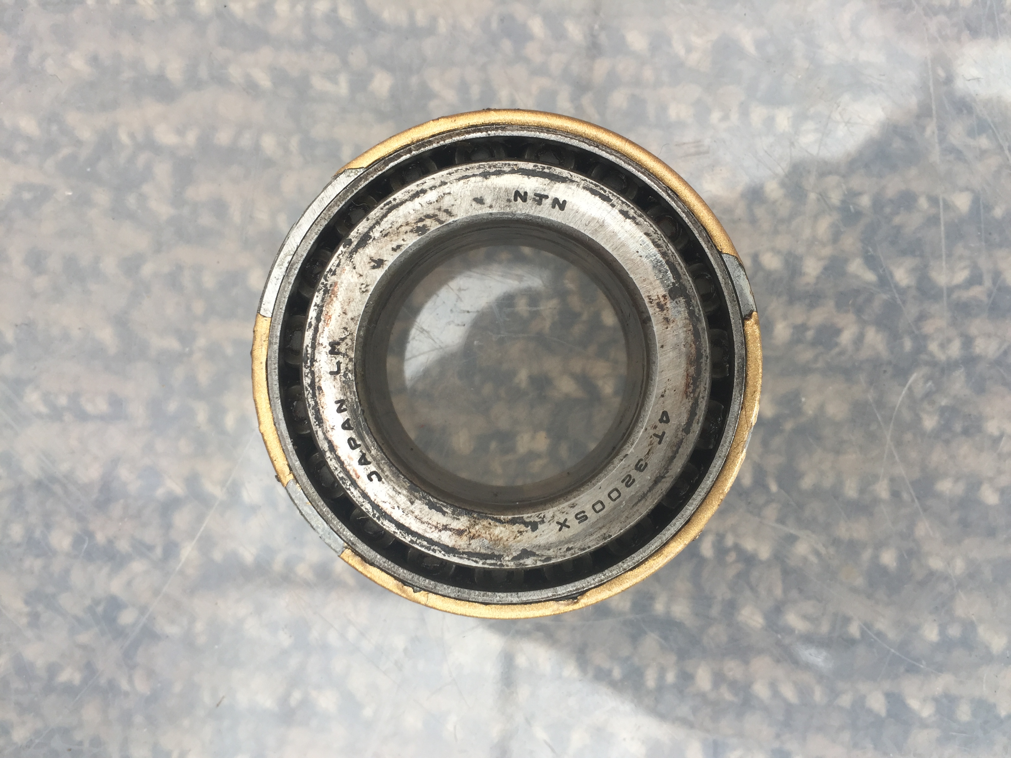

New stem taper roller bearings fitted.

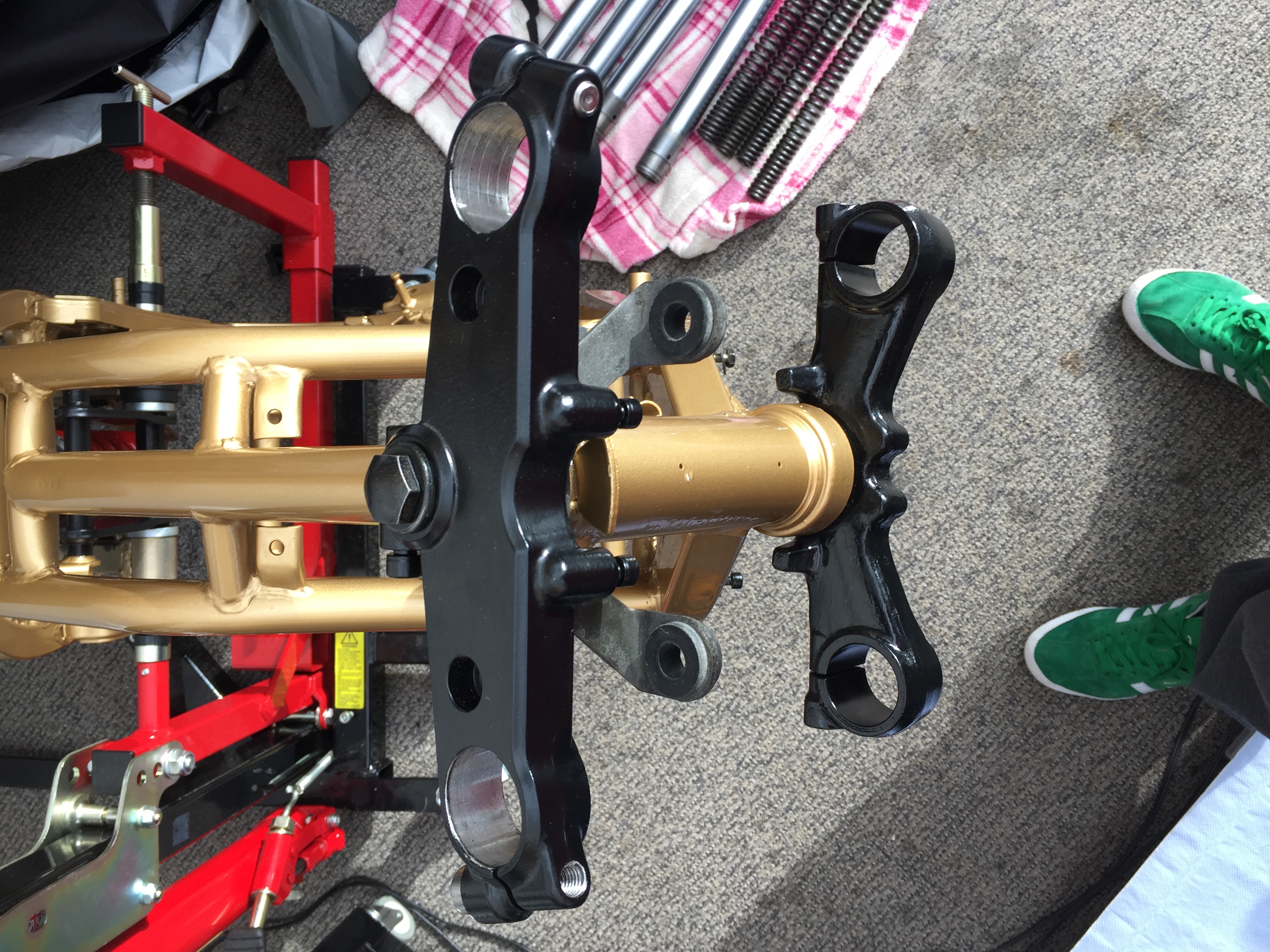

Post by Berti44 » Sun Sep 23, 2018 6:39 pm
Now to rebuild forks. I’ll

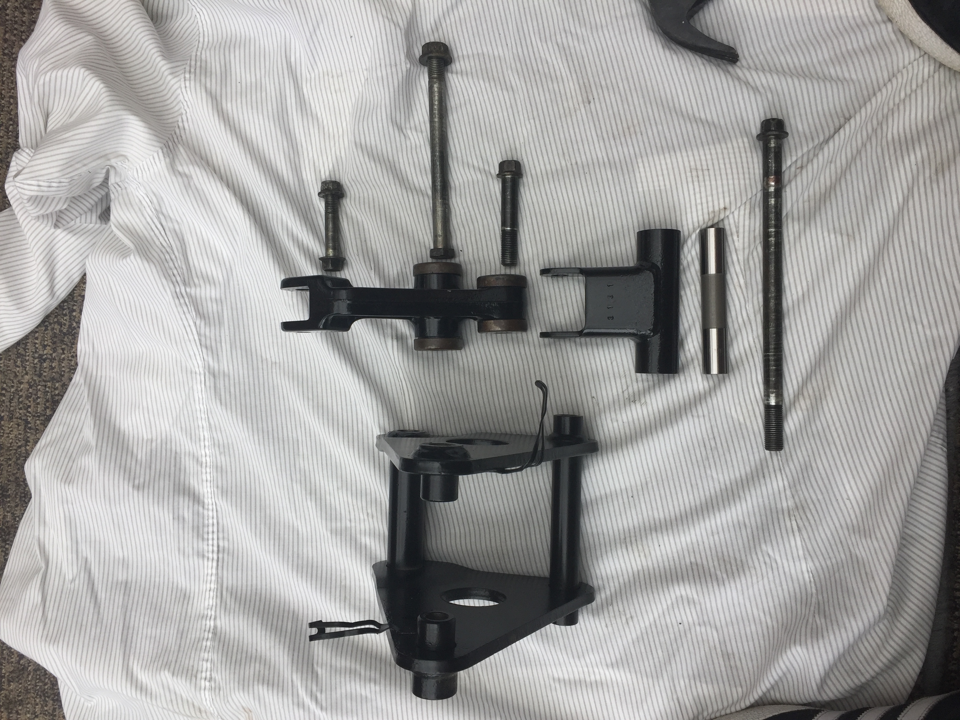

Thanks Kryten for the tip about the airbox invaluable 👍👍
My tip to other folk is to make sure you put the rear brake shaft in/on before fitting the swing arm. Yep my bad 🤦‍♂️

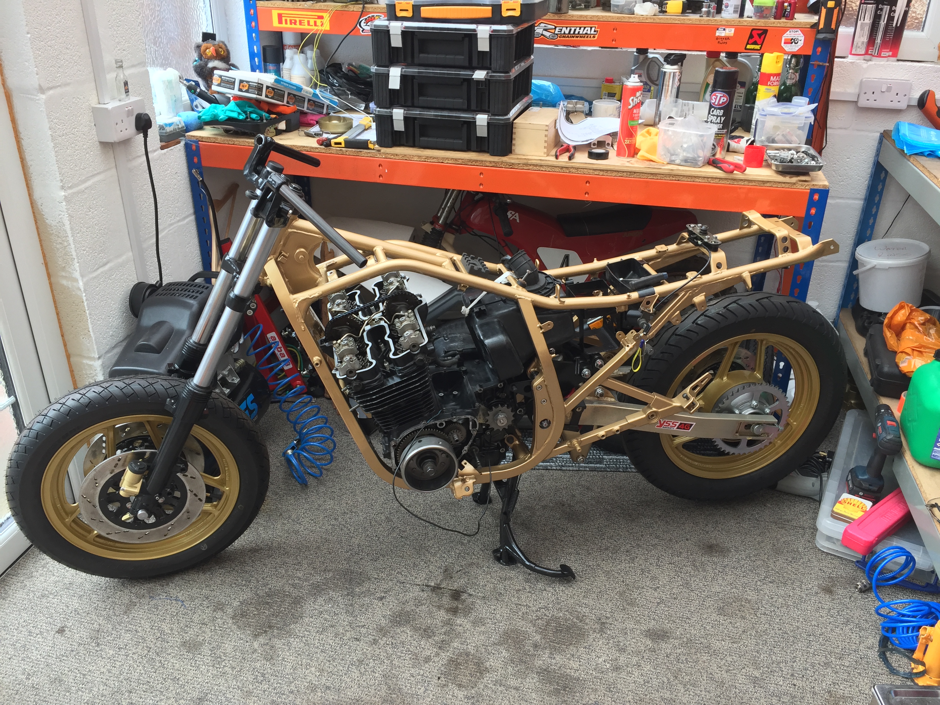

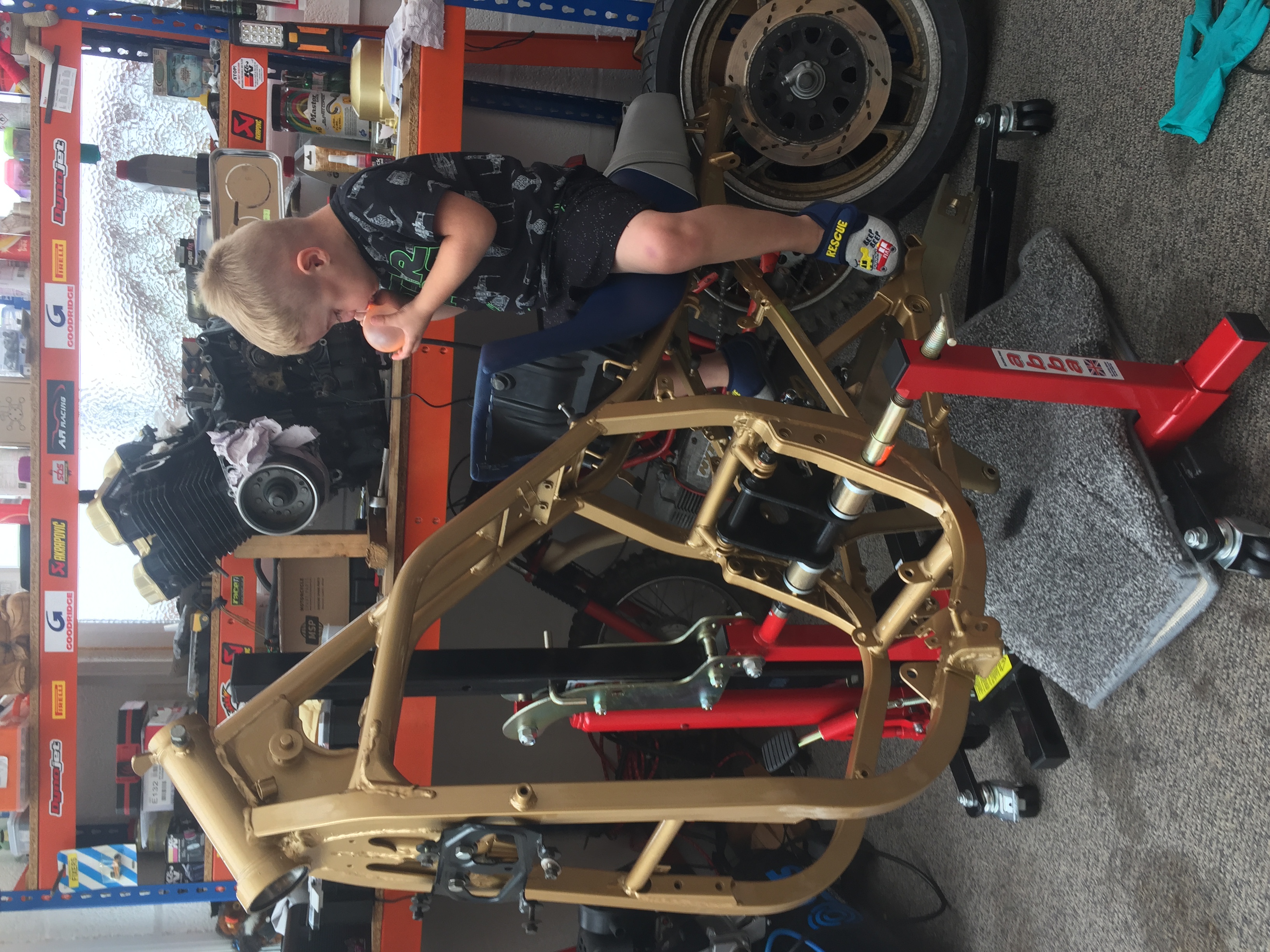

Lockdown progress is steady: this photo was taken before I had to remove the swing arm again. :cry:
