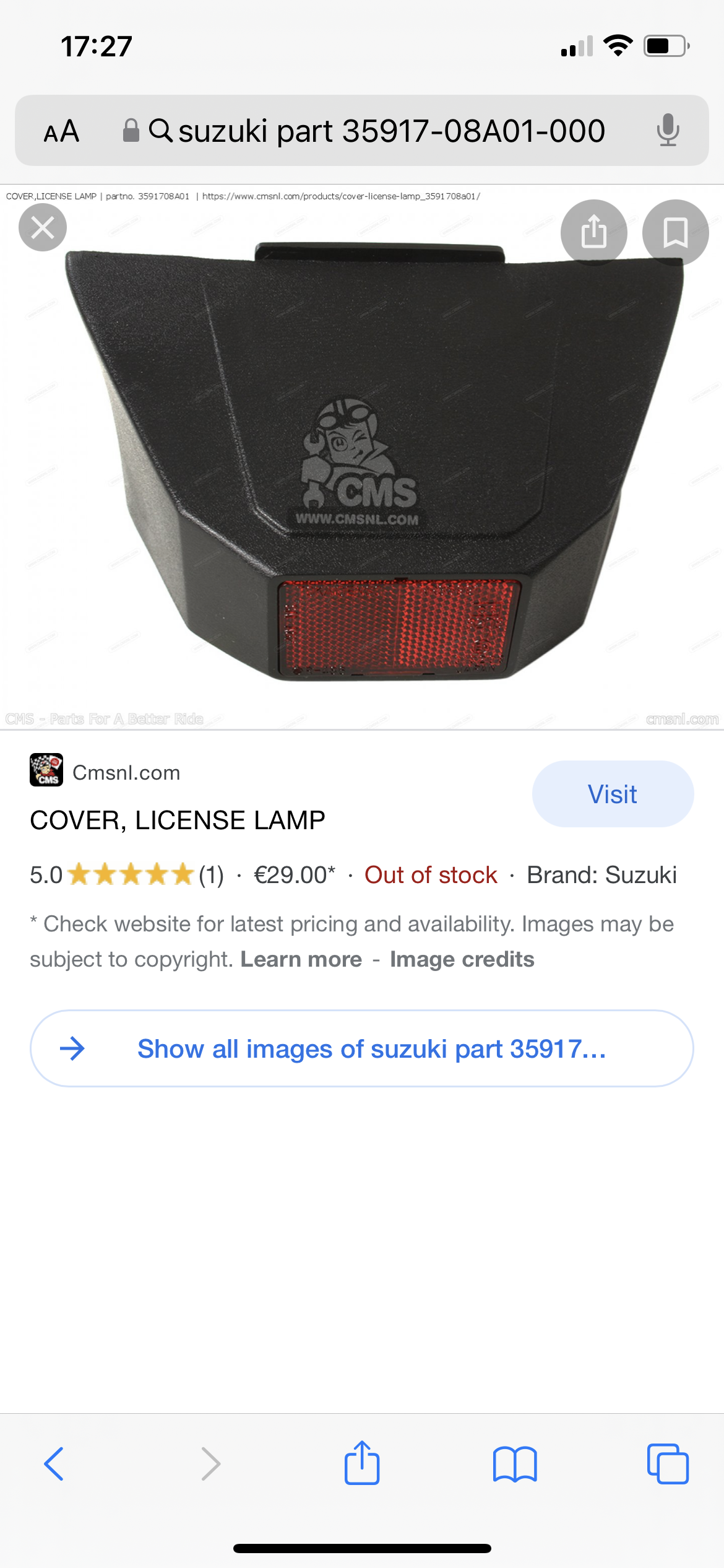

Now the rectifier, electrex RR is the one I need like this photo? Also I’m guessing I just connect wires like for like on the RR?
Whilst on parts sourcing I’m after the ducks arse on over the tail lights so if you know where I can get one let me know.
Cheers 🍻

2ndly the ducks arse ...is a hens tooth :lol: :mrgreen: ;) pretty rare. Best search yahoo Japan or either Australia ...where they will spank you ar*e on prices ...or Canada where there seems to be lot left in barns.
