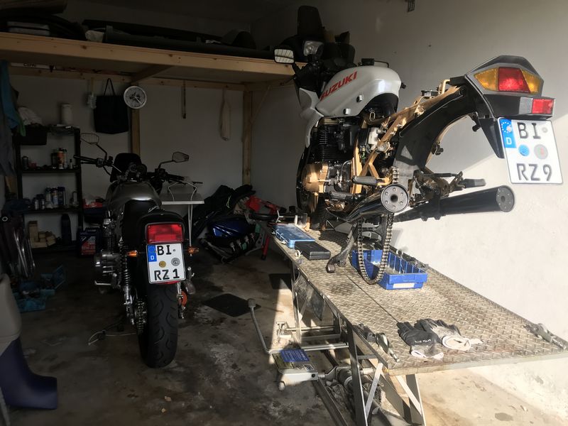

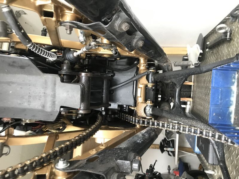

I have started with the disassembly of the old suspension this week. Now the swingarm and some other parts are in my workshop for cleaning and checking ... maybe I will replace some bearing, but we´ll see.

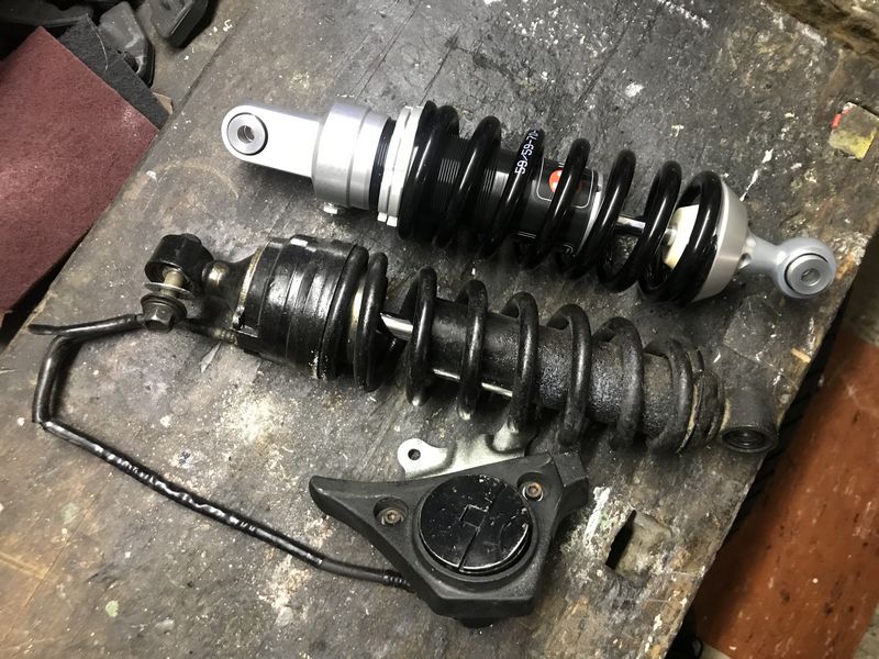

Old vs. New
The adjusting lever will be remounted only for decoration on the bike
Old vs. New

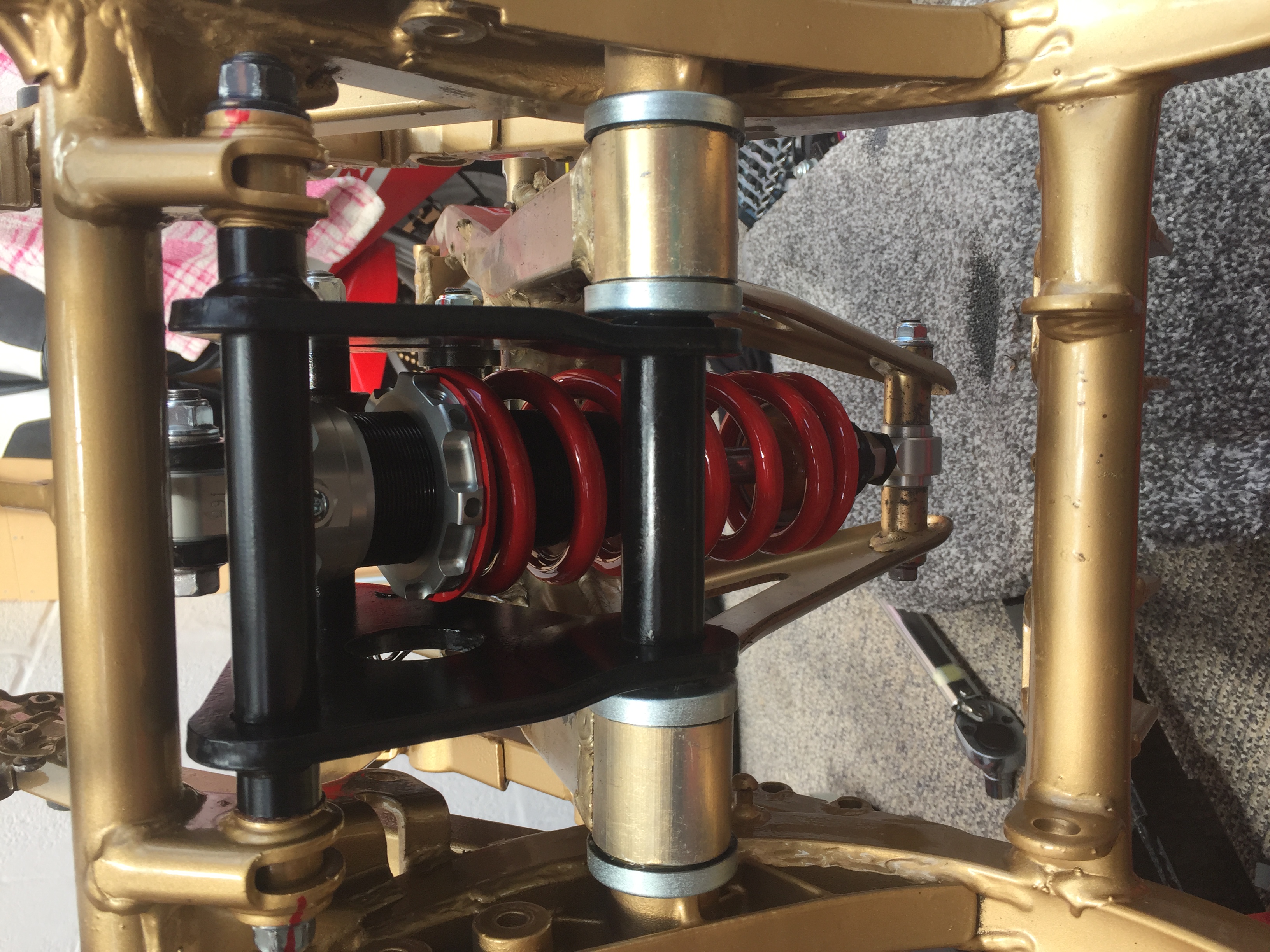

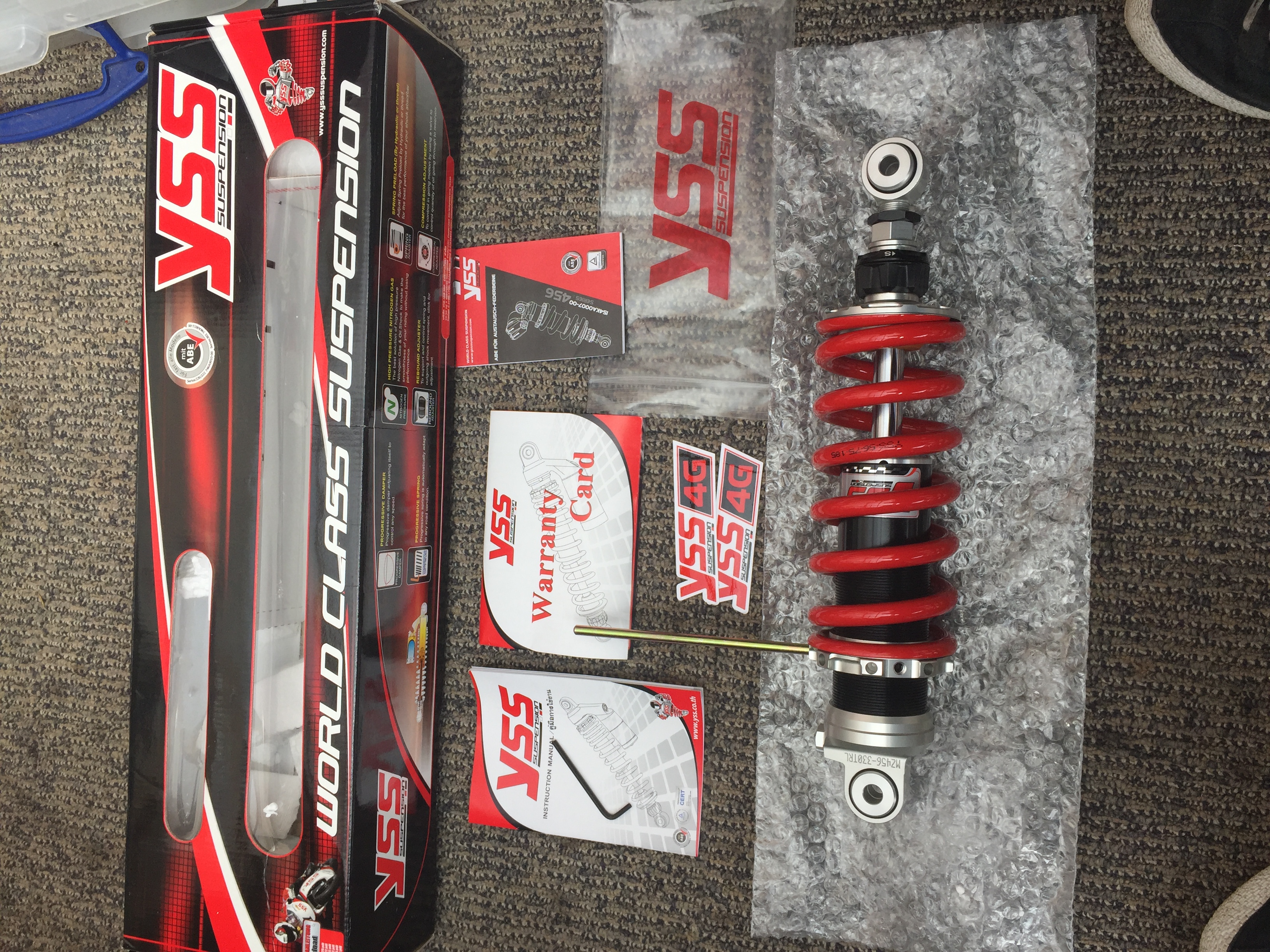

Not much activity on this thread but I’ll add these photos for historical info. Product number shown in photo.
