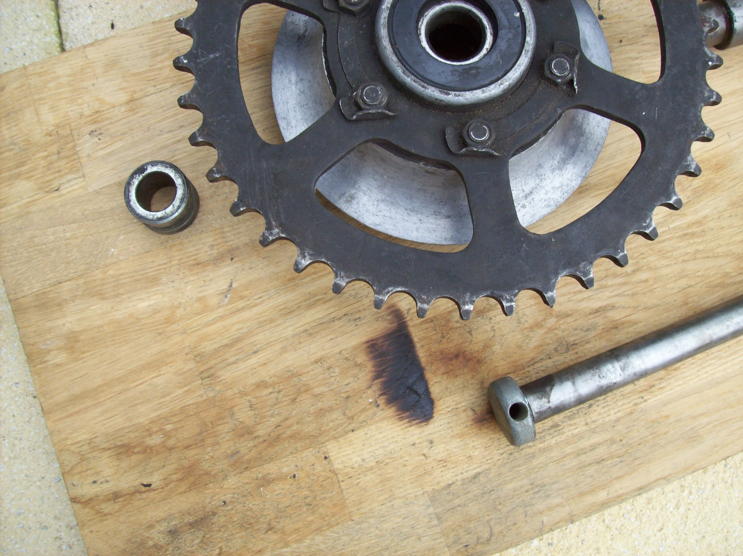

Re: 550MX help wanted

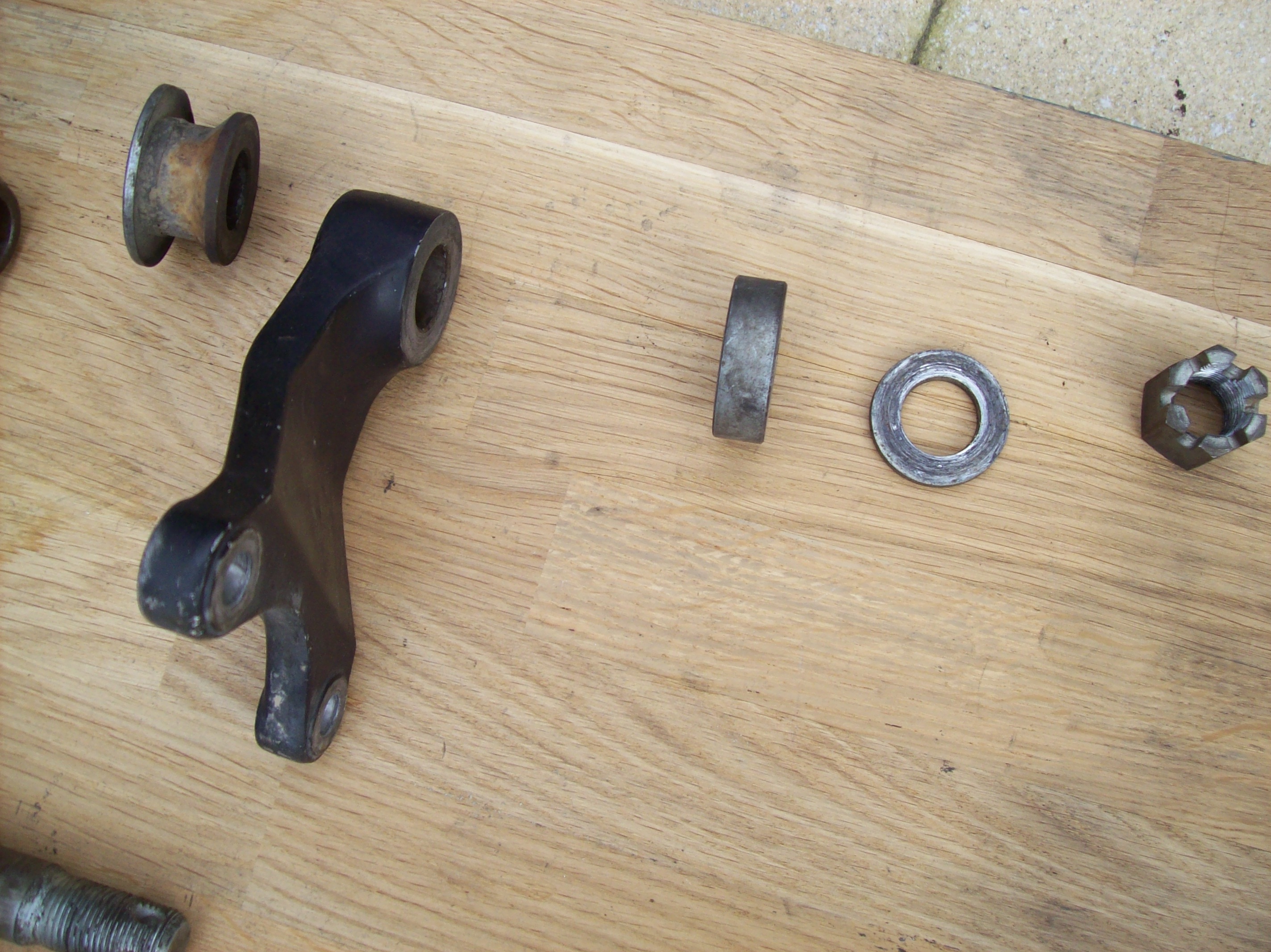

Ok so this is my spare wheel with the components in the right order. The spacer is clearly the wrong size, but I have a few spares

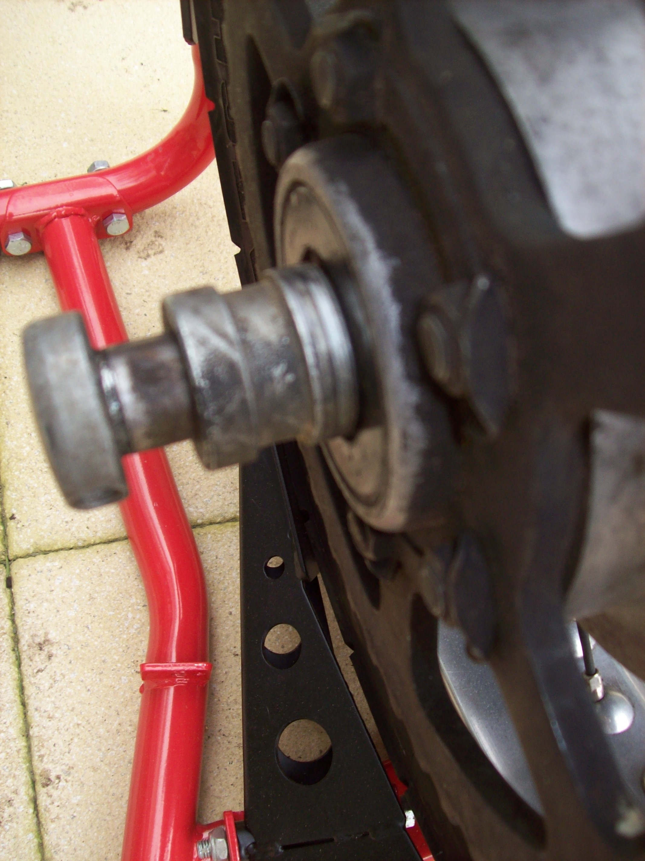

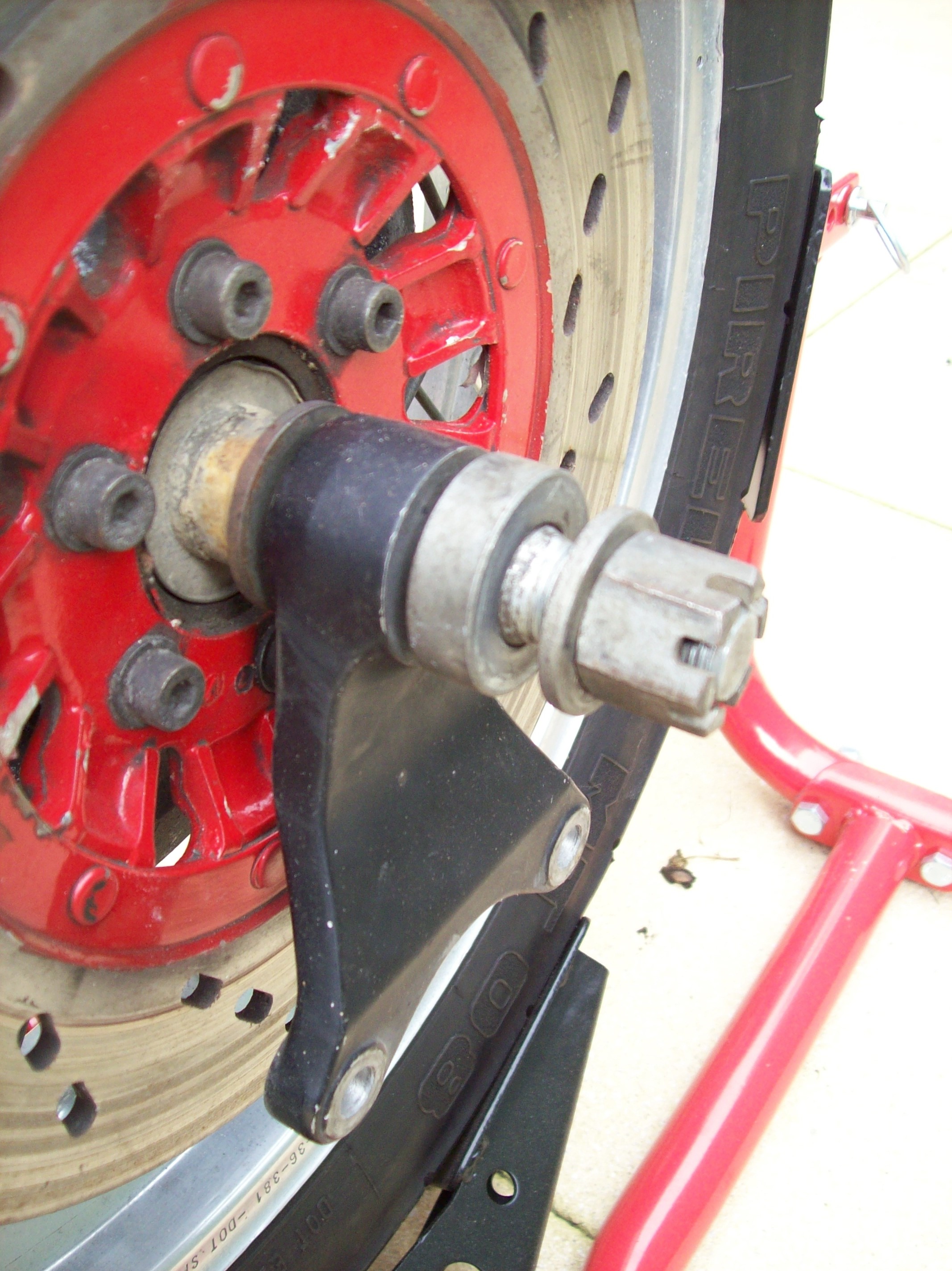

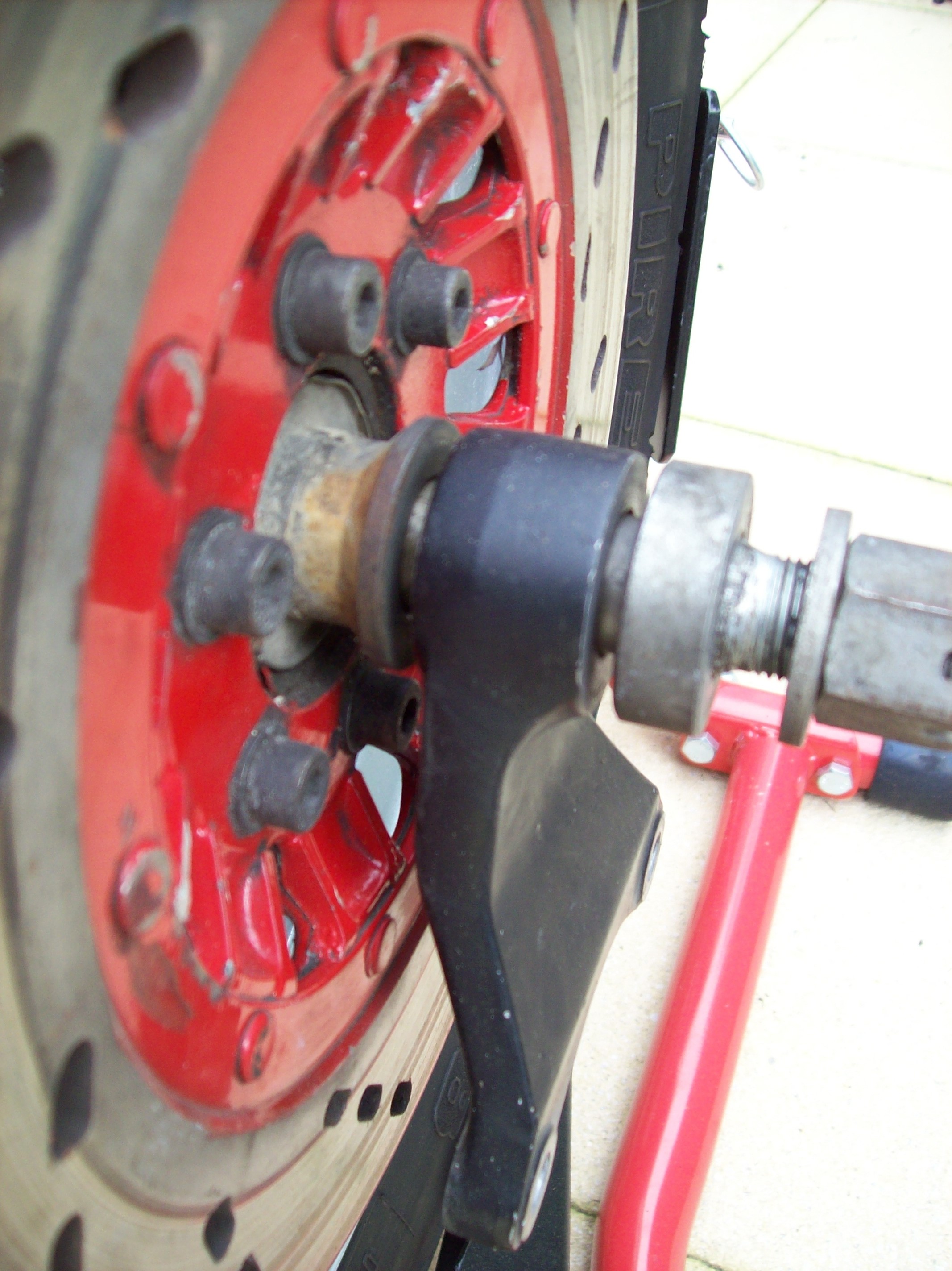

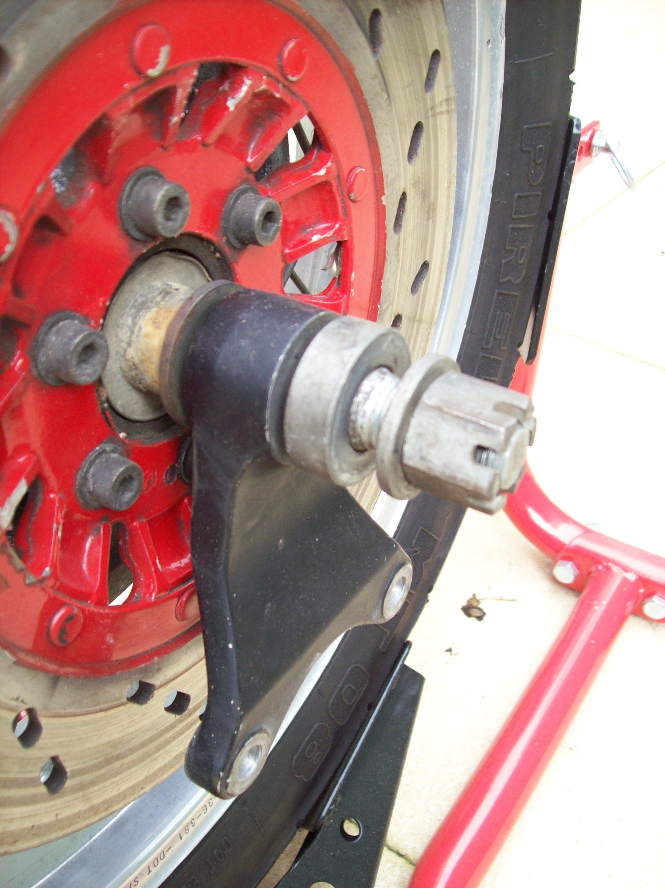

Left hand side

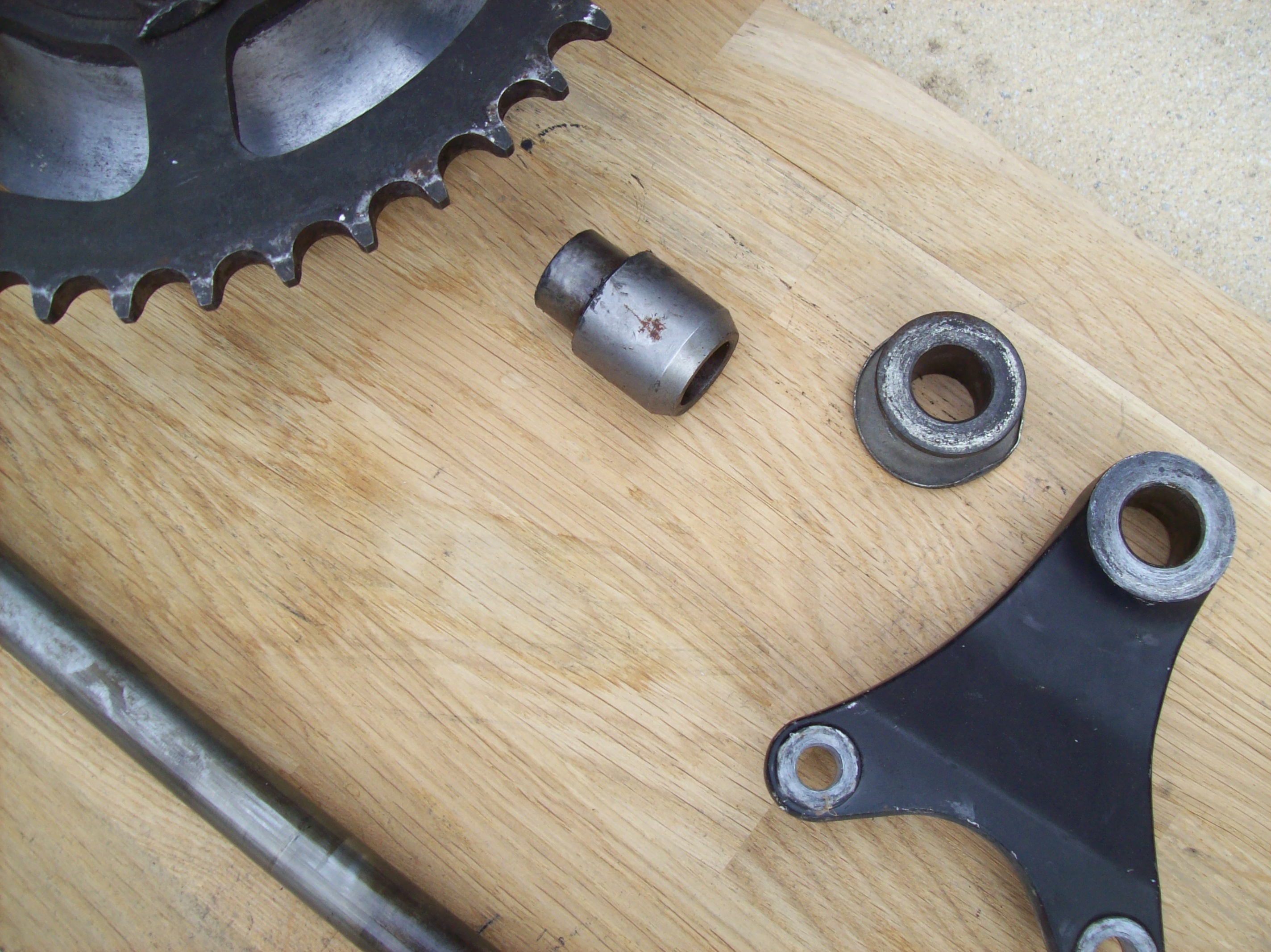

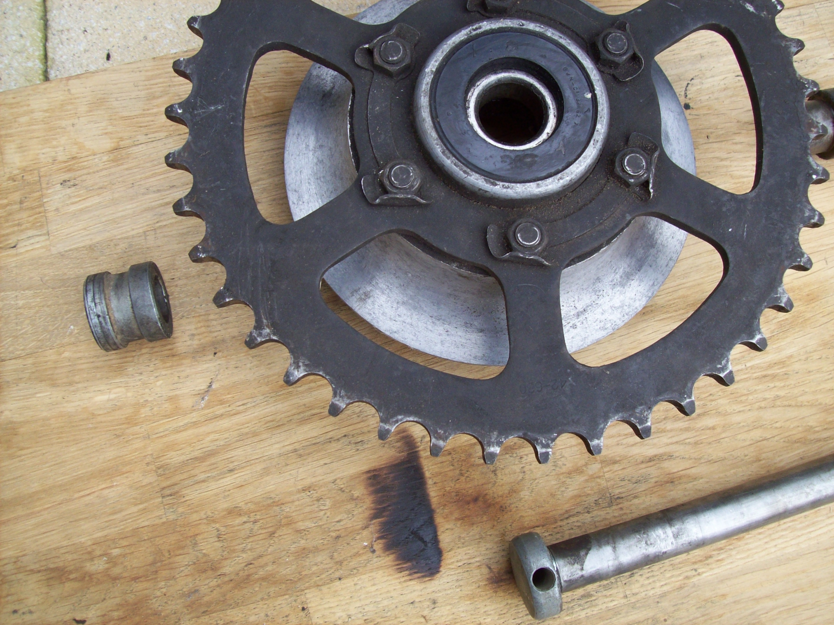

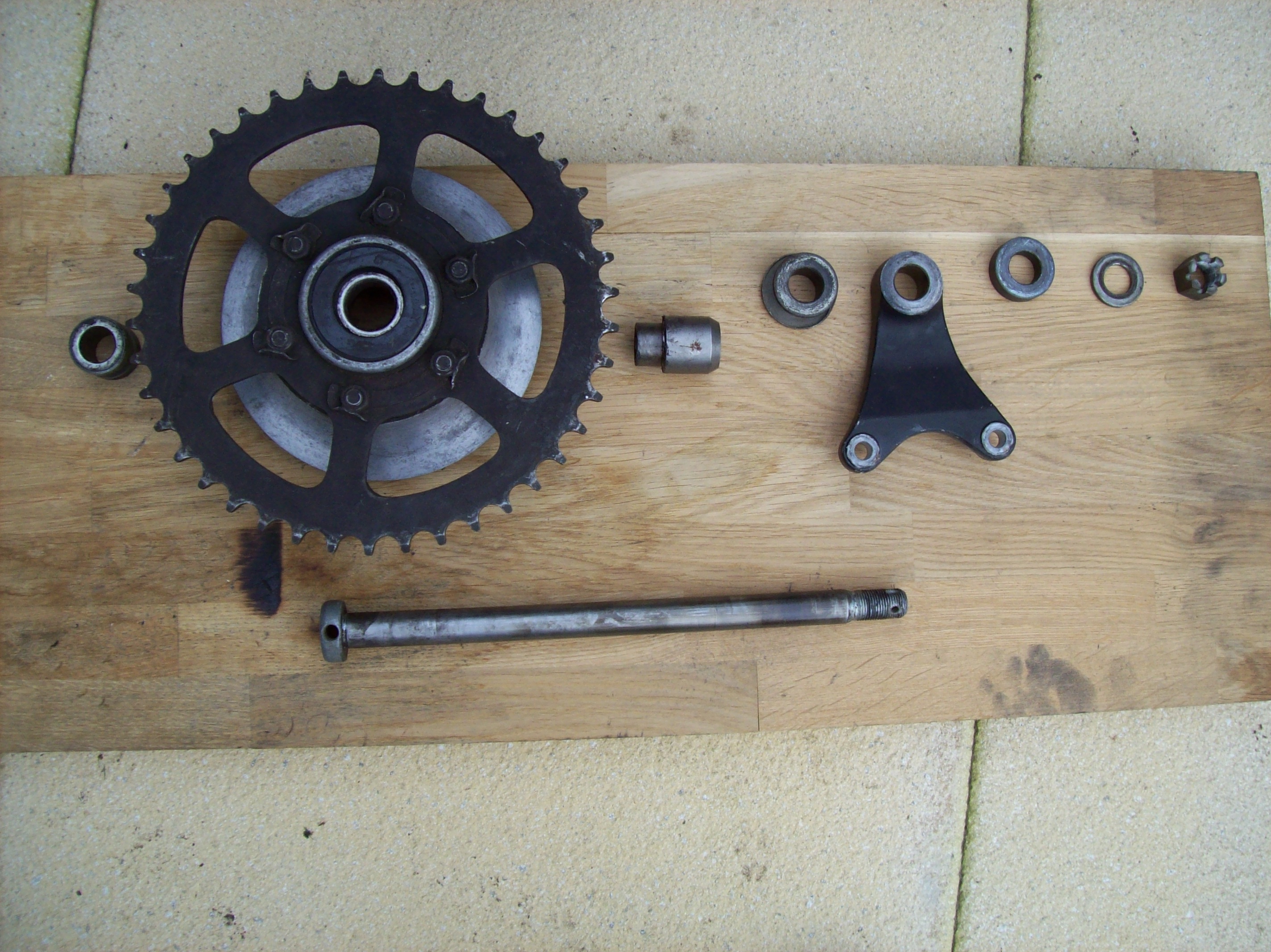

Here are the components laid out in the correct order left to right minus hub and swinging arm
Odd shaped spacer is Number 5 as mentioned in a previous comment by @Blix and @JohnR and sits inside the sprocket carrier and supports the carrier bearing
This thing...
This thing...

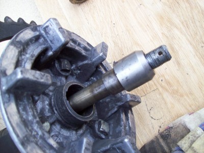

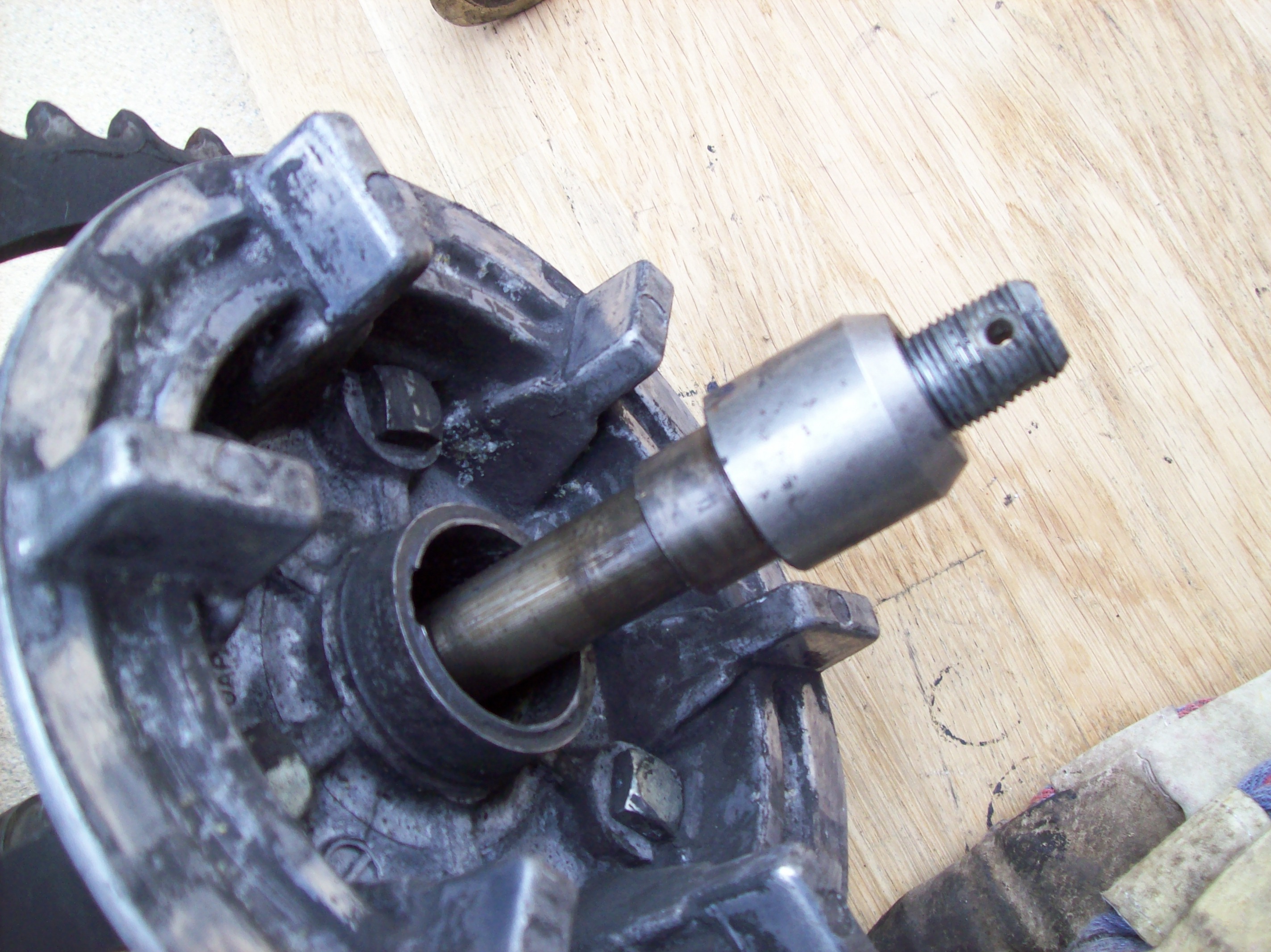

Here it is on the spindle about to be mated (Ooh Err) with the sprocket carrier
